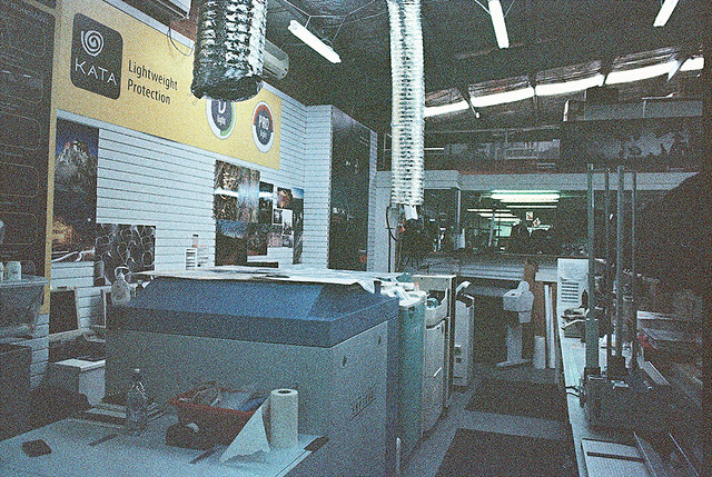

Here is Superia XTRA 800 I put through C-41 at a developing time of 6 minutes, exposed at EI 12800 (4 stops, not 1)
Superia 800 @ 12800 no preflash by athiril, on Flickr
Here is the same roll, also at EI 12800, but with a pre-flash added before exposure of the main scene, everything improves, significantly.
Superia 800 @ 12800 Zone 3 preflash by athiril, on Flickr
The way I did my pre-flash was a double exposure. I determined the pre-flash amount, then held a tissue tight over the front of the lens and shot that for a uniform fogging/pre-flash, and the actual exposure on the double exposure.
There are other ways to go about the same thing, such as loading the camera, and drawing a square on the first frame through the lens mount with the shutter open, then pre-flashing the whole roll, rewinding and reloading and making sure that square lines up as the first frame etc.
You'll need to determine your pre-flash amount as well.
Here is the same scene again at EI 12800, with a preflash, but the preflash was 1 stop less than the one I used above with success
Superia 800 @ 12800 Zone 2 preflash by athiril, on Flickr
You'll need to 'waste' a roll to test it, rate the film at your desired speed (be it 800 or 1600 etc), and shoot the same scene at that speed but with bracketed pre-flashes added to it and see which pre-flash with the least exposure suddenly improves the image. The other way it's normally done is shooting only the pre-flash and push-processing to your desired developing time, and see which pre-flash exposure is just visible on the frame (the one before it should look like no exposure at all etc).
