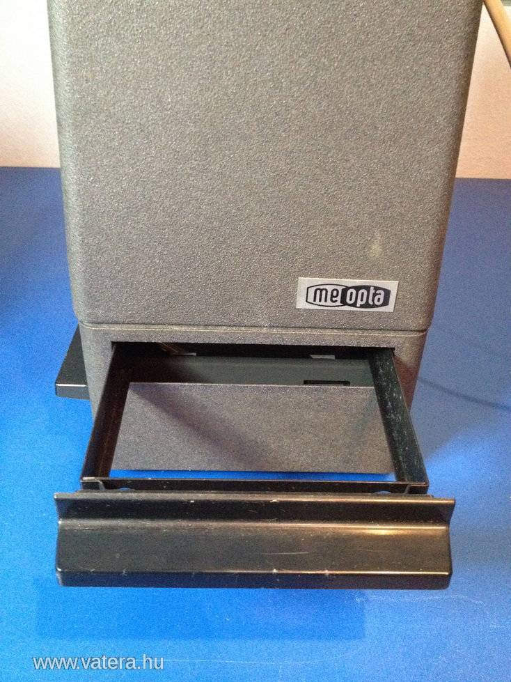

I'm thinking of buying either a Krokus 44 MAT Color or a Meopta Axomat 4 both under €15. Neither of them seem to have knobs for filter adjustment.. Anyone has any experience with either of them?

An "Axomat 4" is not a colour enlarger, but an "Axomat 4 Colour" looks like it has a different (more horizontal than vertical) head on it. A google image search shows they seem to have wheels on the front; make sure those are present when you buy, and preferably test the enlarger by turning it on and watching the colour change when you adjust the wheels.

The Axomat 4 has a tray for filters so I guess I can put filters in it and use it as a color enlarger.

I'm pretty sure you will find it harder to get a set of colour-printing filters than a colour enlarger. And you will probably pay more for them than a colour enlarger. And while they might work, they don't give you adjustments as fine as the knobs on colour enlarger (2 points matters!), and they're way more hassle than turning a knob.
The final insult is that gel filters (that go in the drawer) will fade over time and with use because they are merely dyes in a resin. In comparison, dichroic filters in a colour enlarger will never fade because they use metallic coatings on glass to achieve the filtering effect. A dichroic filter's effect is based on destructive interference of internal reflections in the coating layer - just like an anti-reflective coating, but of a thickness chosen to give strong attenuation of transmitted light at particular wavelengths.
Buy a real colour enlarger and don't make life unnecessarily difficult for yourself. It won't cost any more and it will save you grief and time.
