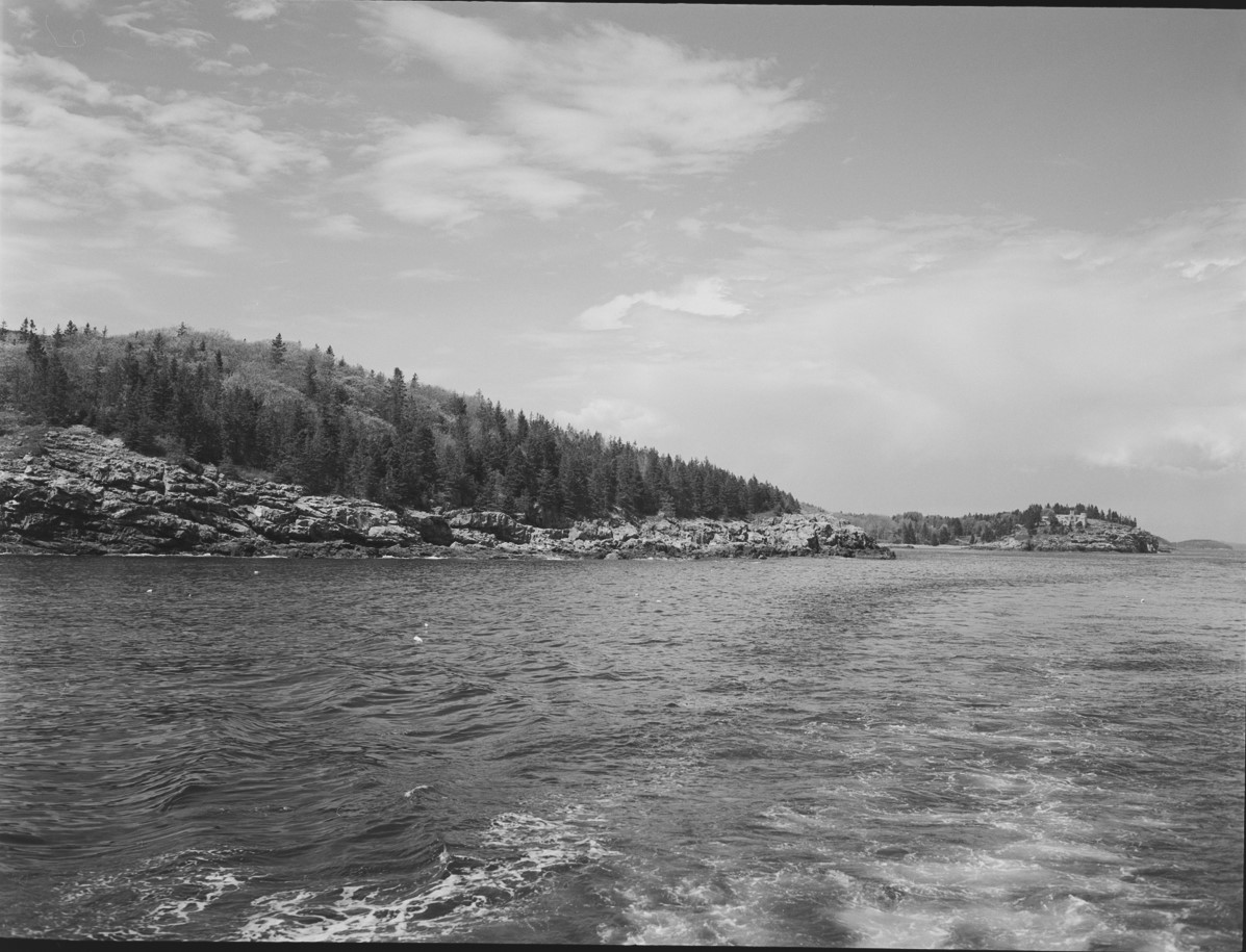

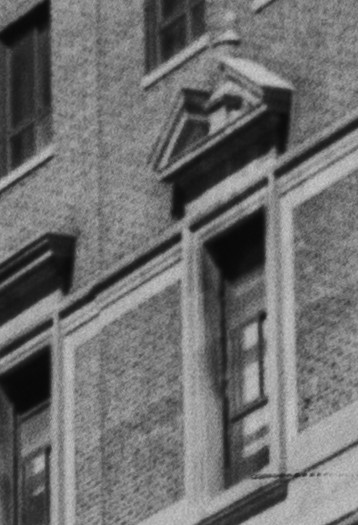

Hi all,
A couple of weeks ago, I got a GS645S off of eBay for quite a good price thanks to the fact that it has the apparently-common "slow rangefinder" issue. That seems like something I might be capable of fixing myself if I feel the need (if anyone else has done it, I'd be thrilled to hear about your experience).
I just took it on vacation with me, which was sort of a bonus since I hadn't expected it to arrive before I left. I shot two test rolls before going, one on Delta 100 and one on Catlabs 80. The Delta 100 roll seemed mostly fine, but the Catlabs showed the camera focusing just a hair past infinity, suggesting I should dial back focus a smidge for landscapes. That's what I did on my trip, and while I'm waiting for the two rolls of color to be processed, I just looked through the one roll of B&W (also Delta 100) I shot and got an odd surprise; many of the shots exhibit softness on the right side, while others don't.

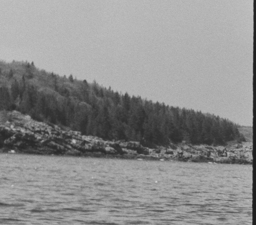

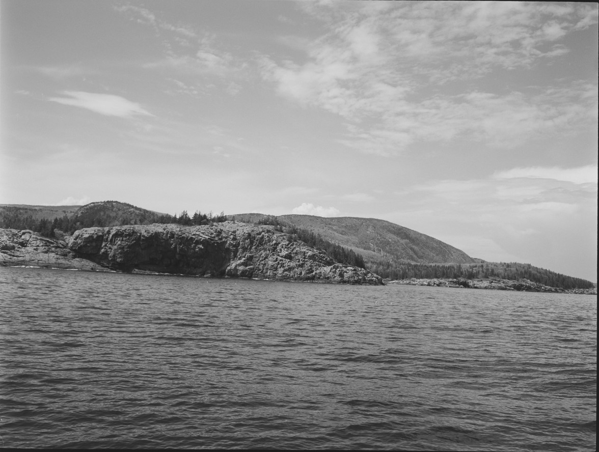

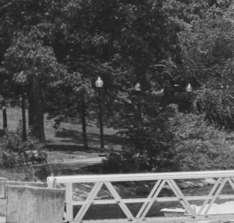

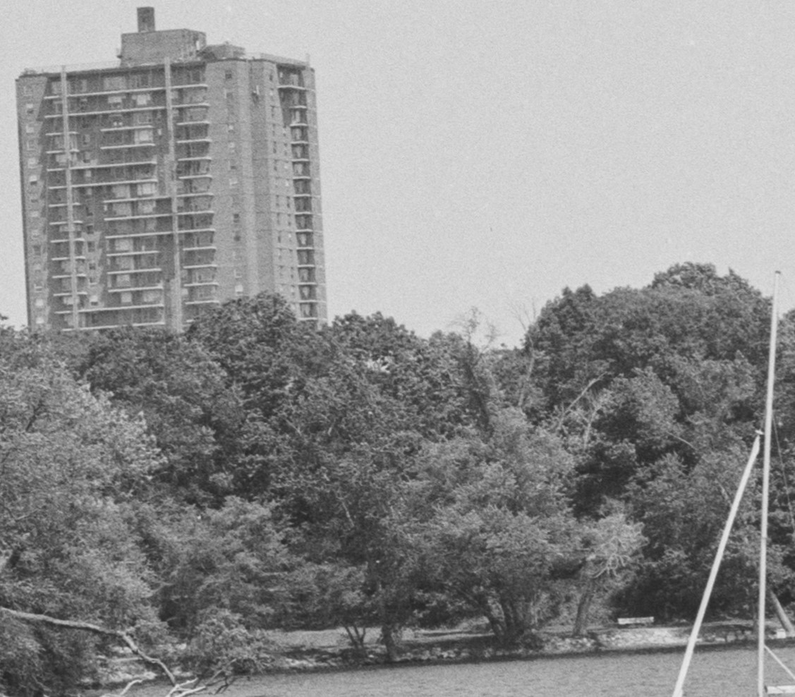

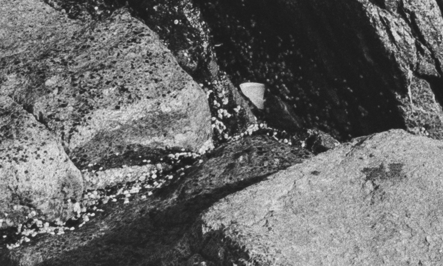

Here's a "bad" example (all of the shots on this roll are pretty boring to boot):
A crop from the "good" right side:
And from the left:

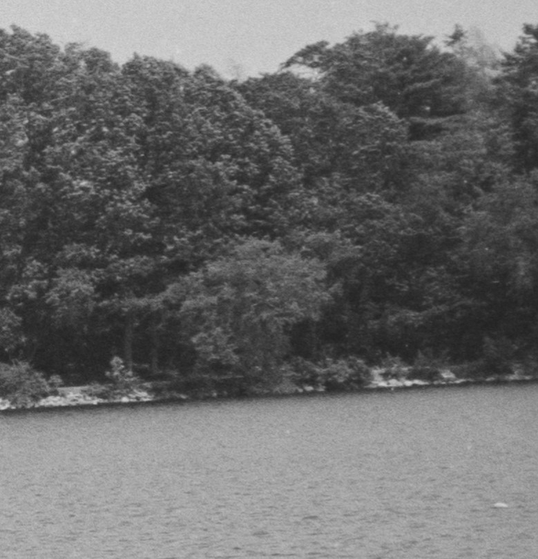

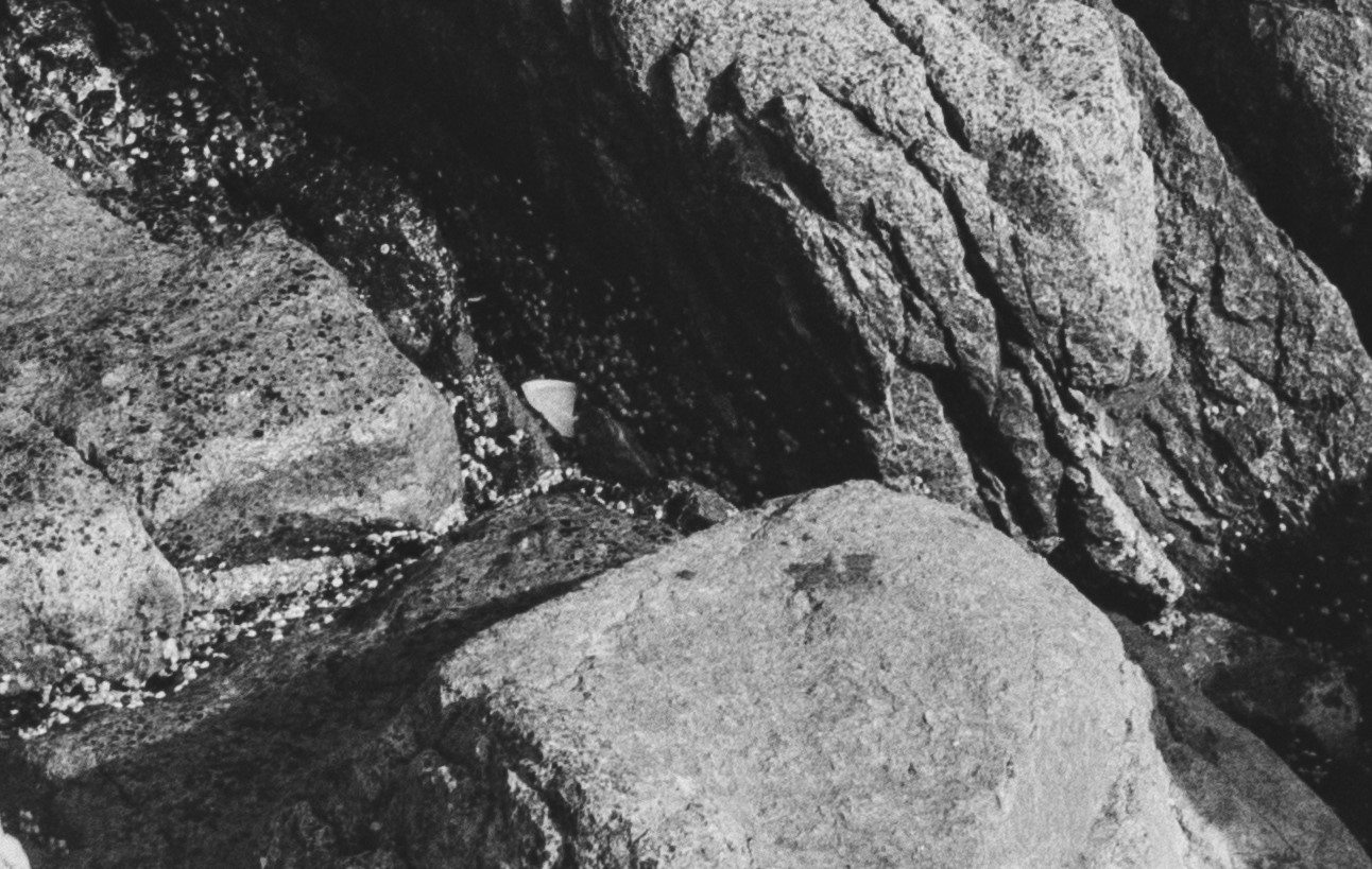

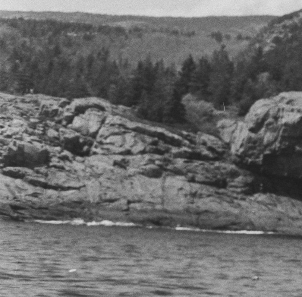

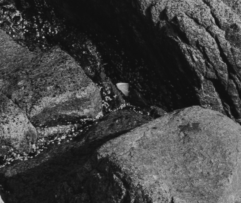

And here's an image without the same issues:
Right side:
Left side:
Weird, right? Both were at f/11, and both were focused at the same point (the dot just before the infinity symbol) - at least as far as I can remember. There's no wobble to the lens at all, which is the first thing that'd come to mind with an issue like this that's sometimes there and sometimes not. So...maybe the pressure plate? It crossed my mind that the Catlabs film showed the past-infinity problem because of some sketchy backing paper the maker might have used, and that I perhaps shouldn't have dialed back focus the whole time. The pressure plate was set to the 120 notch, so everything was working as intended, and I can't see any unevenness to it, but who knows. I'm out of 120 film to test it at the moment.
Anyway, if anybody has a bit of insight, I'd appreciate it!
  • The pics you show, overall, do not have the "bite" I would expect from one of these Fujica 645. Based on my experience with (admittedly different) GS645W. Such softness might as well be caused by the contraption (That Shall Not Be Named Here) used to convey your FILM images to my screen.
  • Shutter speed? At least one pic seems to have been taken from a boat. Experiment with tripod.
  • You need to determine whether the rangefinder is wrong, or the distance scale on the barrel (or both). This might help:
    http://rick_oleson.tripod.com/index-123.html
Not clear what you mean, barring a test on an optical bench with a precision collimator. Do you mean you focus a point at "infinity" with the RF, then look at the distance scale? Then all you can say is they disagree, not which one is wrong. To answer that question, you need to look at what is happening in the film plane, either through a properly planned series of test shots, or using the trick of Rick Oleson (see above). Plus, film plane is defined by the rails, not by the pressure plate; so i don't see how the backing paper of Catlabs film could affect focusing.
I would start with some careful measurements of the lens to the film plane or camera body, lens support rigidity, and focusing track smoothness.
The two 100% crops from the 'good' shot do match up pretty expectedly vs. border quality of examples I've pored through Flickr for. And the center sharpness is pretty great. More on this in a bit.

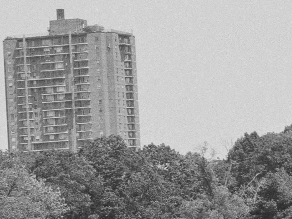

Here's the reason I was curious about the Catlabs film:
1. Center crop Delta 100, focused at infinity, f/5.6:
2. Center crop Catlabs, focused at infinity, f/5.6:
3. Center crop Catlabs, focused at the 'pre-infinity dot,' f/5.6:
Interestingly, the Catlabs film seems a bit...warped, with a decidedly non-flat surface. It's obviously not extremely easy to represent that in a photo, but this does a decent job:
So maybe it wasn't the backing paper after all but a flaw in the film itself. Either way, I based my "infinity" focusing on that test roll for this trip, which I probably shouldn't have done! My hope is that my focus point was actually short of the hyperfocal distance and that's what led to the sharpness issues. Obviously, more testing is needed.

Well, I bought a few rolls of Arista 100 just to test it out. First one had some interesting results (even though I utterly botched processing it by initially putting in a 35mm-appropriate amount of developer solution). I know everyone has been extremely eager to hear about them!
- Clearly there was something wrong with that Catlabs film, as infinity focus looks fine.
- The 3 C41 rolls I'm waiting for from the lab are going to be extremely depressing, since based on the Catlabs experience I shot all of my landscapes at the 'dot' before the infinity sign. That might be a fine hyperfocal distance for medium-sized prints, but border softness would be visible at 20x30.
- That "decentering" doesn't exist at infinity - just on distant subjects when focus is as far back as that dot. I should do some brick wall tests to see if it would ever have any real effect on anything.
- I don't like the camera very much, sadly. Turning the camera vertically for horizontal shots is more annoying than I expected. It's a shame, since there isn't much else out there that'll give me 120 IQ in such a small package (and not cost as much as my car). Perhaps I'll keep plugging away at learning to focus my TLR.
- The rangefinder generally seems accurate, despite needing to be re-lubed.
- The imprinting on the Arista film's borders bleeds into the frame way too easily. Super relevant, I know.

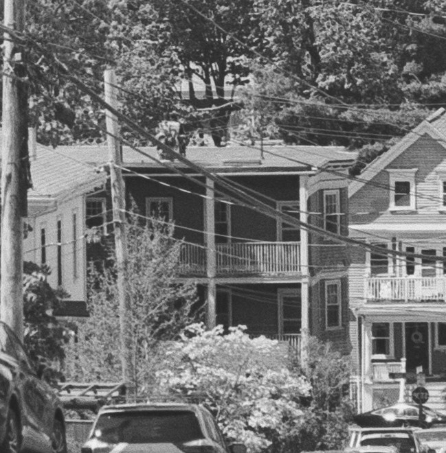

Here's a shot at infinity, f/5.6 (original dimensions approx 6600x5000):
Centerish crop:
Left side:
Right Side:
More testing is needed but I'm at least fairly confident that there's nothing terribly wrong with the camera.

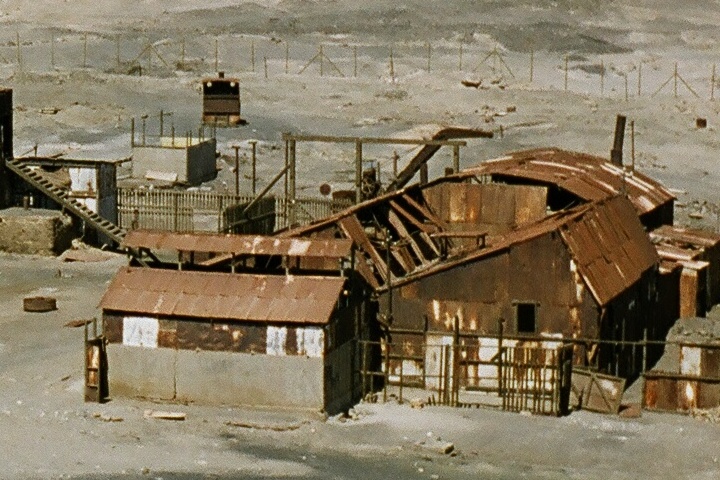

To document my statement about the image quality that a Fuji 645 camera can deliver. Fujica GS645W. Reala 100. Tripod. Commercial photo store dev+s**n (Noritsu). Location: Humberstone nitrate plant, north of Chile.

Actually, I'm not so sure about that. Even at f/11, hyperfocal distance on this camera should be a bit over 7m. The last marked distance on the scale on this camera is 5m, so it's tough to know exactly where I focused on the 'bad' shots. Almost definitely shorter than hyperfocal for f/8 and under. That's also coupled with the fact that I'm rarely satisfied with infinity sharpness at calculated 'hyperfocal' distances when pixel-peeping.
And there is no reason why it should be more apparent at the edges than at the center (except if the optics has field curvature).
Yep, that was my main concern, and I'll need to do more testing to figure it out. I'm sure the lens does have some field curvature, but how much, I don't know. I think that one side being weaker than the other definitely indicates a centering/alignment issue, but once I'm even sure that one side is sharper than the other in those situations, I'll then want to make sure the issue is actually relevant to real shooting.

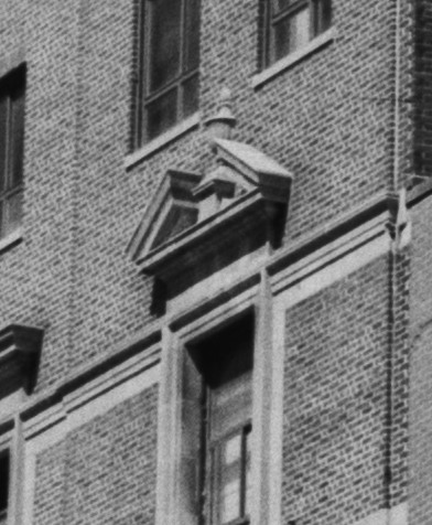

For what it's worth, here's a stitched-scan shot that was focused well, and a center crop:
Personally, I'm happy enough with that!
