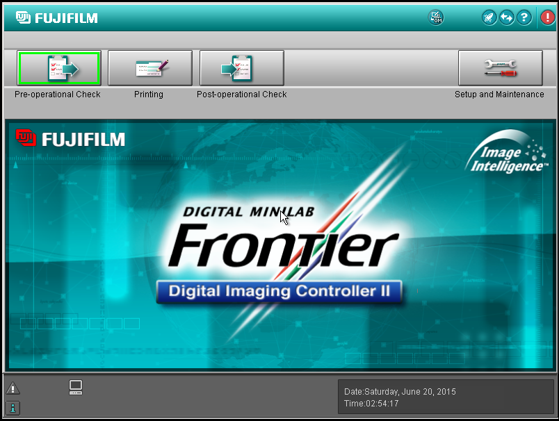

When I turn on the scanner (after the server is on), I get a error message "This device is started up in the stand-alone mode. To connect to the server, select 'Start connection to the imaging control' in the 'setup and maintenance' screen" (not an option listed). After I scan the pictures and submit an order, the order makes it to the server, but I get a "media not recognized" error.

As I understand, you can either run this thing in standalone mode, or networked. There appear to be several software options and I suspect they differ in the configuration options they allow. My first impulse would be to try and run it standalone before/instead of complicating matters with a network.
This suggests that the Frontier application on the scanning machine may not have the correct settings to connect with the server. I see you can successfully ping both machines from either direction, so your network as such works. However, at the application layer, things may not be properly configured. For instance, it may (will) be necessary to set the server's IP address on the scanning machine so it starts connecting with the proper address. Alternatively, if you use host name resolution, keep in mind that on a network with just two Windows machines hostname resolution may fail due to an NDS problem (main, lack of any). It may work to hardcode the server's hostname & IP address in the scanner's 'hosts' file.

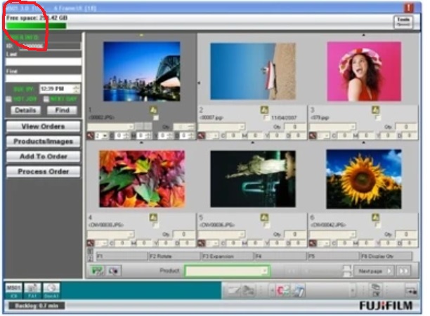

This image isn't great (internet screen shot) but if you look in the top right corner you should see the software version (marked in red).

Got the two machines working!! That forum recommending using 7777 as the password gave the option to enable connecting to the server. Then, after fiddling with the computer not recognizing my USB drive, I got some pictures off!

The software running on my computers doesn't look like that much. I did a quick look around, maybe its FE software/I see the term EZMain around? Looks like this
It doesn't have many options (like the shadow hardness, stuff like that too), no optional software listed either. Changing to MS01 + MS11 with the various optional stuff would be great (have to find the software, back up whats there, etc.)
