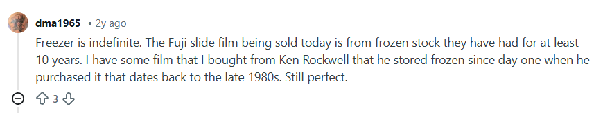

This is interesting . . .
These rumors have been around for so long that I've become convinced that they're kept deep-frozen and thawed in batches to be released periodically to the general public.
Also, film DOES deteriorate when frozen. The rate at which depends, but it's true for slide film as well as for any other kind of film. Cosmic radiation is everywhere, also in a freezer. There's no remedy. A freezer will slow down chemical deterioration, which is generally a faster effect at room temperature. That's why cooling/freezing does help - but it's not an absolute remedy.

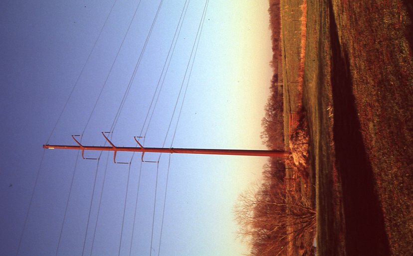

OK. . . . NO CLIP TESTS, NO PUSH ME PULLYAi SPOOLED UP A COUPLE OF ROLLS AND SHOT THEM SROUND THE HOMESTEAD AT BOX SPEED. . ZMINOLTA x-370 WITH 50 MM F3.5 MACRO (niCE LENS.PROCESSED e6 BYmEMPHIS FIM LAB IN ohIOSOME OF THESE ARE FROM A OLD ROLL OF VELVIA THAT WAS JUSTLAYING AROUND
Well, that's different from the frozen film of the original topic and looks like it's lost some film speed and developed a bit of red cast typical of expired Velvia, also seems like the metering was not very accurate as the shots of the tree bark are overexposed while the others are mostly underexposed. The exposure on the mailbox is probably the most accurate, though you see a red cast in the shadows there too.
