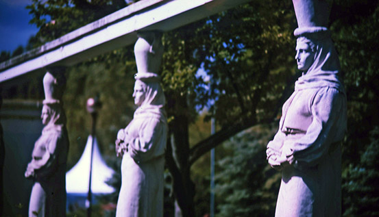

Fuji positive color in color reversible process.

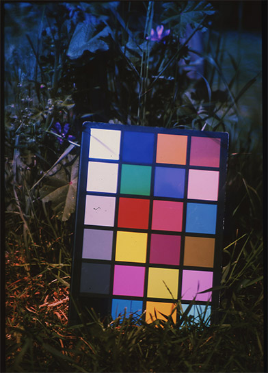

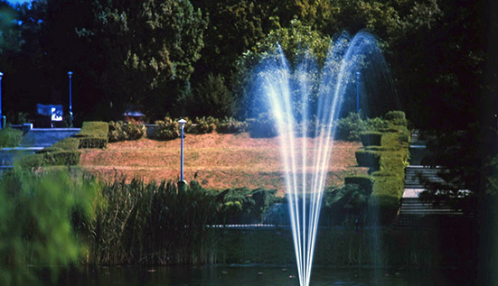

I made some reversible samples with Fuji color positive film.
In addition to producing color slides on the positive color, I found that some effects can also be achieved on this film.
Effect of American night and contre-jour:
The night American effect is obtained when the color temperature of the son is over 5500 K.
The image becomes dark blue.
Because the exposure of the Fuji color positive requires a lot of light (1/15 and aperture 1.4), I thought to take a picture of the sun directly.
Look what went out.

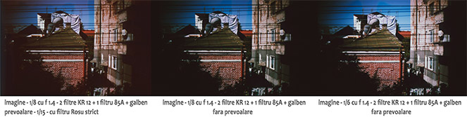

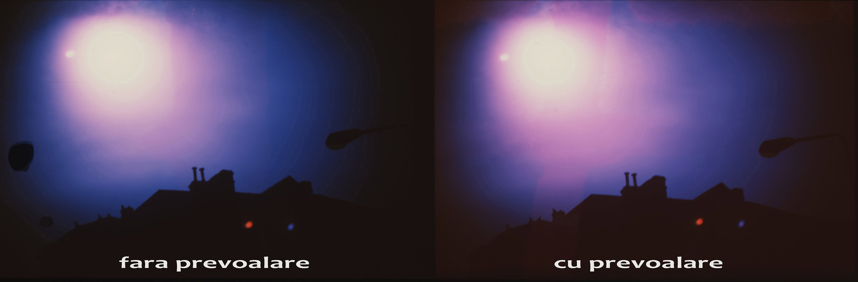

Realizing the reversible color slides on the color positive film is very difficult.
First of all, it must be a very sunny day.
The sun is good for me to photograph from the balcony around 10am.
Tests we've done so far on the color-positive Fuji had to put a little yellow in the picture.
The theory is simple, put a filter of the desired color and concentration.
You get that color on the slide.
I did not have open yellow filters except a greenish yellow that would practically nullify the effect of filters 85.
I found some filters for color paper that has concentrations for yellow, purple and azure from 10 in 10 (ie 0.1).
The big trouble is that these filters spoil my image's clarity, although the chromatic image improves.
I will also present these tests for which I apologize for the quality.

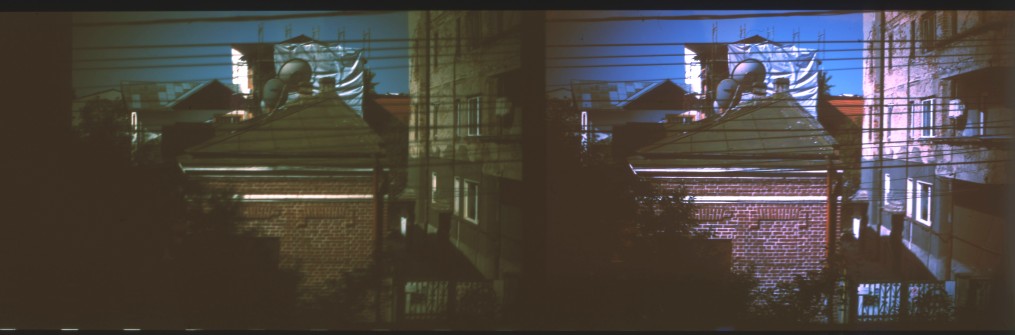

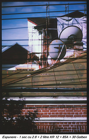

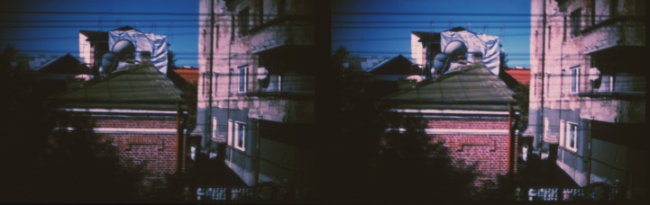

I made a color reversible color test on Fuji color positive.
Without a good sun I can not take the test.
Canon EOS 7 camera, 135 mm Porst lens with f 2.8.
Exposure: 1 sec with f 2.8 + 2 filters KR 12 + 85A + 30 yellow.
Obs. I did not use degraded filters.
PS
The 2 KR 12 + 85A filters are 49 mm threaded.
Objective have a 55 mm thread.
I do not have an adapter 55 to 49.
The 30 yellow filter is square 7.5 x 7.5 cm.
All four filters hold them by hand.
https://www.flickr.com/photos/21121448@N06/28238189888/in/dateposted-public/
George

I'm sorry that the color scale was the one with the color scalevariable color.
The fact that the 49 mm filters are not fixed on the lens and the yellow filter, the chances of decentered or moving the device are great.
Other images in reversible color process on Fuji color positive film.

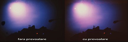

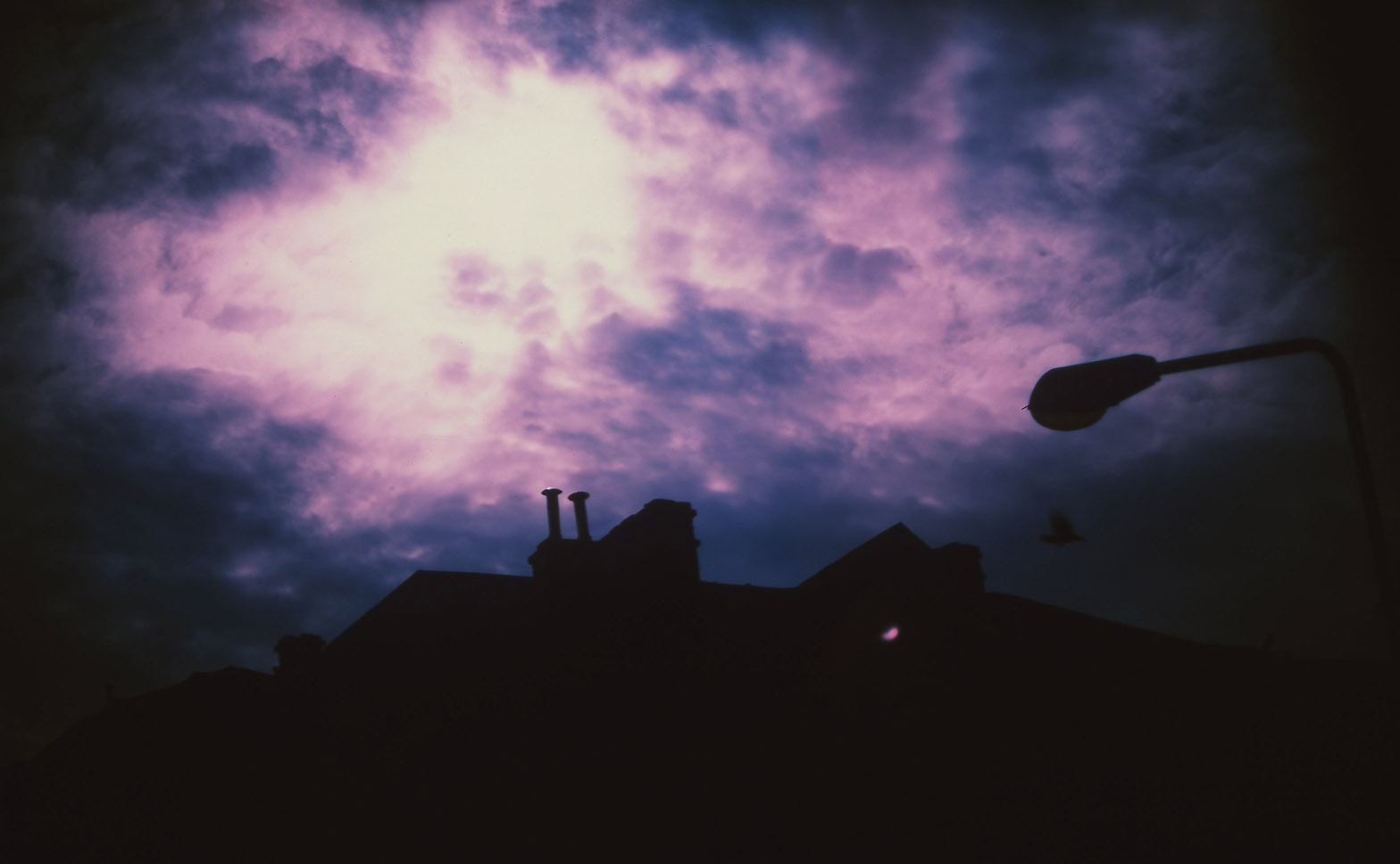

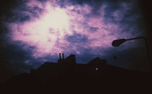

I did not make an important remark.
All the images made on the Fuji color positive film and developed in a color reversible process were scanned and corrected to be as close as possible to the film.
In sample 442-015 I photographed the sun directly.
That purple - indigo color is on the film.
That luminous point on the left of the bird in flight is given by the Rikenon 50mm f 1.4.
I mention that the sun in this photo was weaker.
In sample 437 II, the sun was strong and the lens was Canon 50 mm with f 1.4 /.
Two colored points (red and blue) appear on the film.
These two colored points are all given by the objective.
So far I have not taken pictures of such a regime.
From curiosity.
Someone else took a picture the sun directly?
https://www.flickr.com/photos/21121448@N06/42077587812/in/dateposted-public/
https://www.flickr.com/photos/21121448@N06/41217356534/in/dateposted-public/
George
