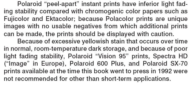

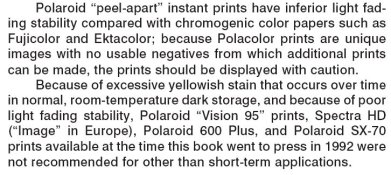

From The Permance and Care of Color Photographs by Henry Wilhelm
It's ironic that the Kodak instant photo system is one of the last ones standing. Any guess as to how Impossible Project color prints might be expected to hold up long term?
see here by matter of proof:
Thanks for that info. Looks like the prints will have to stay in the dark most of the time.
