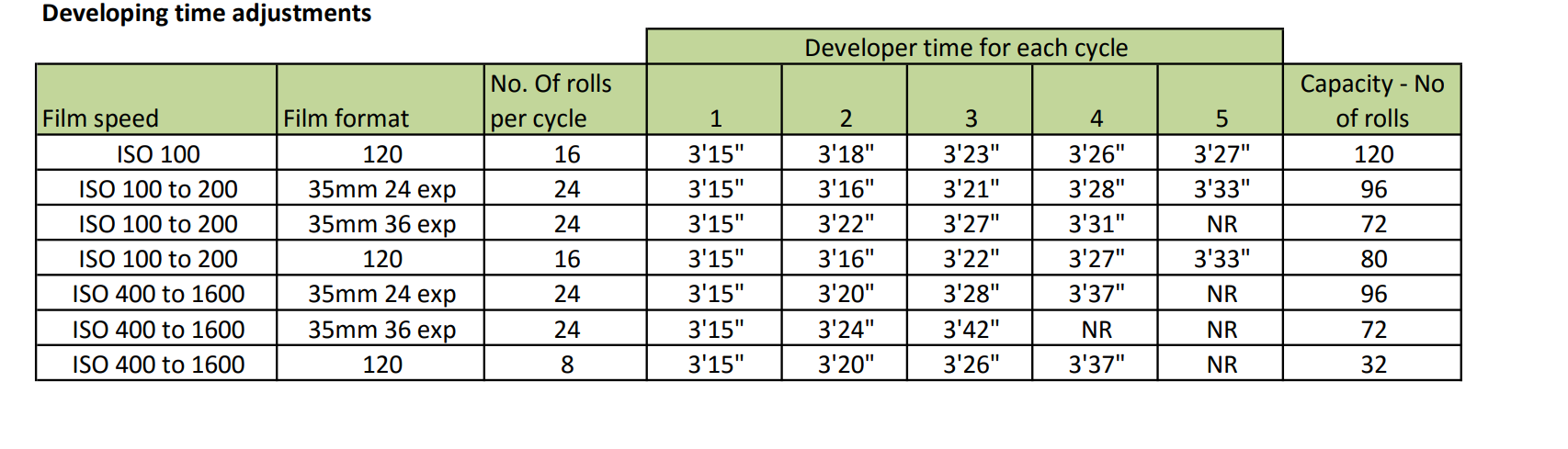

Can I apply the time adjustments meant for the 5 liter mix to the 1 L?
Roughly It seems to be:
1-4 rolls 3'15
5-8 rolls 3'18
9-12 rolls 3'23
13-16 rolls 3'26
17-20 rolls '27
Should I increase the bleach and fix times as well? Should I apply the same rough time adjustment formula?
These should work, however the roll # should be based on 120/5 = 24 rolls to be processed with one liter. This gives you batches with rolls 1-5, 6-10, 11-14, 15-19, 20-24

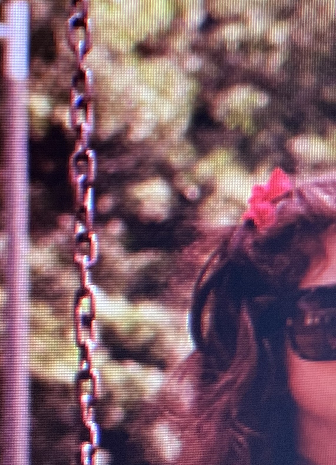

Unfortunately my first C-41 turned a red cast. A splash of water landed on my timer and stopped it. I possibly could not make up the time in my head counting. Temperature seemed to be fine.
If you were printing in a darkroom I would say add yellow and magenta filters. I've never had good luck scanning color negatives, it's difficult. It's probably the scanning.

My scanning is pretty good. I compared Richard’s noritsu to my Pacific image XAS and while not as good it is not too far.

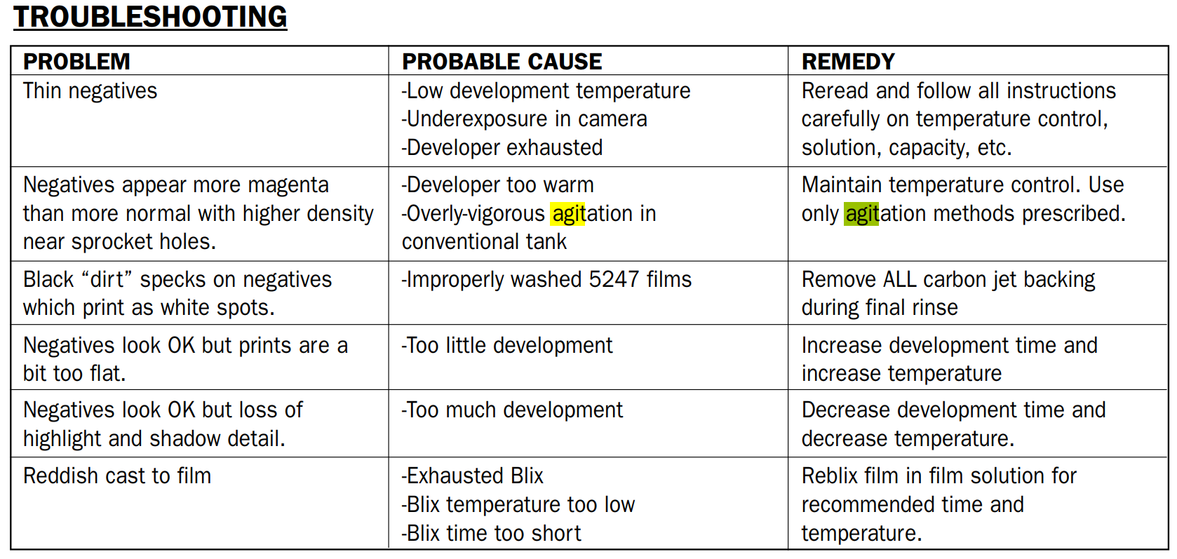

Found this: Might try to reblix a strip.

The reddish cast would be on the films. To get a red cast, I believe the negatives would have a cyan cast. In any case re-bleaching and re-fixing shouldn't hurt and may help the negatives. I've had to re-fix once when I didn't dilute the fixer correctly.

rebleached washed, fixed and washed. Will check in 2 hours
Radost
Jan 21, 2021
1,659
USA from Ukraine
SO far the Cyan colors on the film are still there.
It might have been wrong time? Or temperature?
