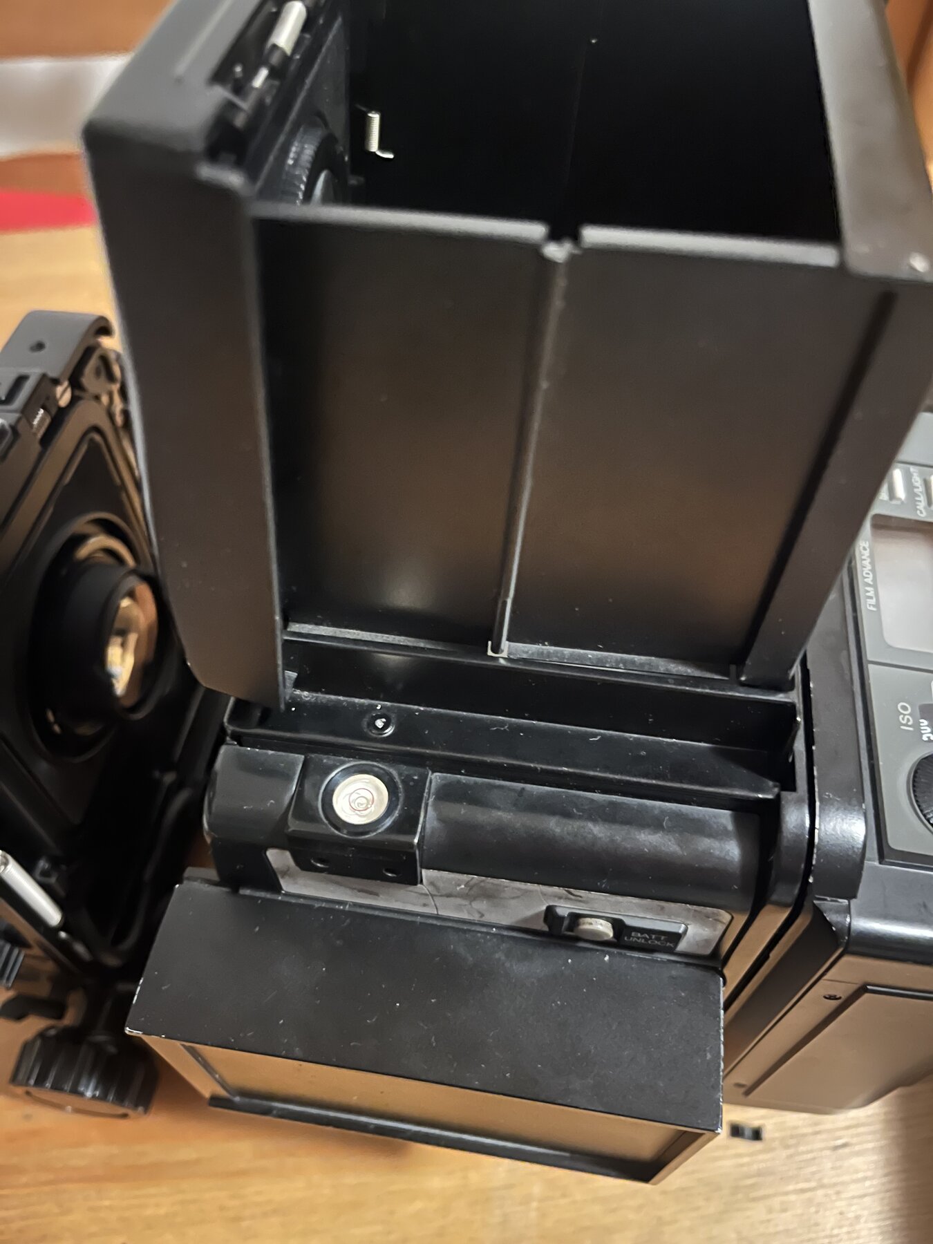

Hello,

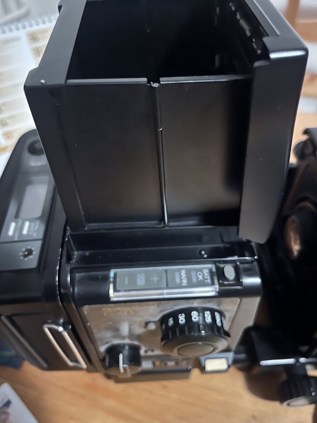

I have recently become an owner of a Fuji GX680 (first version). I am having some trouble removing the standard waist-level viewfinder. I cannot seem to figure out the correct way to detach it from the body.

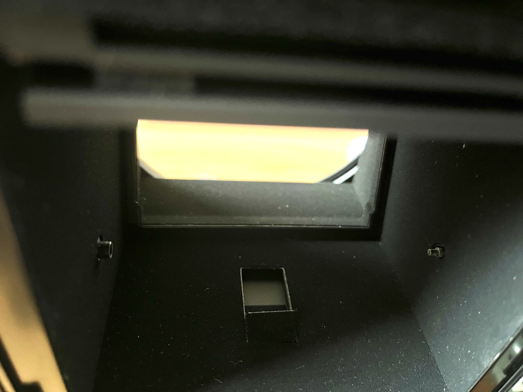

Secondly, I am unsure if the mirror is resting correctly in the down position. When it drops, it stops against two bolts on the sides of the camera interior. However, one bolt is larger/thicker than the other. Is this normal, or is there something missing?
I am attaching photos showing the type of viewfinder I have and the detail of the mirror rest bolts.
Please excuse my English. Thank you for your help!

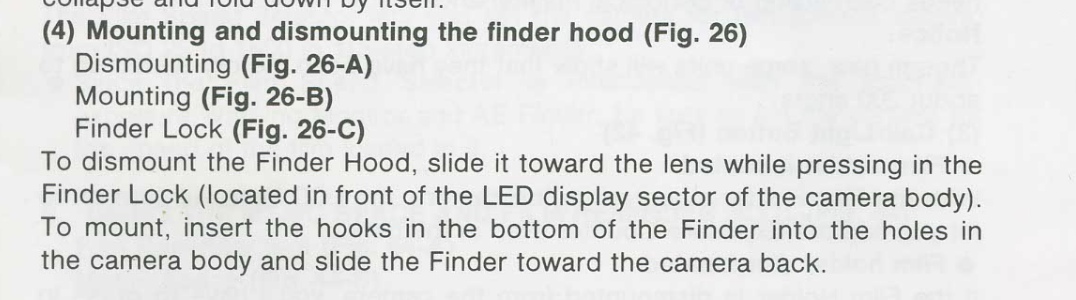

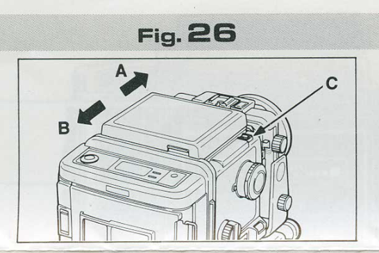

I looked up the manual online (link), and perhaps these might help?
It says to slide the viewfinder forward while pressing the lock (labeled C in the diagram)

I checked on my GX680III, and confirm that you slide the viewfinder horizontally while pressing the buttons (in my case one on each side). Also confirm that the stops for the mirror are different on each side, seems to be by design and not by mistake
The gray button right above the "Batt OK" light is actually the viewfinder release on my model 1 GX680. Does need to be pushed firmly, but then again, I haven't used the camera in a few years. 😔
