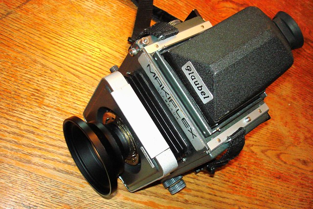

ALL of the GX680 lenses are outstanding. I have modified most of them to fit my focal plane mechanical SLR from the early 1960s (actually it is a VERY similar camera, just mechanical). The Plaubel Makiflex.
The really HOT GX680 glass are the F3.2's. The 180mm is too sharp for some! The 115mm and the 125mm F3.2 lenses are standouts as well. Have not met one I didn't like.
The 180mm F3.2 is a cult lens from what I have found so far.
DSC05616 by Nokton48, on Flickr
DSC05656 by Nokton48, on Flickr
