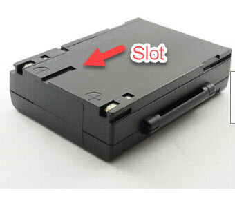

Thanks much. The button is on the camera - it's a little closer to the front of the camera than the two contacts and closer to the top of the battery attachment area. I looked around on ebay and see that some of the battery holders have a little slot cut in the right place to NOT depress this button when mounted. so I'm starting to believe the person who said that a depressed button cuts the power, and the power pack that came with the camera does NOT have a slot - so I'm guessing that maybe the little (about the same size as the contacts) metal button was only on the first (or maybe first and second) model.

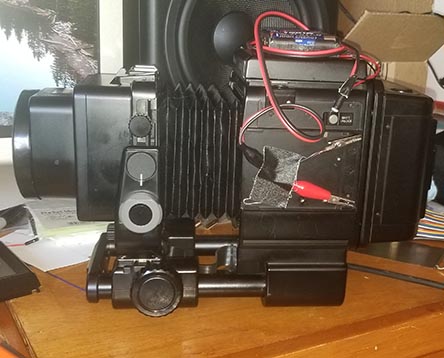

Edit 2: I picked up a6-cell AA battery holder and some alligator clips and was able to get the camera working. I've ordered a somethat more cosmetic solution but all functions seem to operate as expected.

Edit: I wonder why they put such a switch on the camera - unless it's to distinguish between a 7.2V rechargeable battery pack and a 9V AA battery pack. Does anyone know for sure???
I found the answer this weekend-- I've always coveted the gx680, and took a chance on an untested unit this week. It's not here yet, but I was reading the repair manual, and that switch is to tell the camera whether it has a battery pack, or the DC power supply (which is called the DC power supply, but it's really an AC power supply that supplies power via a battery pack shaped connector). If it's the power supply, the camera uses a different check list for the battery check procedure.
It's the power supply which has the slot-- I would guess that any battery pack with the slot in the base was cannibalized from the PS.
I found a working PS for cheap, and my intention is to 3D print a power-pack using the 18650 rechargeable batteries (2x batteries for 7.4v total).
Funny - My power supply didn't have the slot and all the battery packs I've found DO have the slot. Oh well...
Let me know how those batteries work out for you. I might give them a try. Right now I'm just using non-rechargeable batteries in the pack. Camera works great - I found a cable release for it and picked up a couple of more lenses including a 65mm. My biggest challenge right now is picking the camera up!
Yeah-- Did some more reading. There's a good site here: https://www.galerie-photo.com/fuji-gx-680-boitiers-et-accessoires.html (requires translation) with some discussion about that switch. If I'm understanding it correctly, the 8v (power supply) and 9v (gx680 III) packs should *not* depress the switch. The switch should apparently(?) only be used with 7.2v battery packs (gx680 I/II). In addition to more stringent battery checks, it also activates the 15 minute auto-power off.
The power-supply I bought does have the cut-out, so it doesn't depress the switch.
