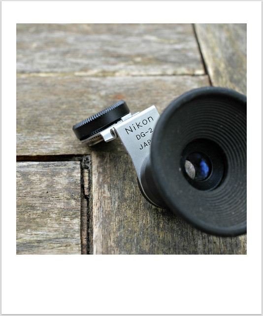

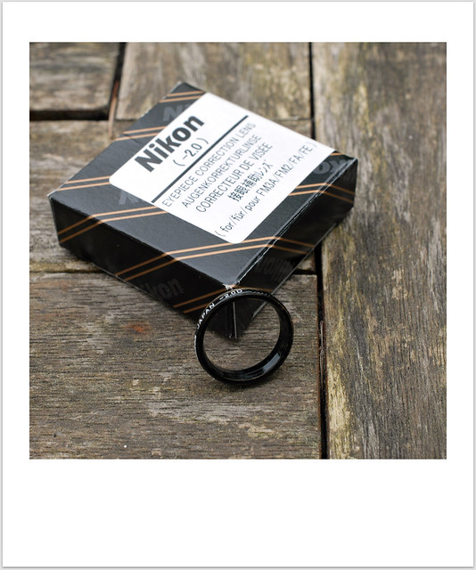

Hi Dean, I use my GW670iii with the Nikon Eyepiece Correction Lens (-2dpt.). This one has 19mm diameter thread and will fit the GS645 series too. Sometimes I use it on my GA645 which is AF.
Another nice and helpful solution is the Nikon Eyepiece Magnifier DG-2. The Nikon DG-2 2x Eyepiece Magnifier provides 2x magnification of the central portion of the finder image.
DG-2 is useful for critical focusing in close-up work. The magnifier flips up to quickly view the entire image area when needed. It has a rubber eyecup and dioptric correction ranging from -5 to +1.
View attachment 280464 View attachment 280465
Thanks for all the info. I completely forgot about the DG-2. I’ve had one for years and used to use it on an FE2 until I moved to a F3HP which I still use today along with a DK-17M. Very nice combo. I’m hoping the Nikon +1 diopter will be enough for the GS645S but with a DG-2 there should be any issues at all. Especially for the sort of images I usually like shooting.

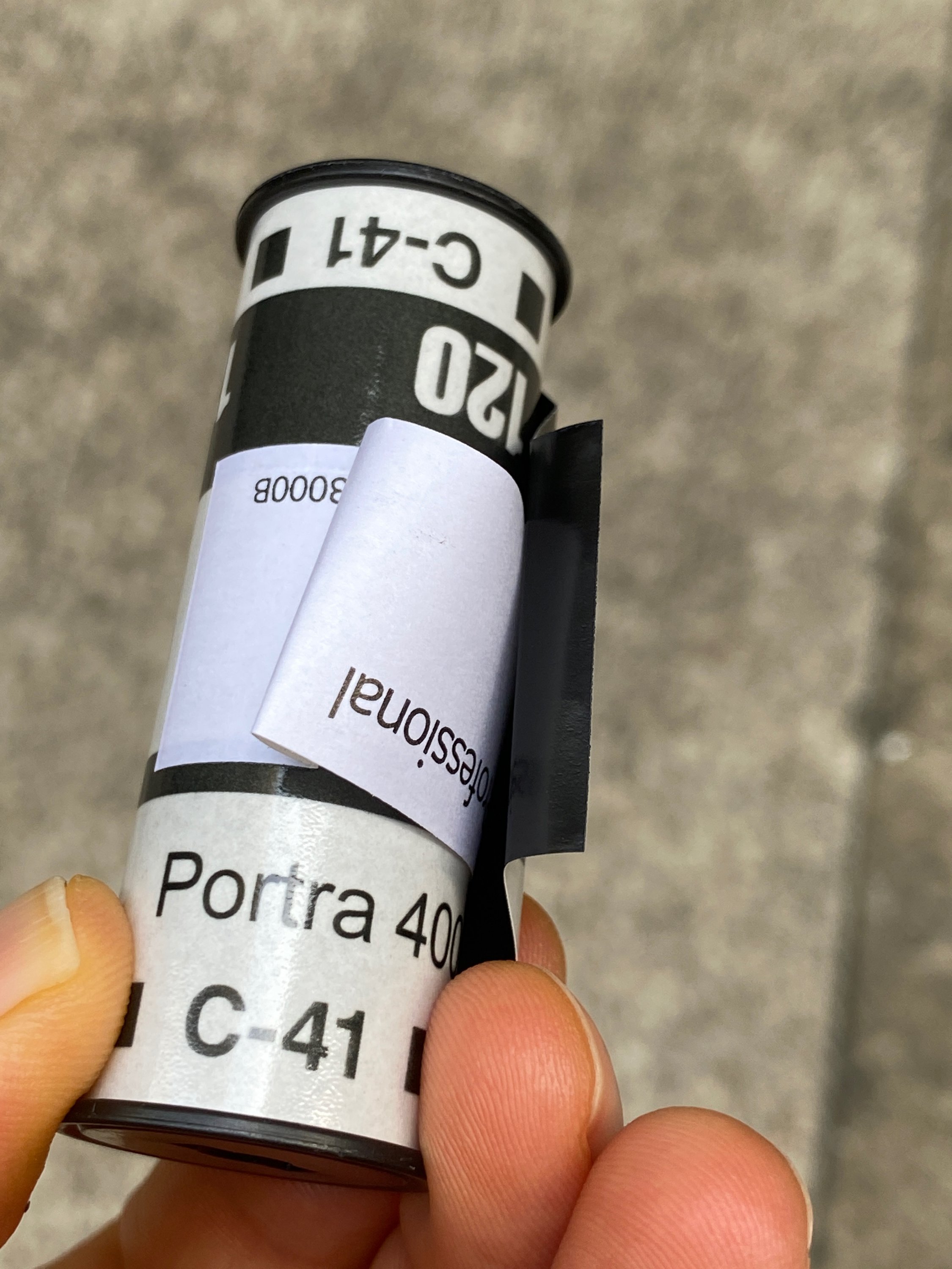

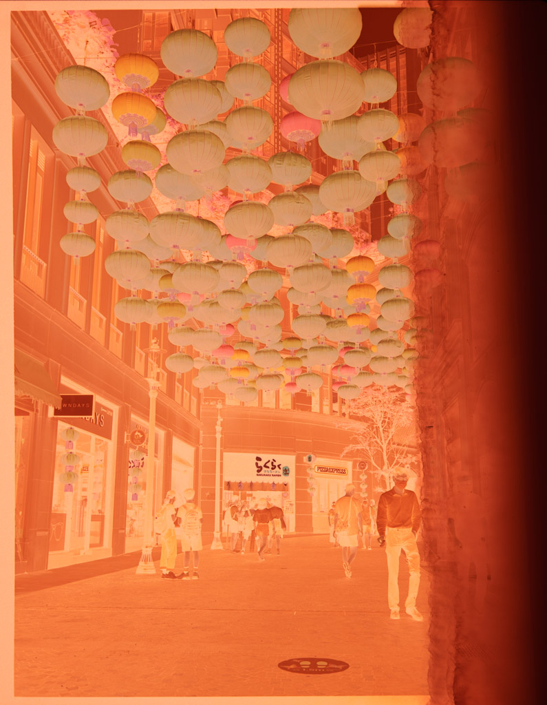

Hello. I ended up going down this path and buying a GA645i from eBay Japan. Very nice camera indeed! Amazingly light with a very contrasty and sharp lens with basically no distortion. It's going to make a nice alternative to my heavy Bronica EC-TL :smile:
The method you outlined for an alternative to AEL works perfectly. Thanks!
One issue I am having though, is that the last shot on each roll looks like it has been exposed to light. Please see attached images. It's happened with 3 different rolls. With the 3rd roll I took it to a different lab to be developed just to discount the lab variable and the same thing occurred.
I'm pretty sure I know why this is happening but I could be wrong. The "End Seal" part of the film is impossible to pull out to seal the roll of film. It's very tightly sandwiched between the film and the only way you can pull it out if to raise pull some of the actual film up and back ... only then can you pull out the "End Seal" paper part that you use to seal the roll. I think doing this exposes some of shot 16 to light. I'm pretty sure that's what's happening. These were all with Portra 400.
Can I ask ... is the end seal easy to pull out on your camera? It's very easy on my Bronica and GW690iii. But on this camera it's impossible. I still have a couple fo weeks to unconditionally return it if I want.
Other than this I've been super happy with the camera.

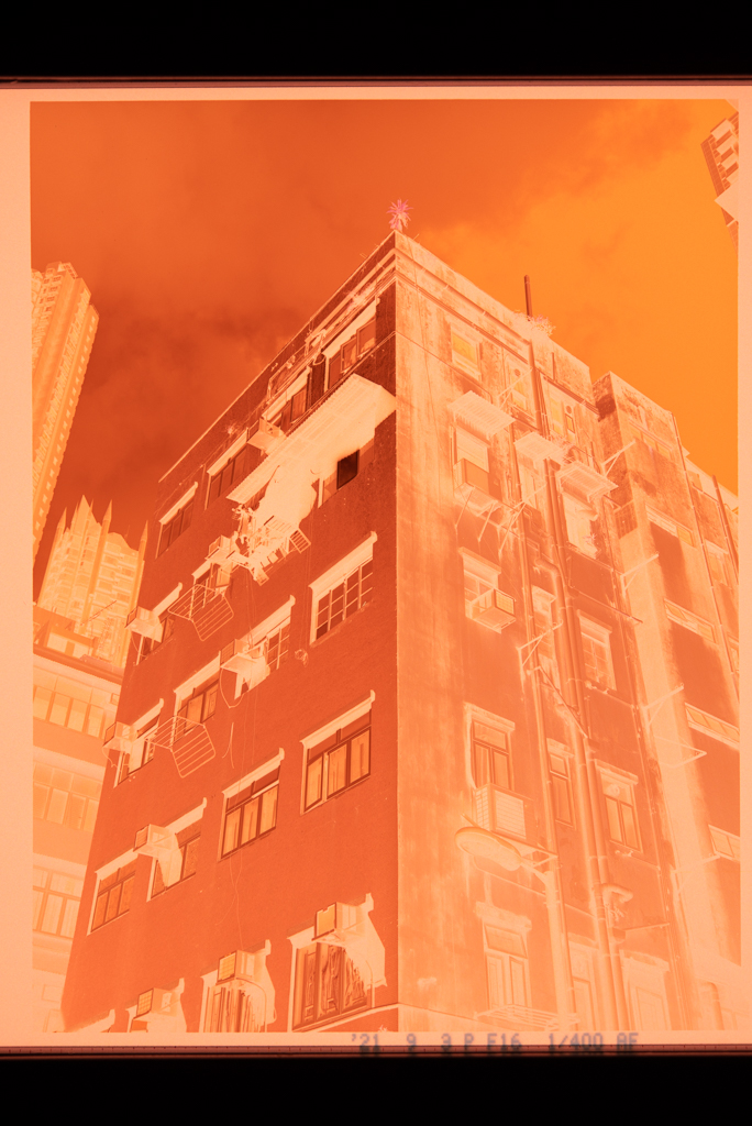

Other than this I've been super happy with the camera. View attachment 285238 View attachment 285239 View attachment 285240
Cheers.
I don't think it is that. Have you ever developed your own 120 film? When you load it onto the reel you have to unwind quite a bit of backing paper before you get to the actual film. You would also see edge fogging if what you say is possible. But you pretty much just see a straight-ish line.
I think there is something wrong with your camera. The easiest way to tell is to unload it in a dark bag or darkroom so it doesn't matter if you unroll it while trying to seal the end. Then if you still see this issue - camera problem.
MattKing
Apr 24, 2005
51,936
Delta, BC Canada
I don't see any sign of any edge printing on that negative, which says to me that the image is too close to the end of the film.
Which usually means that the film has been wound too far before the back is closed prior to the first frame.
Unless the problem is with the frame spacing itself.
Can we see an image of the first few frames of the roll, which shows the edge printing and the spacing between frames?

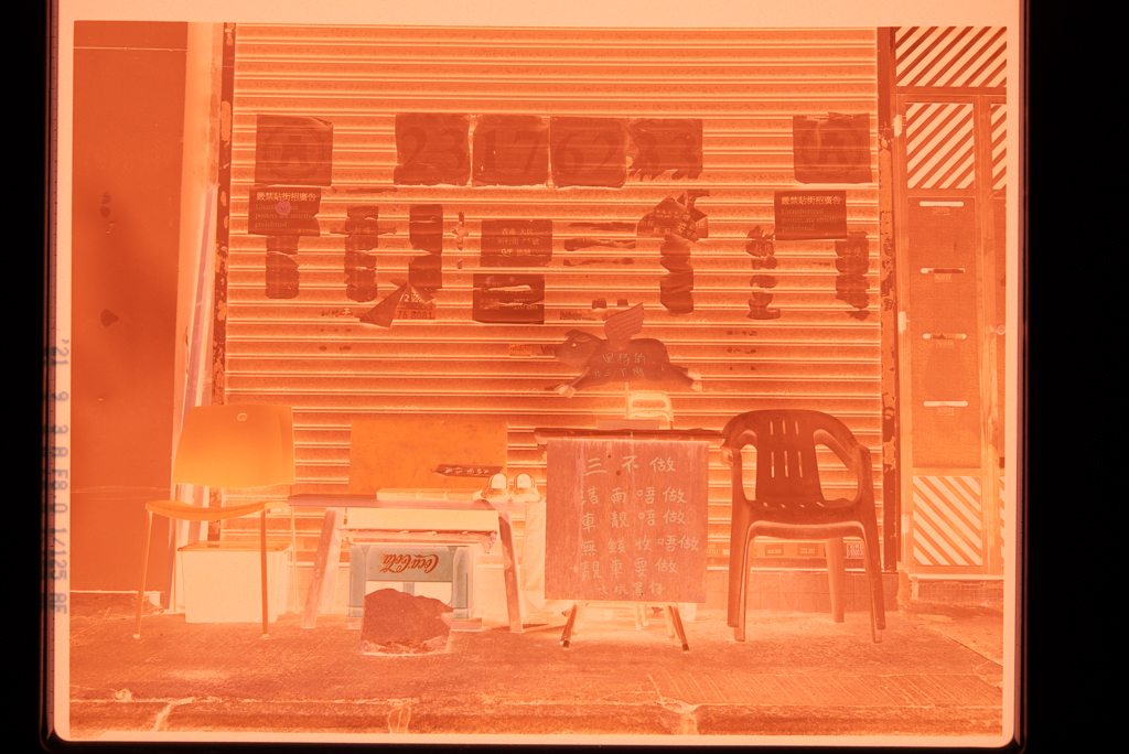

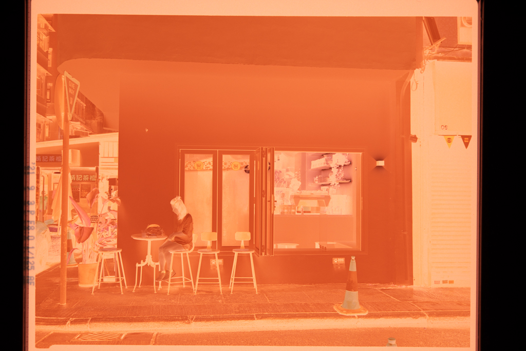

04. GA645i (R002c).jpg 03. GA645i (R002c).jpg 02. GA645i (R002c).jpg Hi Matt.
Thank you for responding.
I switched off data printing on that roll, but here's some consecutive ones from the previous roll with the edge printing.
To show the space between frames I'll need to take an image of the actual entire strip.
Cheers.
