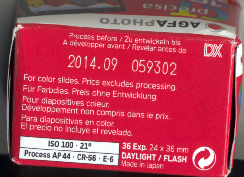

Here's a direct scan of one side of one of these Precisa boxes showing "Made in Japan." Another side has the same wording about AgfaPhoto Holding reported above.
I've just checkedmy film box again, and it does, in tiny writing, state "Made in Japan". Very confusing I have to admit!.....Why would Fuji manufacture film under another label at a cheaper price, that could possibly rival their own 100asa material?
