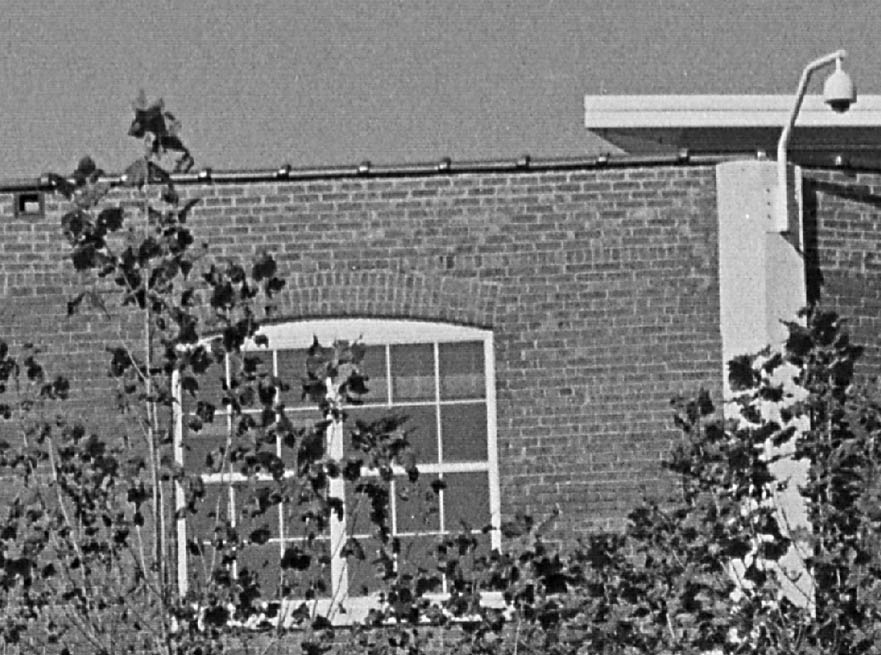

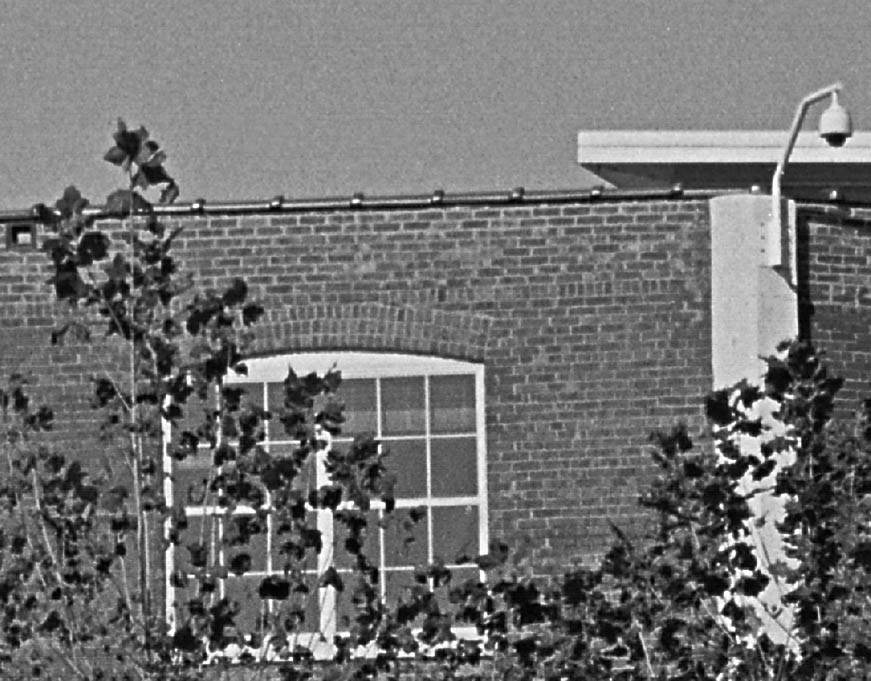

I scanned the comparison Efke 25 and Acros negatives this morning at 5080 spi. After comparing the scans with the negative through a microscope I conclude that I am getting about 95% of the detail on the negative in the scan, which suggests resolution on the order of 95 lp/mm, about what I would expect from the camera/lens/film/developer combination.
Attached are three files, one of an area 1.2" X .9" in the center of the 6X7cm negative, with a white rectangle to indicate the area of the crop, and crops from the Efke and Acros negative. There is to my eye no difference in sharpness between the two crops, but the Efke crop clearly has finer grain. In viewing the crops bear in mind that you are looking at an area of .17" X .13" from the original 2 1/4" X 2 3/4" negatives.
My conclusion is that with my work flow I can indeed get *slightly* better image quality from the Efke 25 film than with Acros because of the finer grain. Even so I would probably still favor Acros slightly because of its much lower reciprocity failure.

Mike1234
Jul 6, 2009
1,908
South Texas,
There are so many variables involved but, judging from what I see on screen, the Acros seems to have better acutance and shadow detail with your given procedures, Sandy.
sanking
Mar 26, 2003
5,437
Greenville,
Mike,
I think the Acros crop has just a bit more contrast in the mid-tones, and that may be what gives the appearance of better acutance. When comparing the entire image I found the two scan files almost identical in image quality in terms of sharpness. The only thing that stands out is the finer grain of Efke 25.
