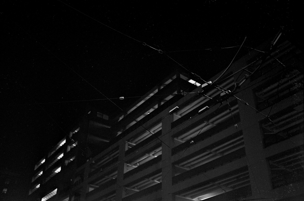

And now for something a little different: Acros 100 pushed to 1600 and stand developed for 2 hours in XTOL:
Nikon F3HP + Nikkor 35mm f/2.0 AIS, Fujifilm Acros 100@1600, Kodak XTOL 1+3 (stand)
