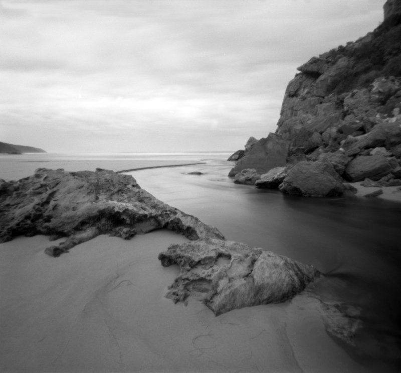

My freezer has just 4 (precious) rolls of long-ago expired ACROS II. I use it for 6x6 pinhole photography for simple landscape subjects that suit it. The defining feature of ACROS II is an almost creamy, dream-like appearance of the tonal range — far removed from the blunt edge of e.g. Delta 100 and others. No filters used with the pinhole camera.

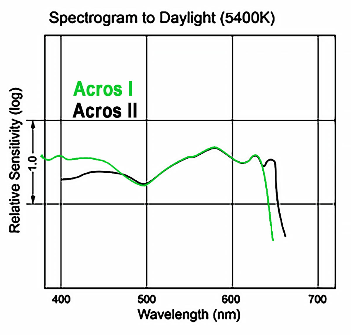

I find that the film has adequate red sensitivity and works with red filters as well as anything else. Looks at spectral sensitivity curves it is about the same as other conventional films.
No, the cutoff point of Acros in the red is sooner than most typical pan films. You need to look at those spectral sensitivity charts more closely. It is officially classified as something else for a reason. Just try using a deep red 29 filter and see what happens. Even using a greater filter factor won't retrieve all the information. Another evidence is how green, the complement to red, reproduces so much lighter. For example, a light green 11 or X0 filter with Acros will have just as much effect as a rather dark green filter on regular pan film.

I'm looking at the datasheet provided by Fuji for Across II. It shows sensitivity all the way out to 650nm. This is comparable to other films such as Tri-x and HP5+.
I've used this film with a red filter with success. I admit I haven't tried a deep red with it yet. My deep red filter works great with HP5+ as a reference point.
It appears that Acros had less red sensitivity than Acros II, but I never tried the original version first hand.

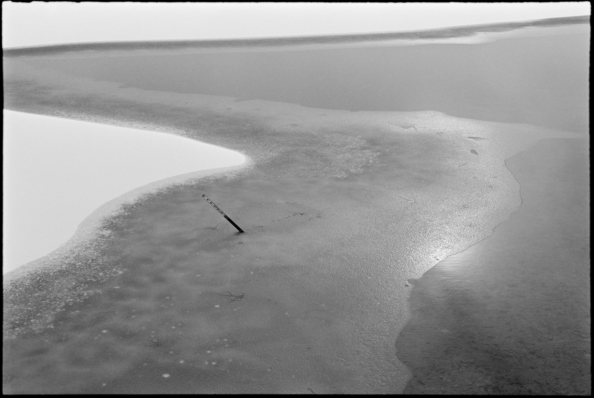

Acros in EV 15:
Scala 50 in EV14:
Acros is more of a jack of all trades with the exception that it can't do infrared. Scala's contrast can be a bit much for portraits. Maybe with a green filter it could work better for that.
