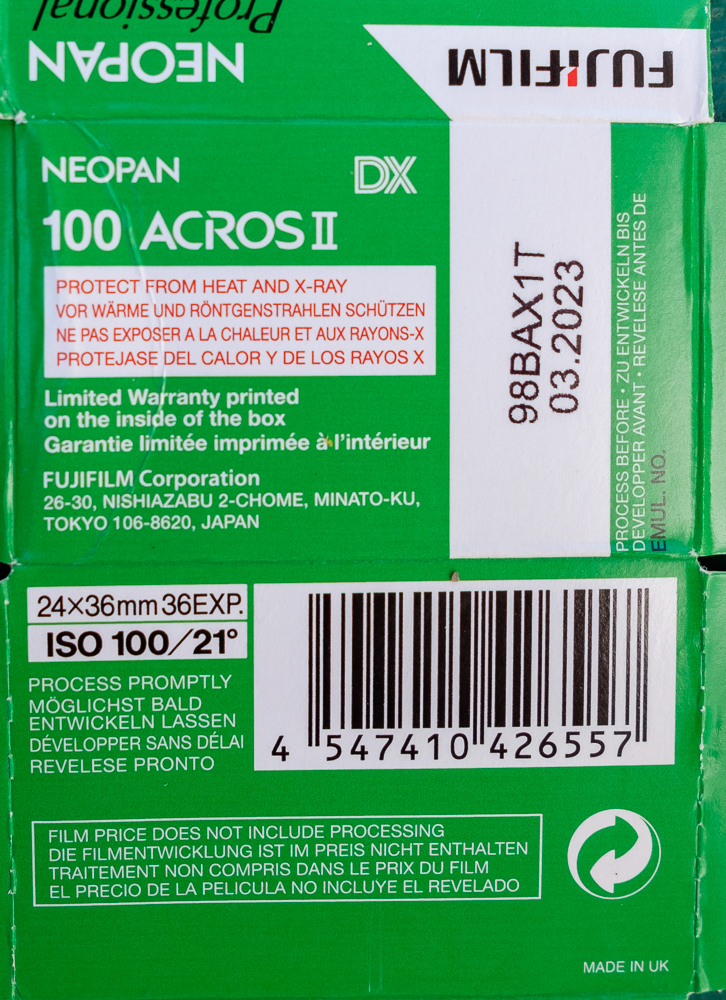

Also, I've never heard that Ilford manufactures any Fuji film.
It's a public secret that Harman has been making Neopan Acros for quite some time. Certainly the present II version, but most likely the initial version, too.

... Also, I've never heard that Ilford manufactures any Fuji film. Fuji certainly has the capability to make it themselves.
If you look closely, down in the lower right-hand corner, you will see "Made in UK"

Agree with the comments on stop and fixing times. Making mistakes is part of the process, but it's critical to establish consistent and repeatable practices when developing film. Also, I've never heard that Ilford manufactures any Fuji film. Fuji certainly has the capability to make it themselves.
From Ilford's official Flickr group description:
"Please add only photos taken with Ilford film and/or Ilford cameras. Please, no films made by Ilford but branded differently, such as Fujifilm Acros II or Kentmere films."
Fuji makes their color films themselves, but not the B&W stuff. They say so themselves.
