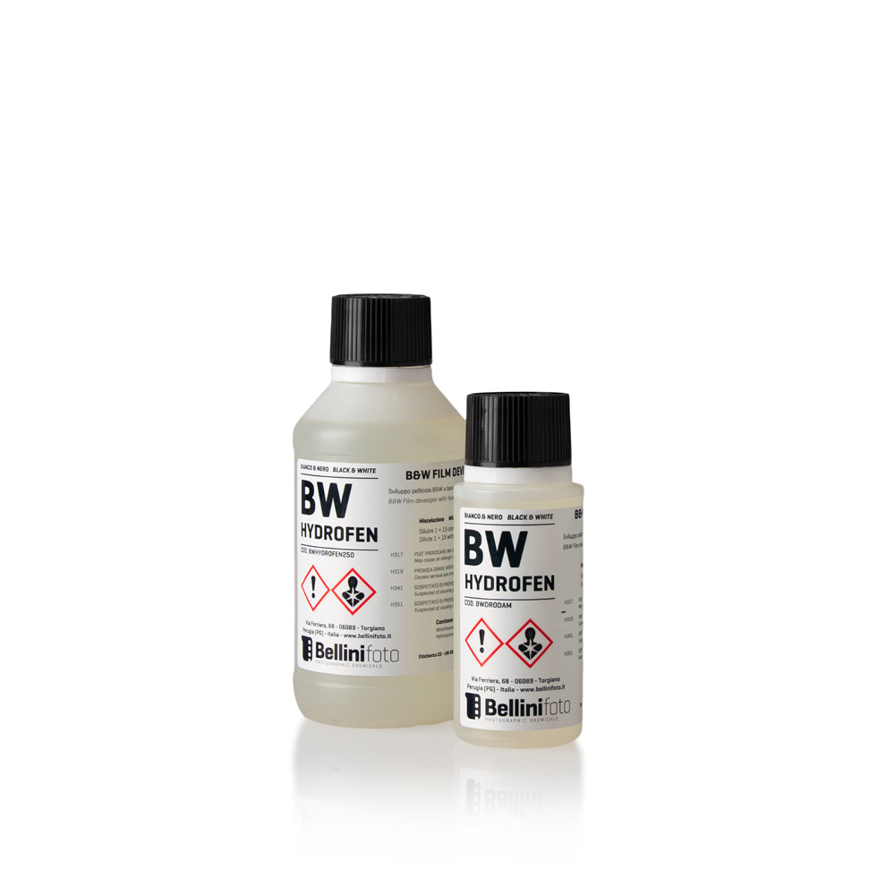

I can suggest you Bellini Hydrofen, an economic yet powerful developer. It's to be diluited 1+31 and has excellent compensation fatures.
It comes in a handy 100ml or 250ml bottles.
