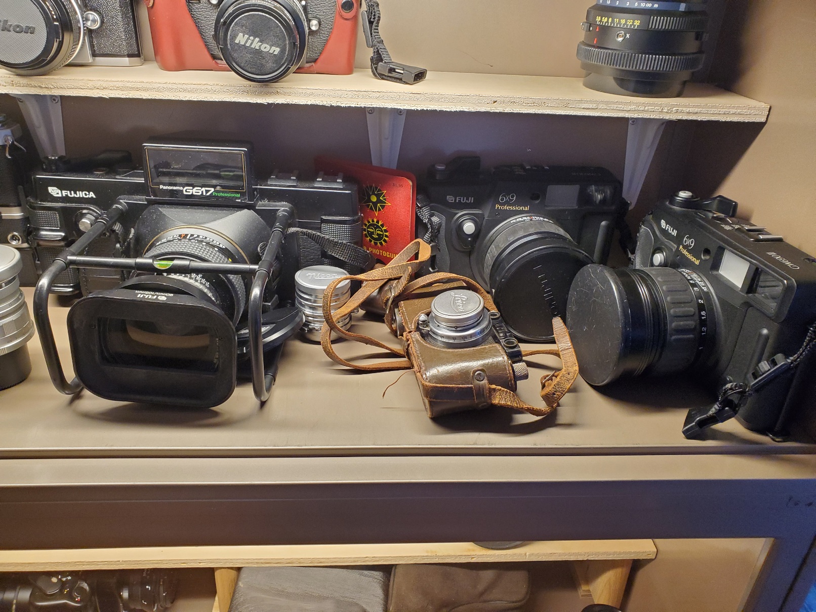

I paid $200 for this GL690 in 2011. It is a great camera at 5 times that price.
⚠️MONSTER CAMERA ALERT⚠️
