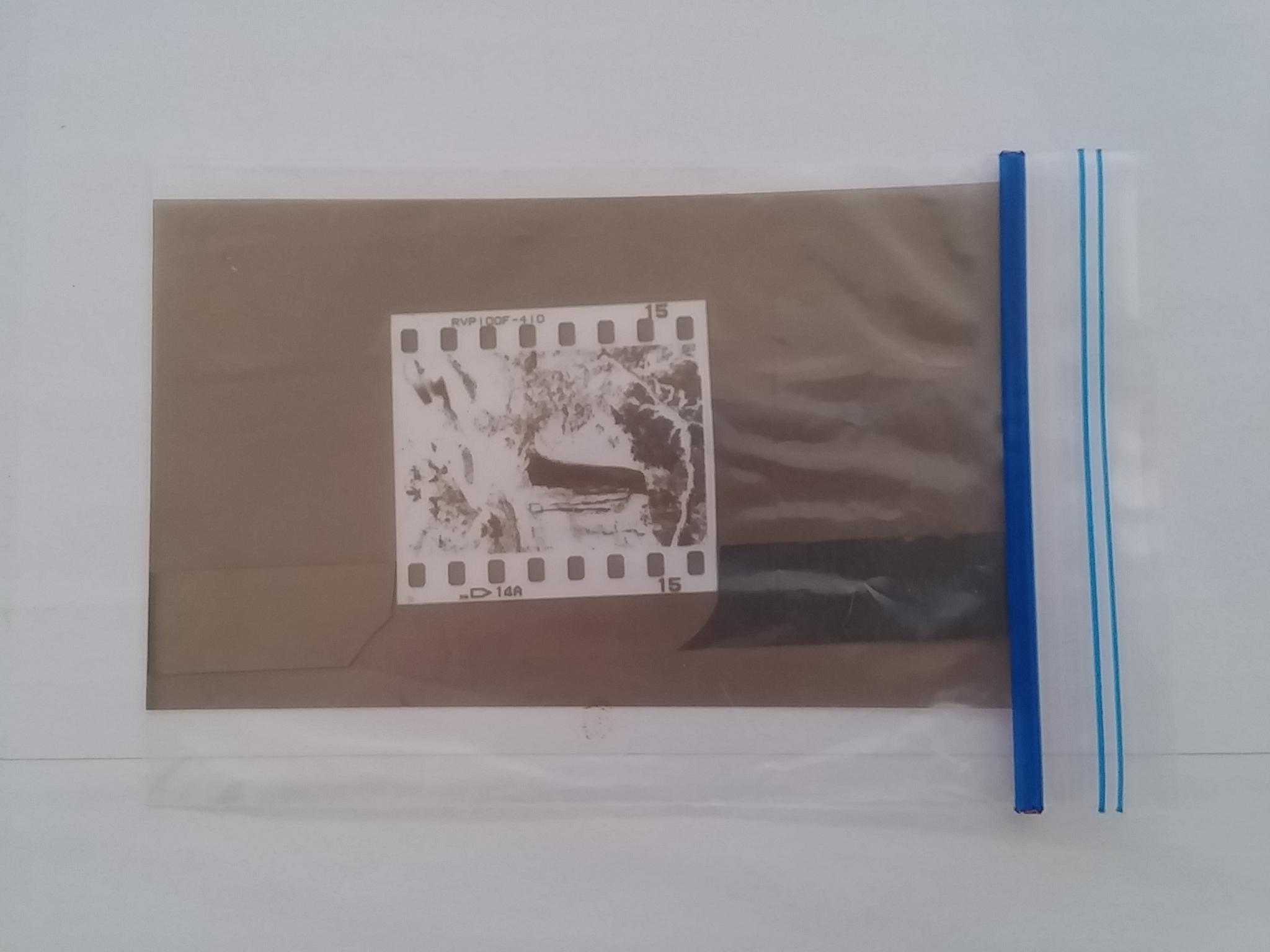

Yes, definitely, this is the way all of my and most others' Ilfochrome Classic prints were made, including from MF and LF, "internegs" or "masks" were always made in my case for production of prints in the Ilfochrome Classic process (they were additional cost, rising in cost with size of film); see my pic of one of these masks (there was a url link here which no longer exists) in the Ilfochrome Classic vs RA4 print... thread.

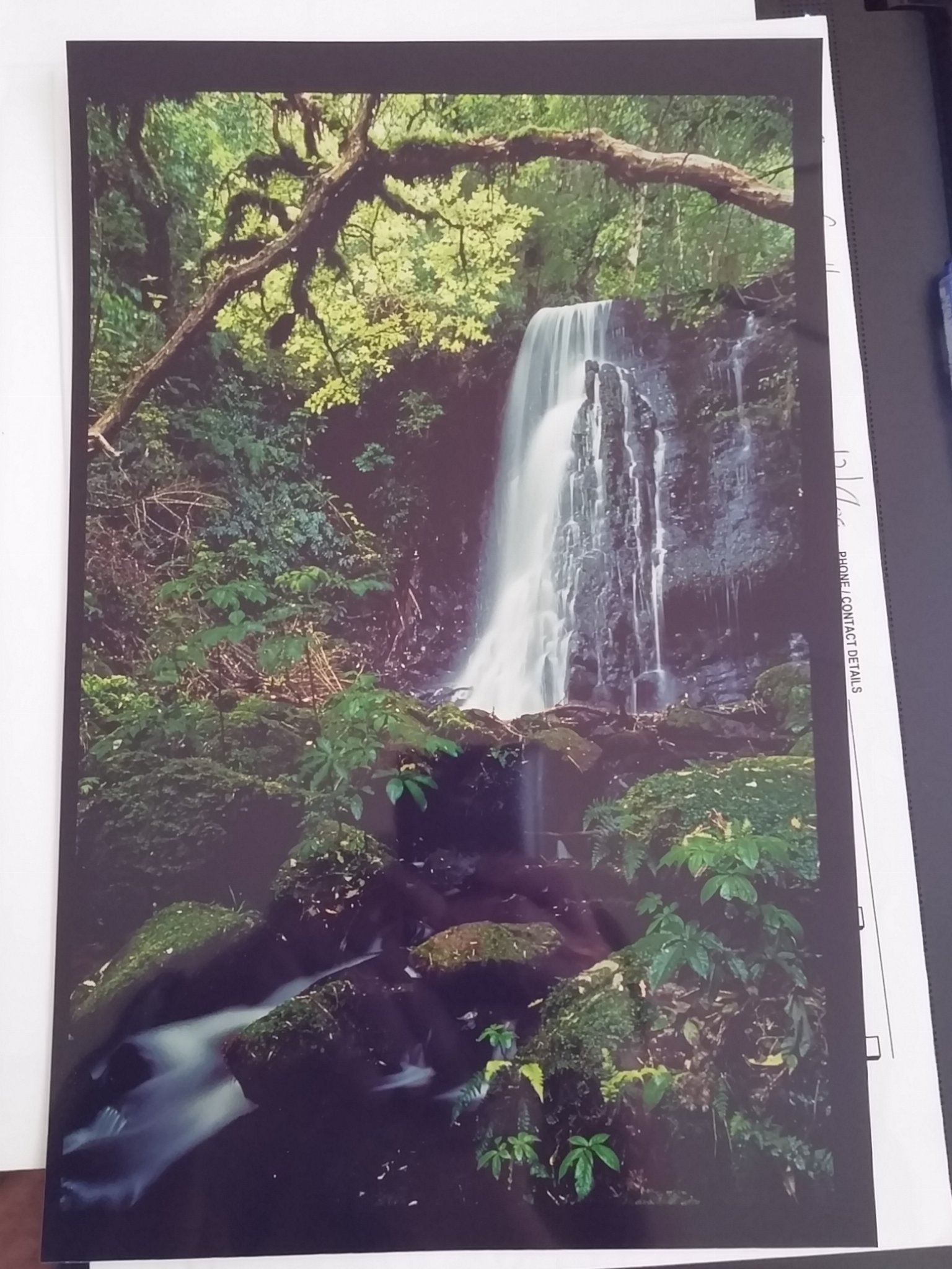

I found an IC print produced long ago (2004?) with a mask. And the mask is a give-away: it is a B&W copy (contrast adjusted) of the original transparency. Pic attached, plus photo of original IC proof (the final was framed and is on the wall above me). I can assure you the IC print doesn't look so monstrously mushy as shown here! :redface:

Except that print up there I posted is an Ilfochrome Classic, not RA4 (RA4, as we know looks soooo much better, but that's a whole other story... :whistling: )
