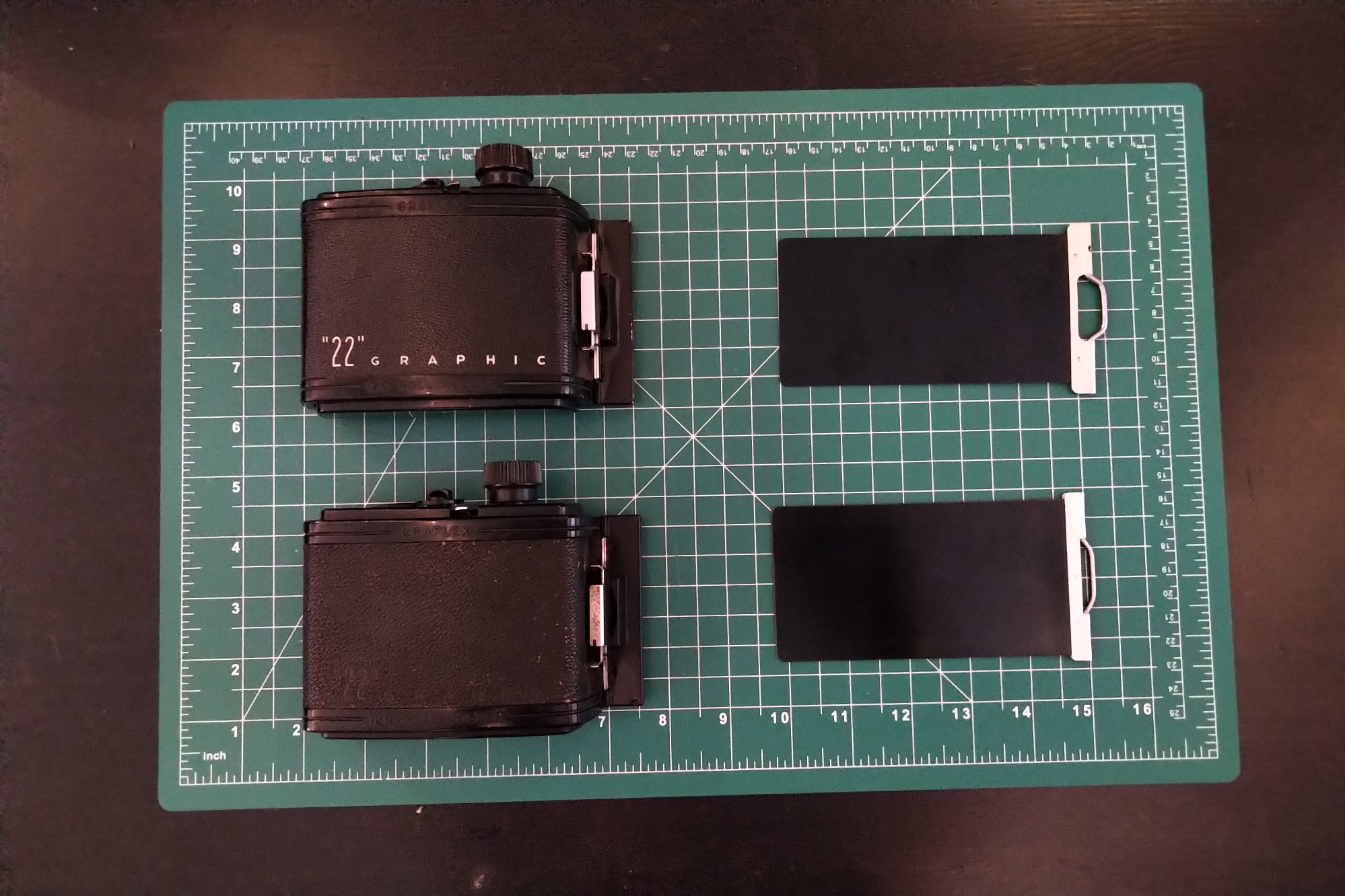

These are the older, knob-advance backs for 12 frames of 6x6 on a roll of 120. The two are functionally identical but with some minor cosmetic differences as they appear to be from different eras. These should fit all "baby Graflok" 2x3/6x9 cameras (one of these came as a surprise when I bought my Century Graphic) and I believe the Mamiya RB67 as well.
Both are in fine working order (full stop on all 12 frames) but with a couple of caveats given their age:

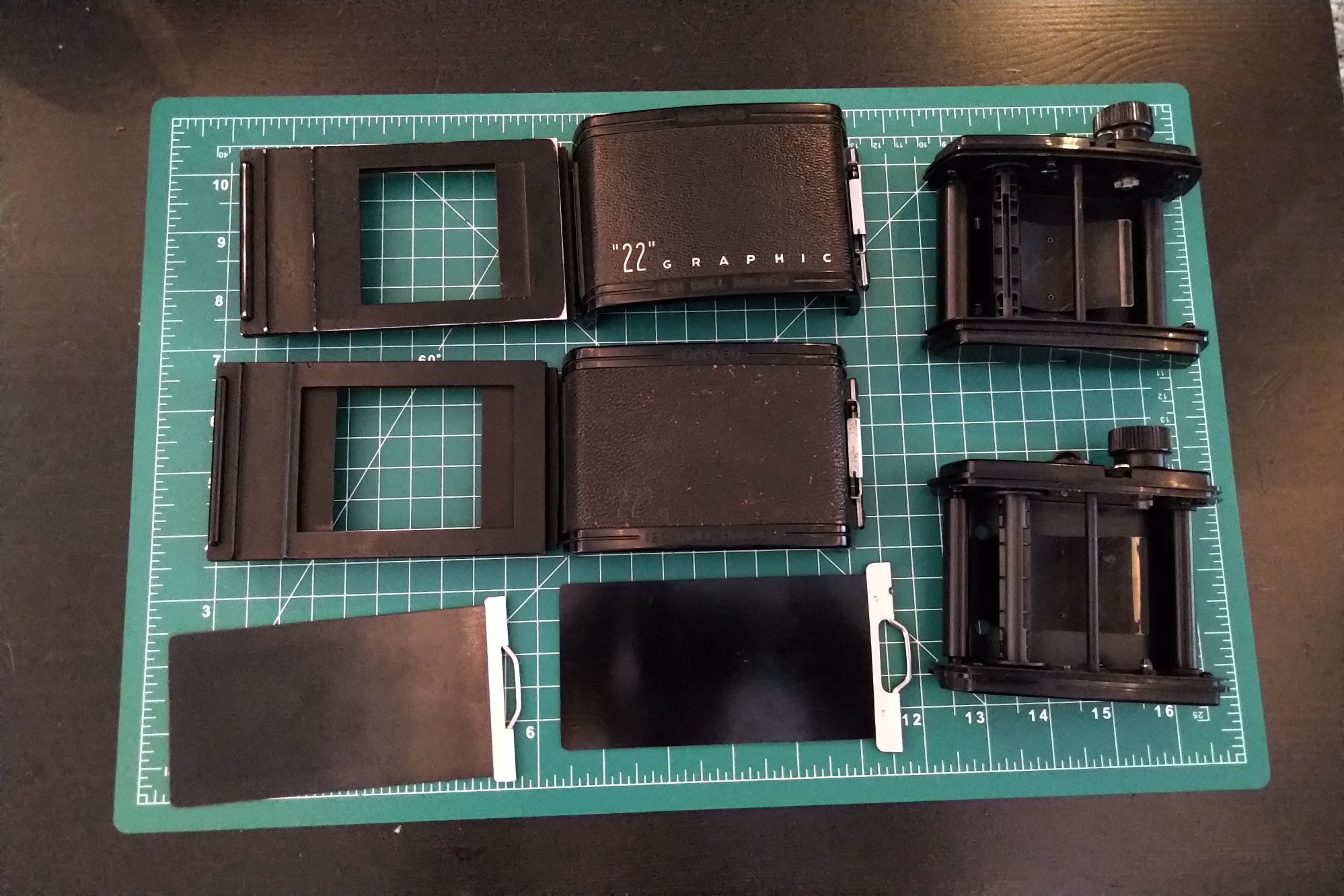

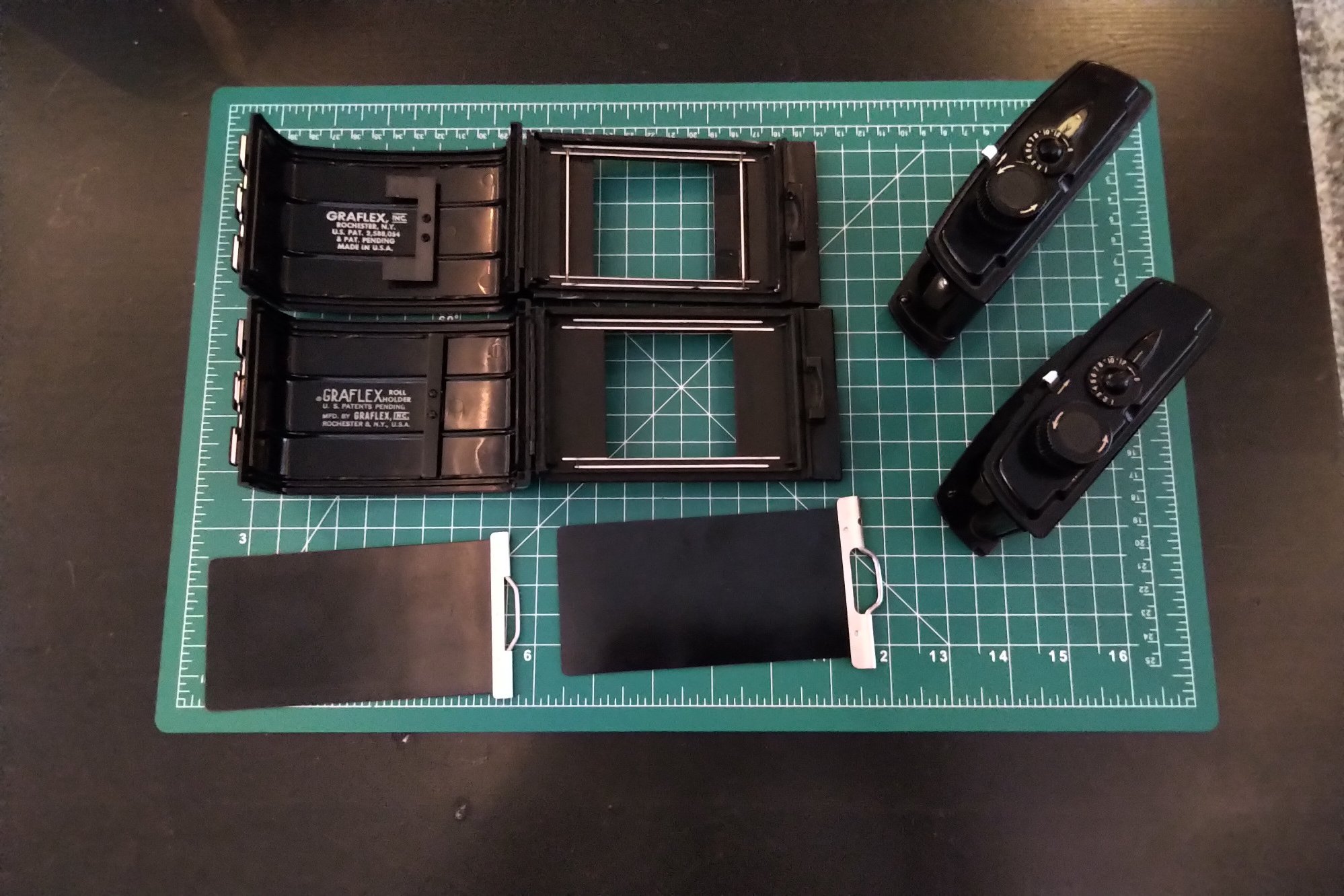

- When I received Back #1 it had a light leak due to seal deterioration. I applied a quick fix of 2 small pieces of gaffer's tape to the rails and the LL is solved, at the expense of a very snug fit, but opens/closes normally.
- Back #1 also had an issue with narrow/overlapping frame spacing on the second-to-last roll I put through it, but the last one was fine (as were multiple rolls previous), so an adjustment may be necessary (or was just user error).
- On Back #2, one of the flat metal pieces that makes up the 6x6 mask has broken off. It has been temporarily secured with a piece of gaffer's tape and works fine as-is, but could use a more permanent repair at some point.
YMMV of course. Sold as-is. Dark slides and take-up spools included.
Would prefer to sell the pair together for $135 $120 but will sell separately for $75 $65 each OBO if no takers. Buyer pays shipping.
