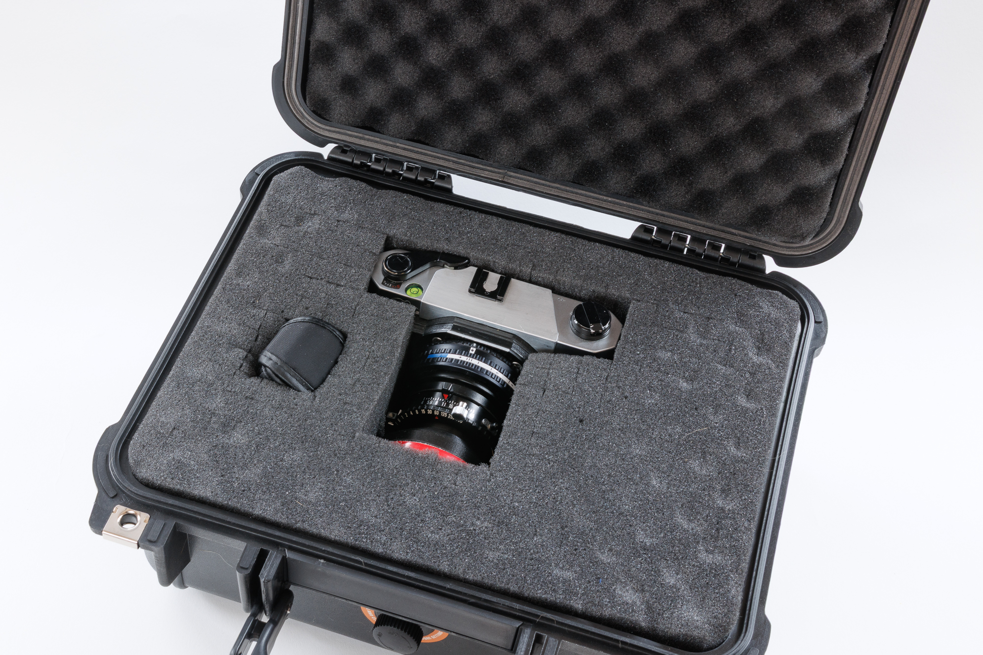

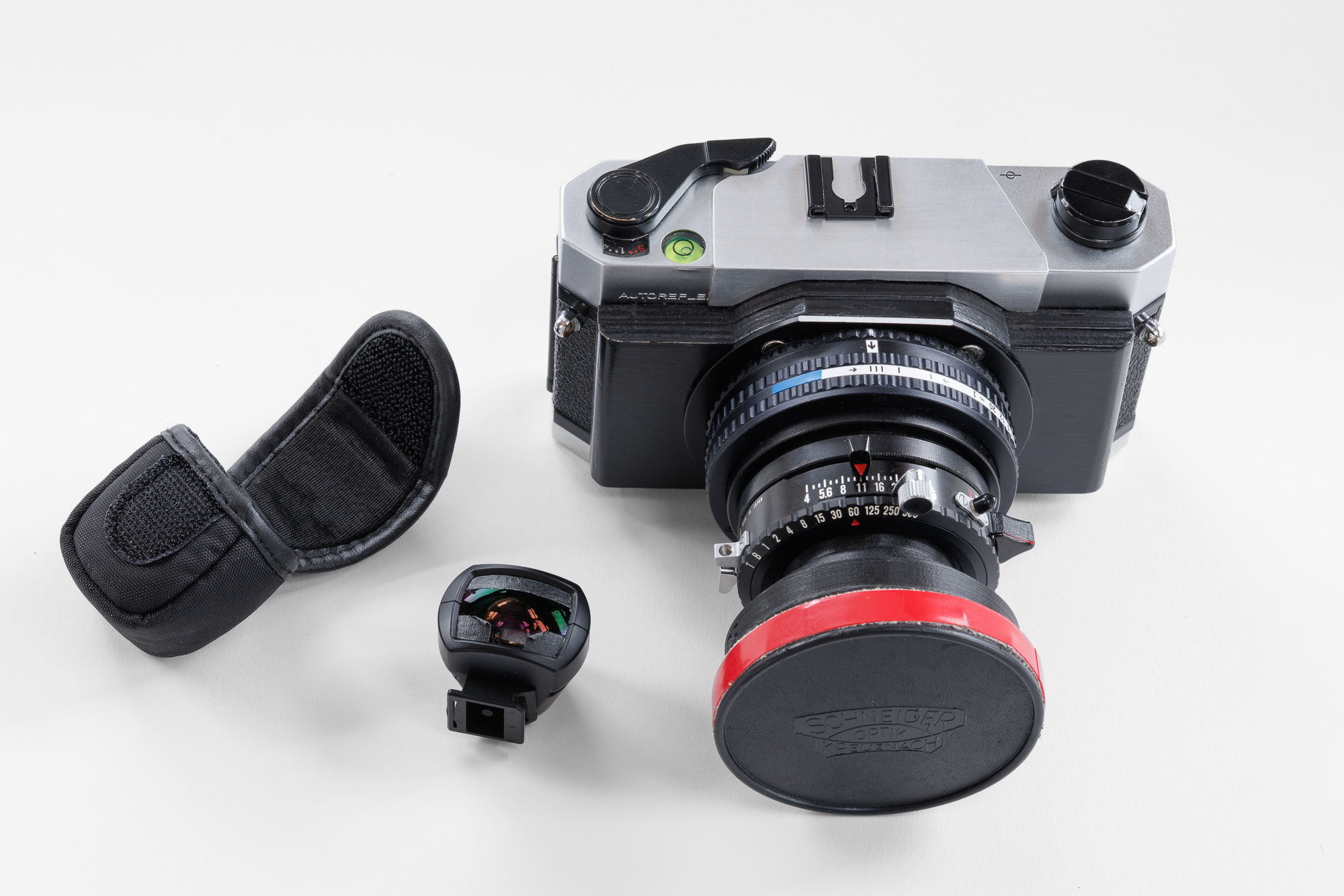

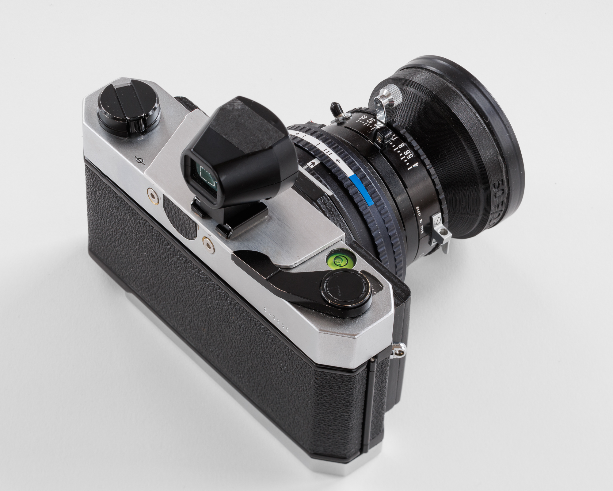

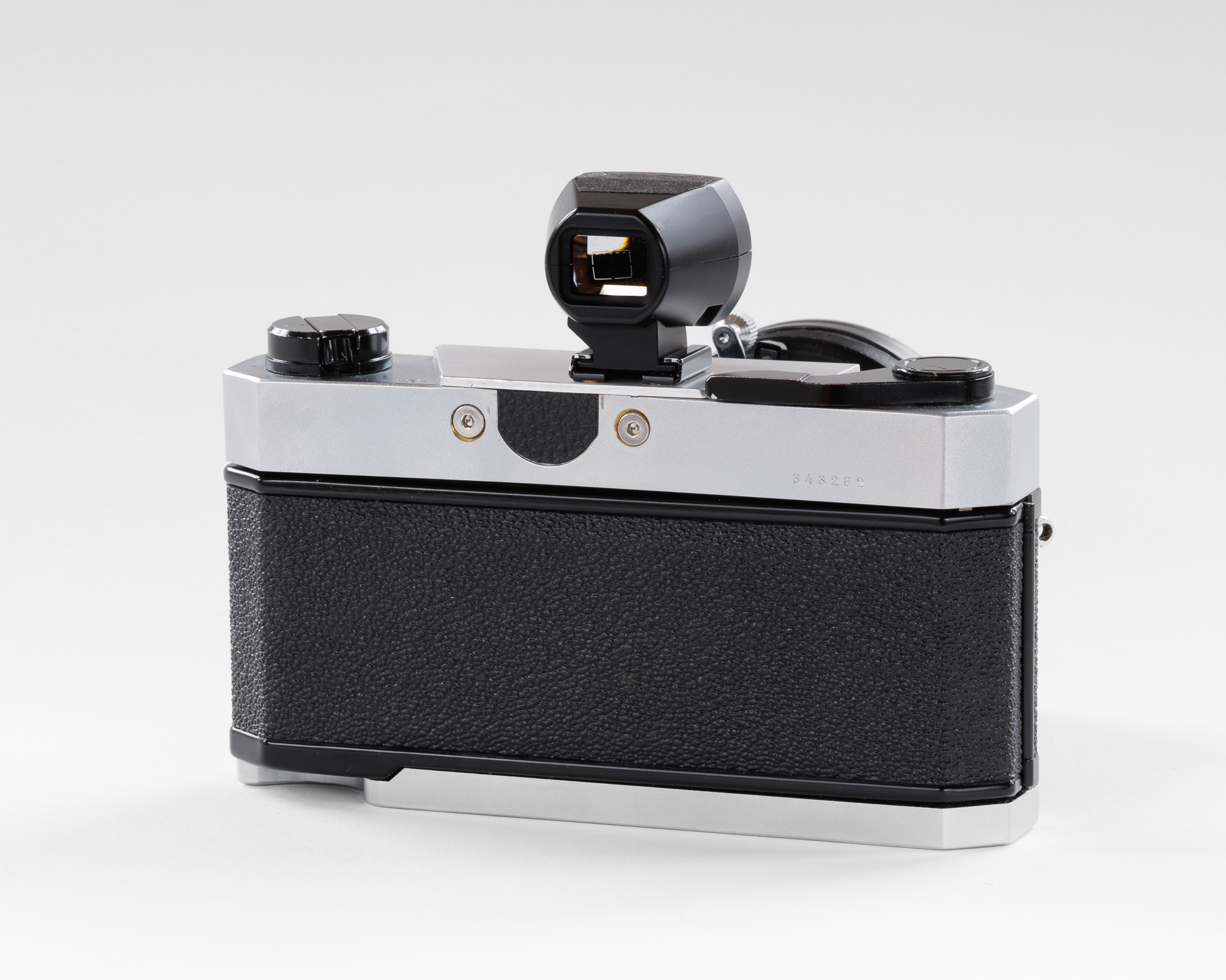

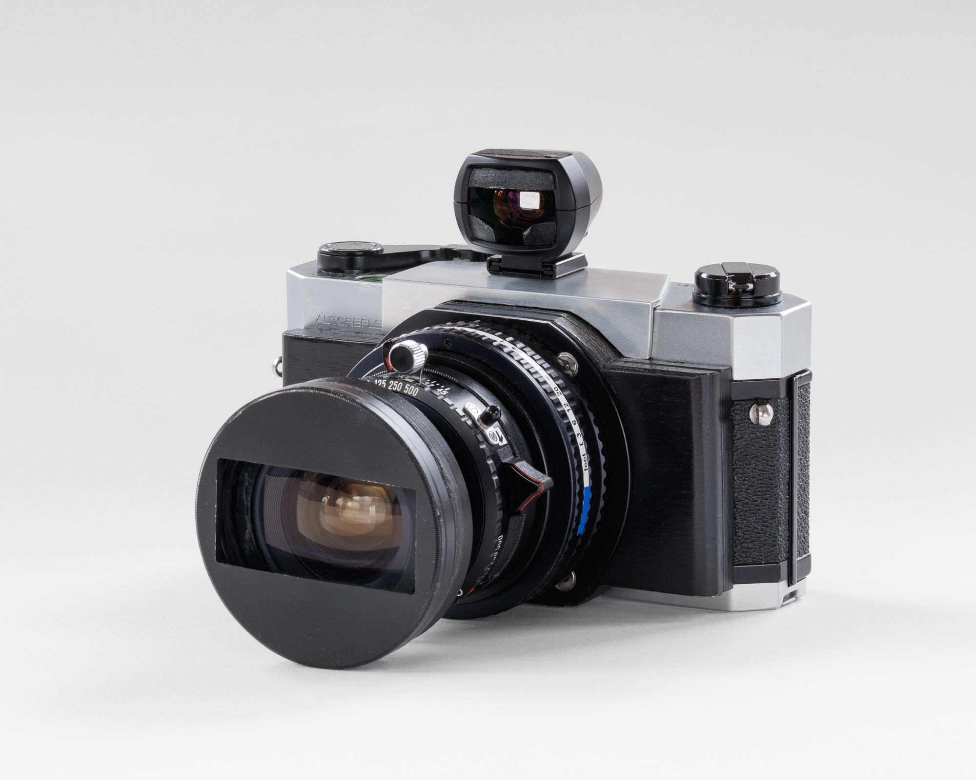

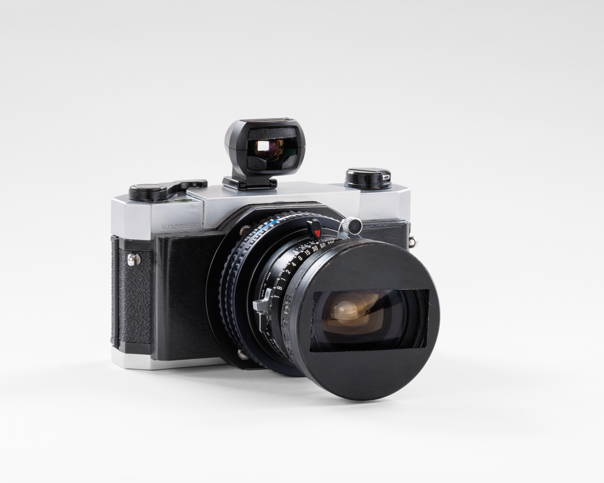

Selling off my personal Konica/Zenza WIDE camera that I made a year or so ago. It gives you eighteen 24x63mm frames on a roll of 36 exposure film by advancing twice for each shot.
It started out as a Konica body that was stripped down and fitted with a 40mm f/4 Zenzanon from the 645 ETRS system. The front and rear lens groups were removed and mounted into a modern Copal 0 shutter that was intended for Nikkor 65mm f/4 lens. It took forever to find an exact Nikkor replacement shutter but now the camera has proper factory f/stops to match the cameras f/4 lens. The shutter was brand new when I bought it several years ago for use in the ZenzaBlad, a different camera project that used the same lens and helical setup. It has very low miles in it.
The camera uses a 21mm Voigtlander finder that has been masked down to match the ratio of the camera. The bottom of the mask is notched out so you can check the focus setting and the approximate f/stop before shooting. It comes in a perfect little padded case from the RICOH GV-1 finder.

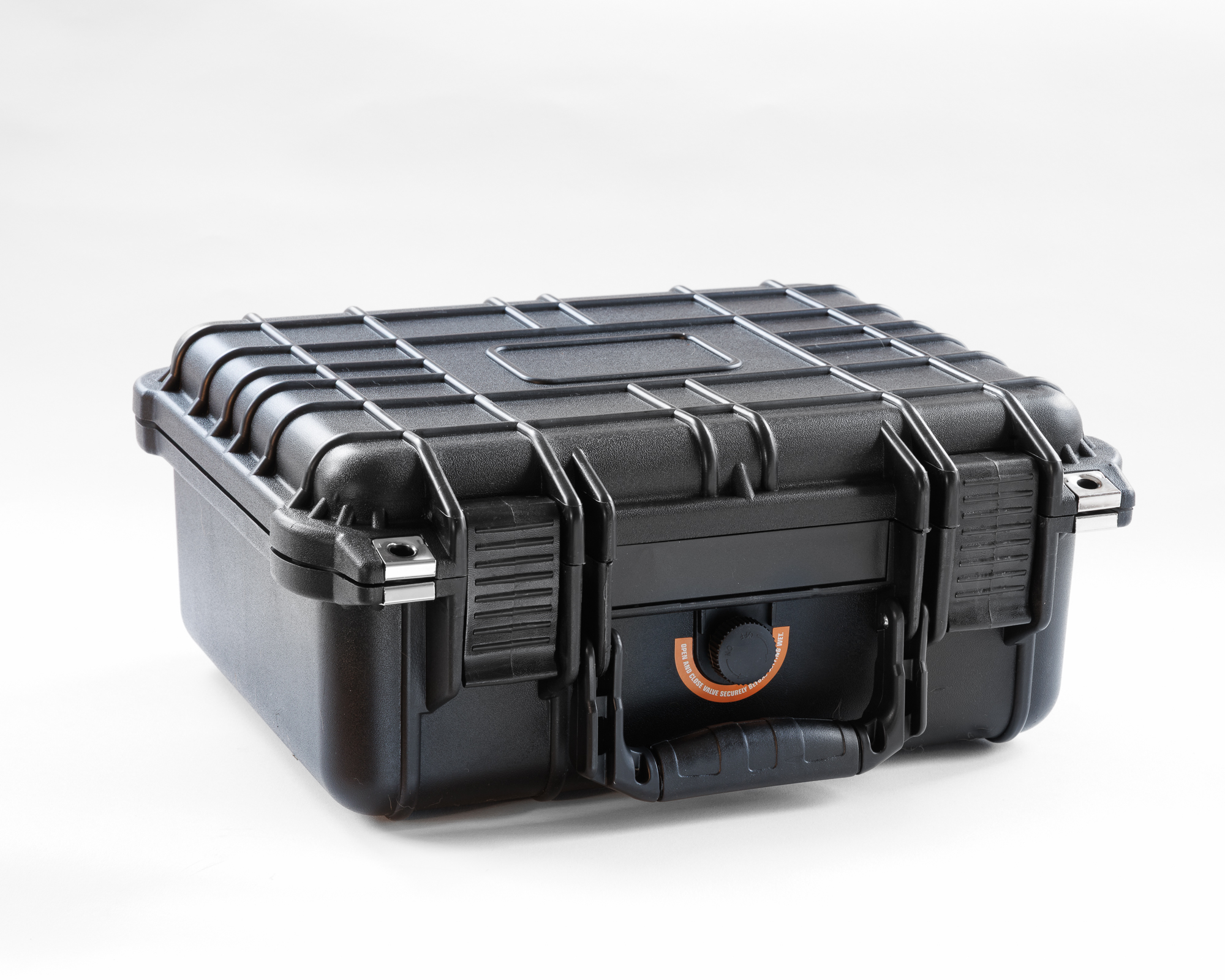

The camera and finder ship in an equipment case that still has room for film, light meter or anything else you want to add.

I'm curious to know which Konica body was the basis for this well executed DYI project?
Thanks for the kind words, the Autoreflex A has a large enough pressure plate to cover the entire film gate after it has been opened up. If you want to check out some of my other cameras, here is a link: https://www.flickr.com/photos/dirkfletcher/albums.
