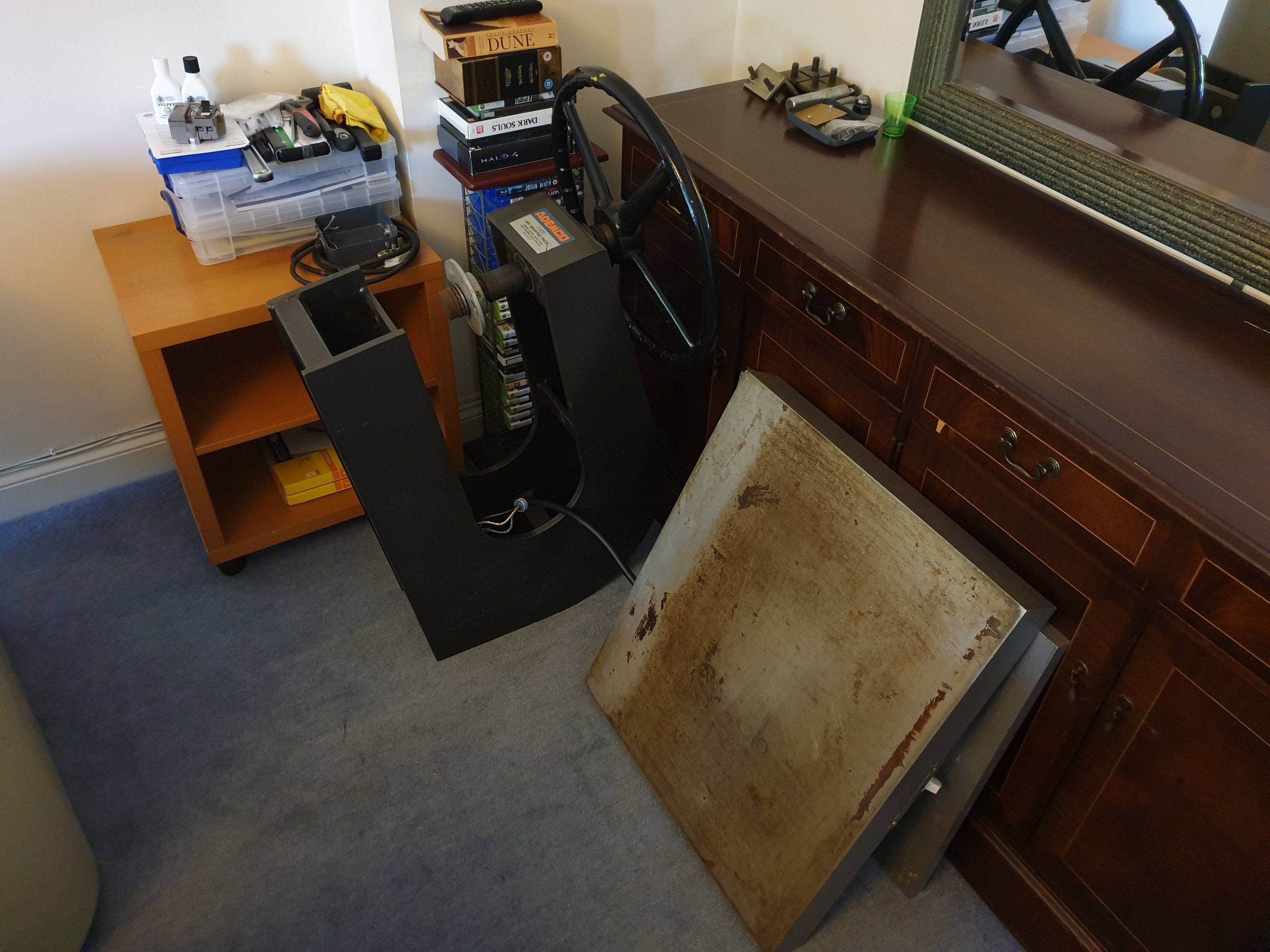

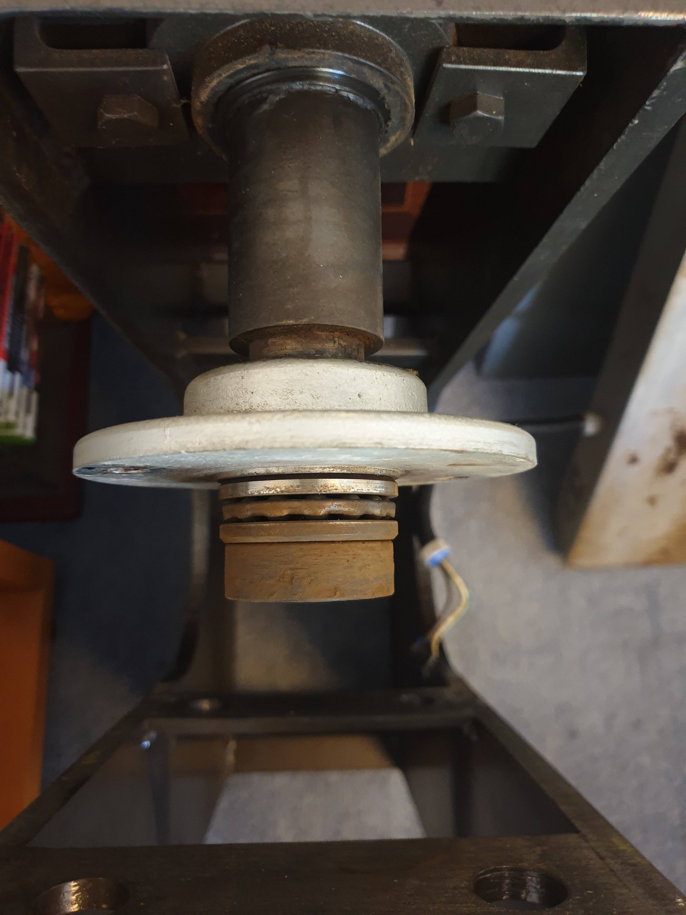

Hi Dahod, I'm in a similar boat now, but with the smaller 2125 model. I'm curios to how you were able to remove the wheel/screw from the main body. Could you please let me know how you went about it? I'm hopeful the steps will work for my machine. (If anyone else has a clue, I would be most appreciative!)
I've stripped my down and have noted a retaining plug which is attached to the bottom of the screw. From what I gather, there is a hex retaining screw which fixes the plug to the bottom of the main screw. If I understand correctly, the removal of this will allow the thrust bearing and cover plate to be removed from the bottom of the main screw. Then it should be a simple task to remove the screw from the top of the main body. In this scenario the hand wheel will still be attached to the screw.

Hi there
I left the feed thread in the body and lowered as much as reasonable for transport but took off the hand wheel. On mine, there was a small aluminum cap covering the centre of the wheel. Popping that off exposed a nut that I could remove to take the handle off.
All the best
