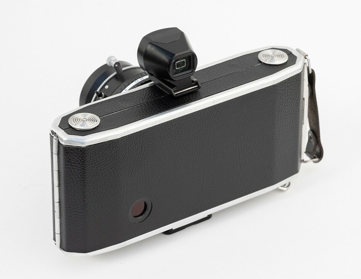

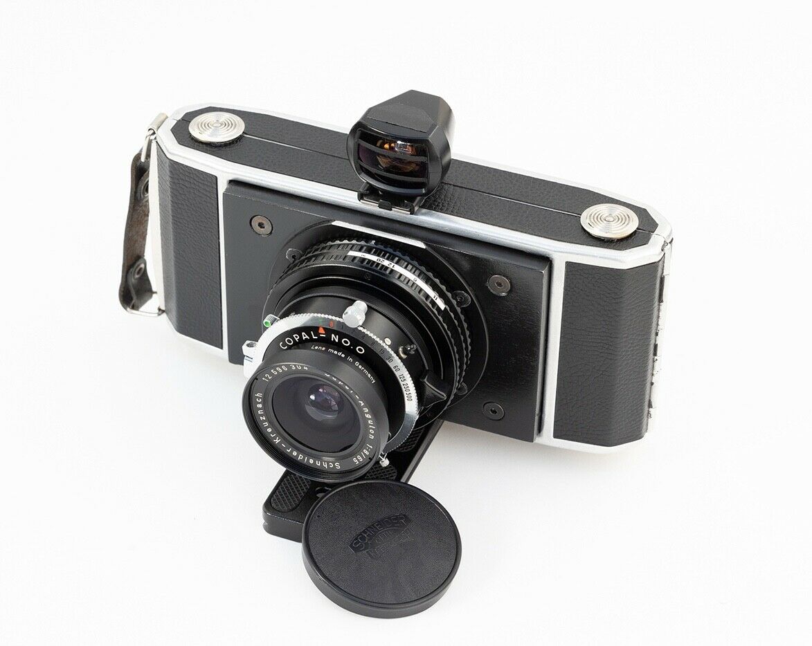

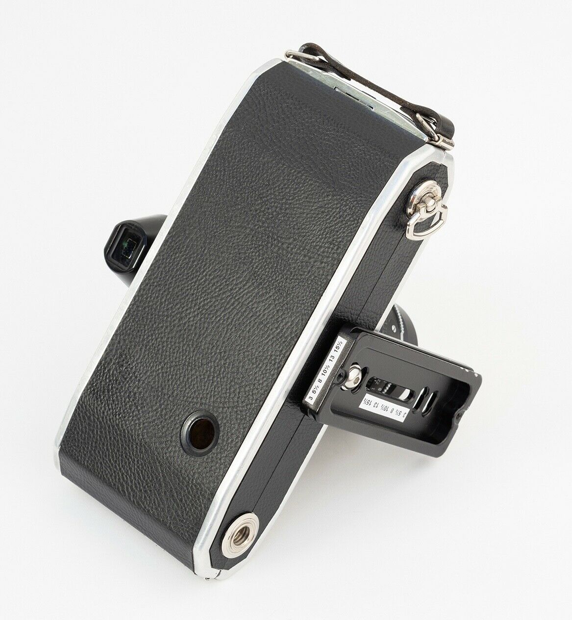

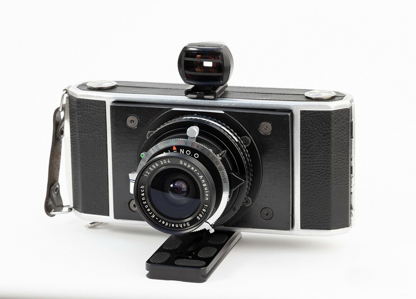

SOLD-Here is a freshly completed 6x12 Zeiss conversion that includes lens and finder and is ready to shoot right out of the box.
I've been building 4x5 and Pano cameras for over ten years and have been making this particular Zeiss conversion since 2016. I'm particularly fond of this camera as its provides a super low cost, ready to shoot 6x12 camera that is durable and built to withstand professional use.
This camera starts out as a vintage Zeiss folder and after my conversion yields six 6x12 frames on a roll of 120 film. OK...technically it shoots 6x11, but it's a fantastic format that is just pano enough for use in just about every situation.
Before building the camera it is stripped down to bare metal, cleaned and recovered with modern, laser cut leather. The focusing helical is indexed for scale focusing (or zone focusing) at infinity, 20 feet, 12 feet and 6 feet and the modern 21mm Voighlander finder has been masked to the same 2:1 ratio the camera shoots.
Unlike custom cameras that use 3D printed parts or complete 3D printed cameras (which do offer a lot of different options) this camera is built to withstand daily usage and regular travel of a working professional photographer. Stainless steel hardware is used throughout the build and during final construction every joint is covered both on top and bottom with a metal epoxy to insure nothing will back out, shift or loosen over time. The wooden front plate is primed, painted and baked to insure a lasting finish.
The only use of 3D printing are the four spindle adapters (that are available here on eBay) that are used to make up the difference in size between the larger 116 spool openings in the camera and the smaller 120 film spools.
