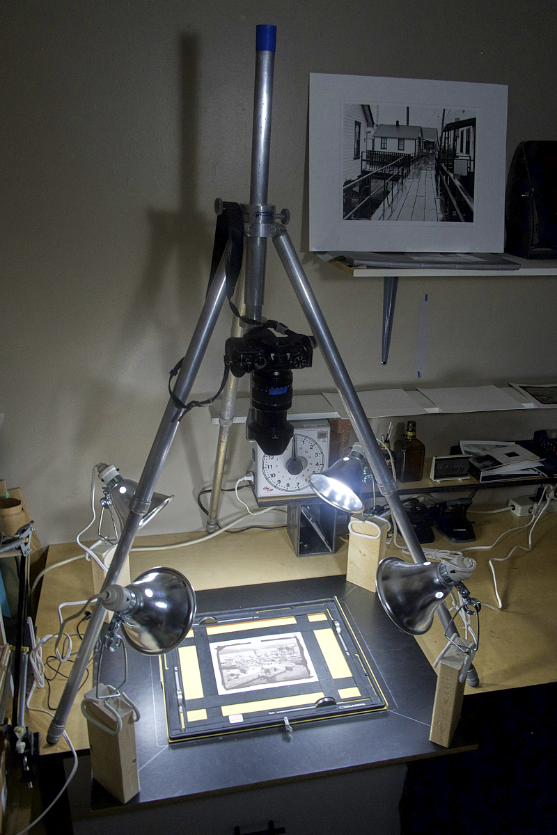

First stage mock up...**in other words**...I know the rig needs a 'tad bit' of refinement.
Exciting stuff, because it means I can take consistent/controllable photos of step wedge prints to enter into Peter Mrhar's EDN (easy digital negatives) system, and can start digitizing 40 years of 4x5's to make digitally enlarged negative for salt prints, maybe kallitypes, and maybe even.....
First try with a gold toned salt print (test print with manual curve) using a Saunders 4 bladed easel to hold the print. Will need a 4 light set up me-thinks, as the corners are a bit darker.
Anybody have a DIY copy stand who wants to share some wisdom?
Yup, 4 lights it is, but the colour temperature cooled off a bit:
For what it’s worth. My tripods were in room that caught fire. Painted Tiltalls and crackled Gitzo suffered no damage, but unpainted aluminum required a bit of cleaning up. Confirms earlier above posts regarding unpainted aluminum vulnerability.
For anybody following along...indents in table top for tripod spikes...almost at a useable stage:
