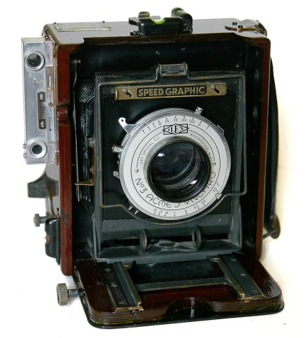

I would love to experiment with front tilt (forward) to achieve a dramatic focus fall off from the face with a portrait, but the Pacemaker Graphic only has back tilt.
I have seen a video of someone reversing the front standard, but I can't remove the screws around the front shutter release.
Another option is apparently is to "drop the bed and correct for the front fall by using front rise. Use front tilt backward to compensate for the maximum tilt obtained by the bed drop."
Has anyone had any experience of doing either of these?

As to the OP's question, yes, you can drop the bed then use the back tilt to control the amount of forward tilt. It's a bit fussy and true view cameras make life much easier for doing that, but it's workable. I did it quite a lot doing some furniture product photography for woodworking friends way back when.
Some people have modded the lens standard by milling the back-tilt slot to allow forward tilt. Guides for doing it are probably around somewhere, but I've not seen it referenced in a very long time.
the pacemakers have a tripod hole on the side of the body as well as the bottom, if you a sure about your tripod and how you mount things, you can side mount the camera, and tilt the tripod head so the camera is basically upside down and do you shift that way. I always use the side mount if it isn't overcast and use the bed as a sunshade ... and when I want to slow the FP shutter down a tiny bit at 1/30th ( working against gravity ). YMMV
If it is only tilt to achieve a tilt shift effect narrowing the focus then the tilt available on the graphic is sufficient. The front tilt leaning forwards is more useful in terms of technical product photography or landscape work in which you want to have focus on both near and far

I reversed the standard on my Pacemaker. You have to shift the front standard a mm or so to one side to slide it back into the body or else it will run into the Kalart side rangefinder cam. The amount of forward tilt you can get is significant. With the standard 135mm press lenses you will run out of image circle in the top corners of your frame before you run out of tilt, and therein lies a problem with reversing the standard. A little front fall to recentre the image circle when tilting would be useful, but it isn’t there this way. Also, reversing is not the way to go if you will be using a wide angle lens with a flange to focal plane distance of more than 90mm (like the modern Super Angulon or Fujinon 90mm lenses) as the standard will sit on the front rails and you can’t drop them. When I had an old Optar 90mm WA it just sat on the very end of the back rails so I could get away with dropping the bed.

turning the camera upside down gives you forward tilt and front fall without all the compromises and hassle of reversing the front standard..

Thank you so much for your replies. I actually didn't realise the camera had a side tripod hole, which saves me the trouble of hunting for an L-bracket for portrait mode shots. I will try shooting the camera upside down to achieve the tilt effect and report back with the results.

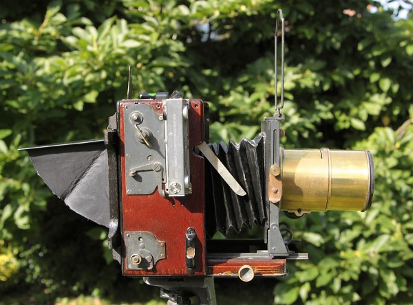

My Pre-Anniversary Speed Graphic was modified from new to be a WA camera.
There's still enough extension to use a 210mm lens and focus for portraits. The front of the body ahs been cut away to allow rise and also use of the wire finder. The rangefinder is for a 90mm lens (approx) I use it with an 8" Petzval and a 14" Dallmeyer telephoto.
Before I replaced the bellows.
