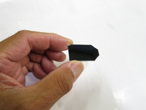

You best hop on this while you can. I happen to know him from buying things from him, and actually sent him a lot of mirrors from my cameras some time ago so he could make them correctly. Otherwise, I have no business connection to him at all, my eBay dealings appear to be a reliable and time tested money losing business :sad:
From the shape of the mirror shown, it is not for the swinging reflex mirror, but the internal one by the poroprism in a Pen F or FV. For an FT, this mirror would need to be partially silvered, or you will loose the meter. See my post at https://kyp.hauslendale.com/classics/forum/messages/2/15109.html?1637223628 for pictures of the FT meter and prism.
Yes, this seller also offers reflex mirrors that I mentioned in my OP, but contrary to his prism (half) mirrors that he offers, his reflex mirrors are made of plastic and in wrong thickness. I ordered a couple from him and even if I could get close to proper distance with his mirror with a help of two layers of thin double sided tape, the flatness of the mirror surface is not really there and focusing is very hard (unreliable). I asked him and he can't supply glass mirrors in 0.85mm thickness. So, he is not really an option for the reflex mirrors for Olympus Pen cameras. I am using his prism mirror in my FT ("upgraded" the semi reflective mirror to the fully reflective mirror).
Thanks for that link! I just placed an order, lets see if that works out...
