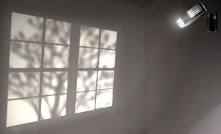

One last thought is what we use on stage – the profile spot. One can add gobo's to them to create patterns of light and shade on a surface ... the lamps can also be de-focussed to take the edge off them (http://www.rosco.com/gobos/). Cheers! :tongue: Sam
And I thought I knew a thing or two about light... Worlds are opening up, thanks guys! Edward Hopper sure made some inspiring works, can look at those pictures of paintings for hours trying to figure out ways to reproduce those atmospheres. Looking at his paintings it becomes obvious how important the interaction between light and color is (just like in Road to perdition) and it's almost always pretty hard light he uses. (with 'softer' colors.) Wouldn't a movie that is like a continuous Hopper painting be great? (Can't you force your director/camera team on a next project Sam:wink:)
