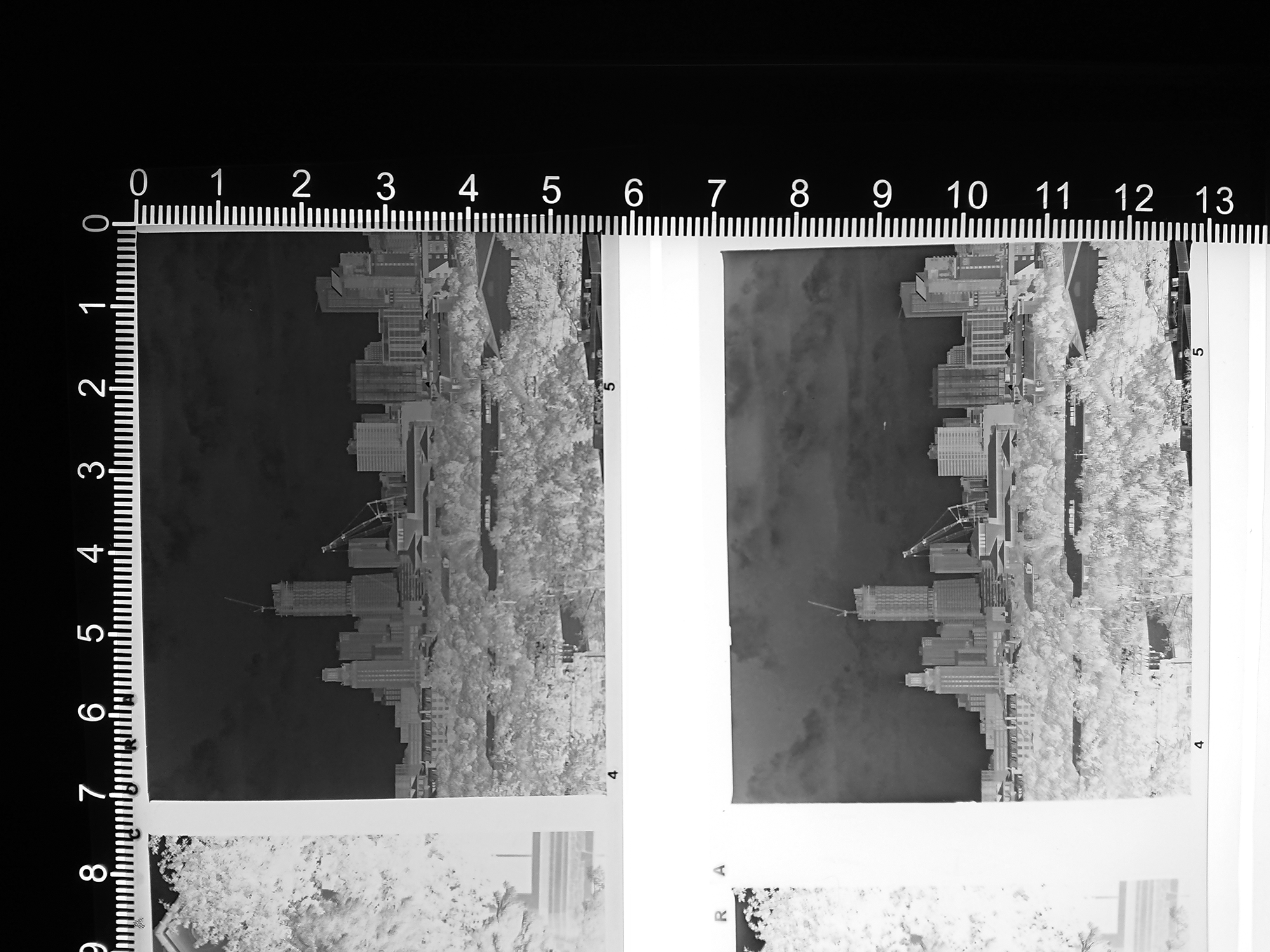

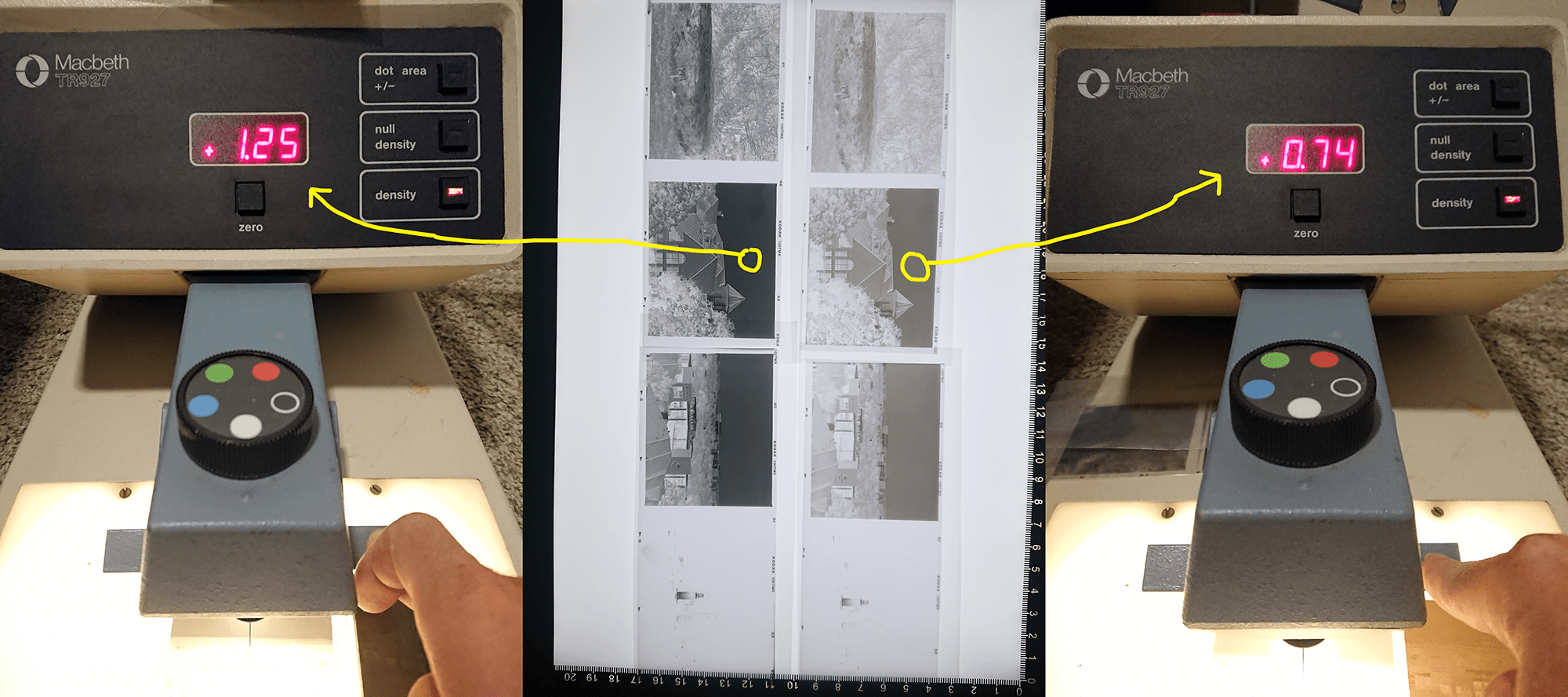

In conducting A/B testing for a book I encountered the following, and was referred to this thread. Known-good HC-110 (left) vs. Fresh Xtol (right). The Xtol was purchased a few months ago, but I don't have the original batch number(s) anymore since it had not occurred to me--in 15 years of using Xtol--that it would ever be a problem.
Both developers were prepared using precision laboratory equipment. All directions were followed precisely.
Scenes were exposed by swapping RB67 backs moments apart, identical settings, and both fresh T-Max 100 rolls were from the same batch. The film was known good.
My original intent was to compare Xtol to Rodinal for an unrelated (resolution) test but after developing the Xtol I was surprised and confused so I sacrificed the second roll into HC-110 as a sanity check.

Was the Xtol diluted? I wonder if more time would have made a difference. If you are doing everything the same as you always have with Xtol and got this I'd say it's time for you to switch to Adox XT-3. I switched and couldn't be more satisfied. Plus, it's easier to mix than Xtol and you can also buy it in 5L or 1L sizes.
Yup. Another example that the supplied times aren’t accurate and that user testing is required to achieve a usable density for darkroom printing. I’ve landed on 13m30s for XTOL 1+1 for 400TX negatives and 12m15s for 320TXP. Both metered at EI 250. But hey, it’s nobody’s fault anymore because nobody knows who’s responsible for accurate data in the data sheet apparently. Just check the massive dev chart 🤣 Welcome to the Wild West!
Yes; 1:1 for single-shot, and I do the same with HC-110 (B). But these are precisely how I've always used these two products. Always the same. I have changed nothing, so either the Xtol data sheet is outdated because the product has been reformulated, or there is a quality control issue.

I swore off Xtol five or six years ago, back when Sino Promise had made a mess of Kodak chemistry. However, I (reluctantly) bought some of the current Xtol made by Photo Systems Inc. with the hope that they had remedied the problems previously experienced.
For the most part I have been pleased with "Xtol 2025" - it performs as I expected, but with one exception: in all recent work with it when developing both TMY and TMX, I was getting underdeveloped negatives. I adjusted development times by adding 25% more time to the listed times (for Xtol 1:1) and now I am getting good looking negs.
Curiously, this underdevelopment issue was only when Xtol was used with the Tmax films. I did not get thin negs when developing Tri-X, FP4 or Adox CHS 100 II with it. Only Tmax films needed adjusted times.
Since this seemed to be a problem only with TMX and TMY, I suspect something has changed in the formula/manufacture of Xtol that specifically affects these specific products, but I can only speculate.

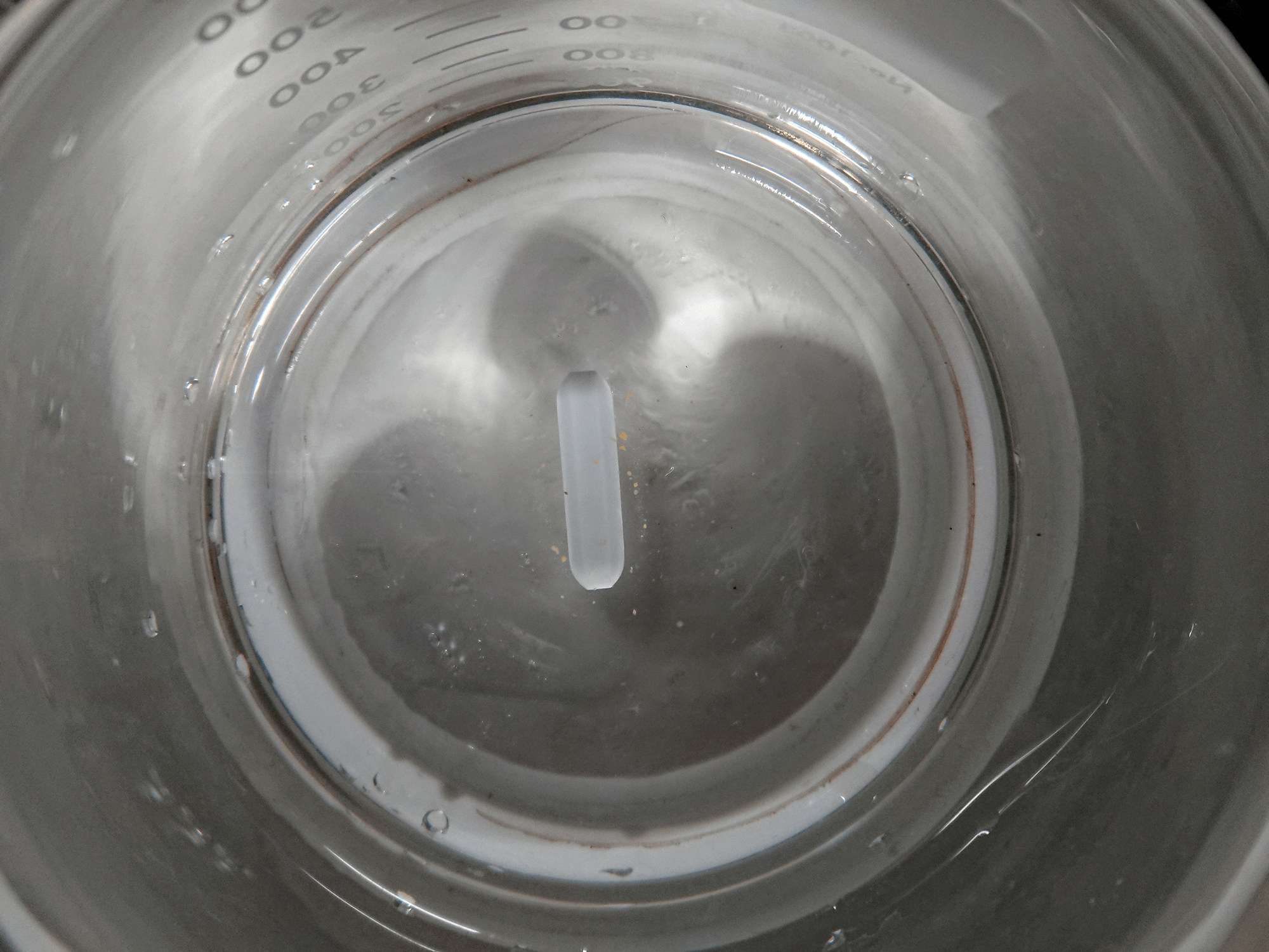

Anecdotally, it seemed harder to dissolve this batch of Xtol than normal. I've never had this issue.
Yes, I noted that as well. I think I will refrain from buying it - yet again.

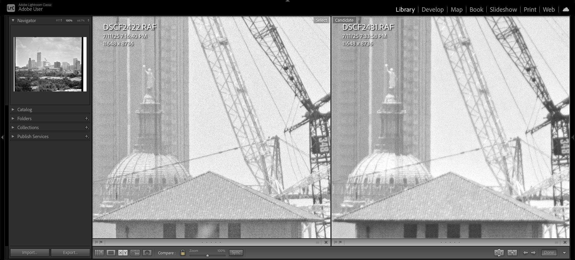

Here is a comparison (Agfa Copex Rapid @ 50, same A/B style exposure) of SPUR Dokuspeed SL-N (left) vs. HC-110 1:240 (right) stand for 1 hour at 23*C, 60s initial ag, 1 inversion every 20 minutes. I made that dilution/recipe up (convenient 10:600mL stock to water for one-shot development). I'm sure it can be further optimized, but density is excellent and comparable to the SPUR developer.
The results are close enough that I wouldn't bother buying SPUR again. (But SPUR does provide a slight edge in resolution, and more importantly better shadow details). Honestly I prefer many of the HC-110 shots. Finer grain. And again it can probably be tuned for better results. This was a first test.
One interesting observation, the SPUR base density is 0.24 while the HC-110 base density is 0.07.
