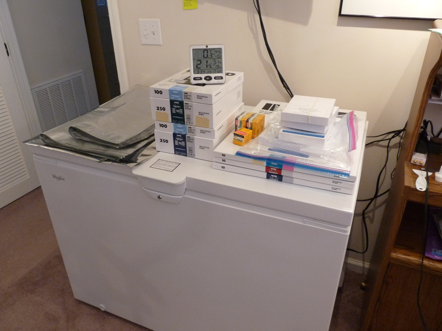

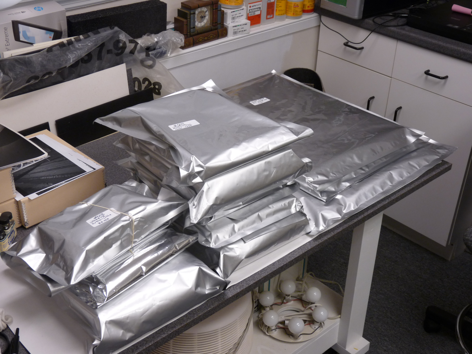

Here are a couple pictures of the freezer and the initial installment of paper. The inventory is larger now because I'm more fearful that Cooltone will be following MGIV into history. I store all the paper flat so the freezer had to be big enough to accommodate 20"x24" boxes.
