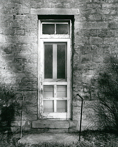

Scans are not very valid for evaluating a paper, but here's one of the prints I've made so far. Contact print form 8x10 negative.
Have not noticed any manufacturing defects/weaknesses. But, this is only one 25 sheet package.
It responds very well to selenium. Drydown is fairly significant so the print needs to be evaluated from dry conditions.
I have not tried yet on a landscape nor on an enlargement. That's next. Ordered some more including grade 2 and 11x14 single weight.
