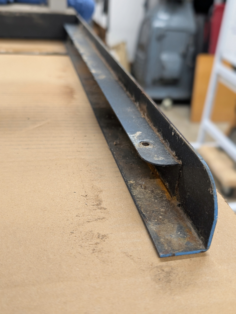

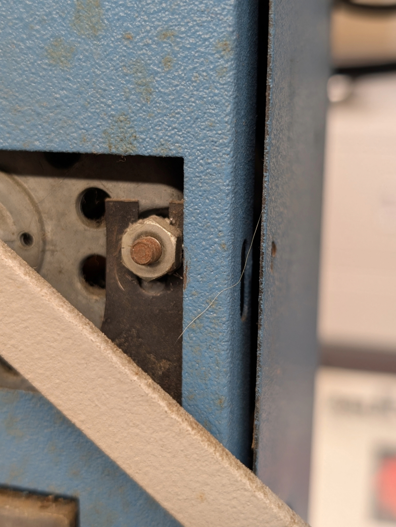

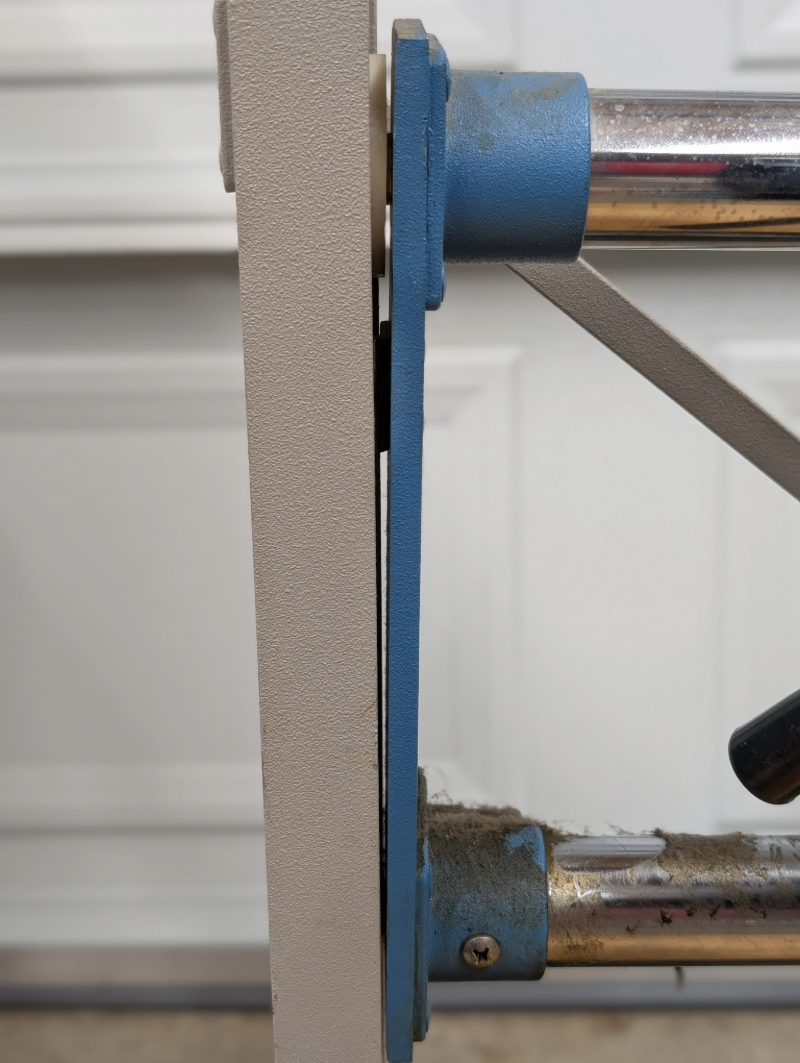

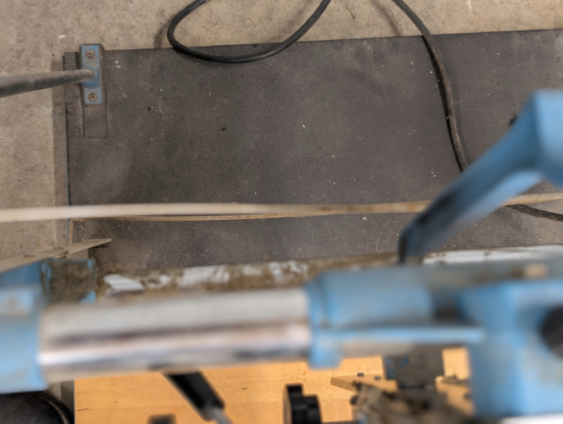

...but as I started looking more carefully, I realized that when I said "perfectly functional Beseler 45" I actually meant "perfectly functional-looking Beseler 45 that is in no way functional in its current state, but which may seem that way when viewed from a middling distance.". Among the absolute litany of problems are...
Pictured: Wracked carriage.
Pictured: Deformed rear X-braces.
Pictured: Missing and/or rusted fasteners.
Pictured: Depressingly-mangled mounting tabs.
Pictured: Bent limit stops.
Pictured: Rust-flavored cobweb-lint.
...and many, many more small issues.

  • The chassis has likely been dropped or hit: the twisted x-braces, bent lower rails, bent limit stops, loose rear braces, wracked carriage and other areas of destruction all point towards some kind of impact. It's all fixable, but the heavier bits are gonna take some serious work.
  • The motor and elevation system is working, but someone's been into it: the cover/housing is missing fasteners, the motor mounting tabs are bent, the wiring was jammed into place strangely, and the belt tension is off. I think this is a replacement motor that was installed by someone that didn't know what they were doing. Again, fixable, but not really my idea of a fun Saturday.

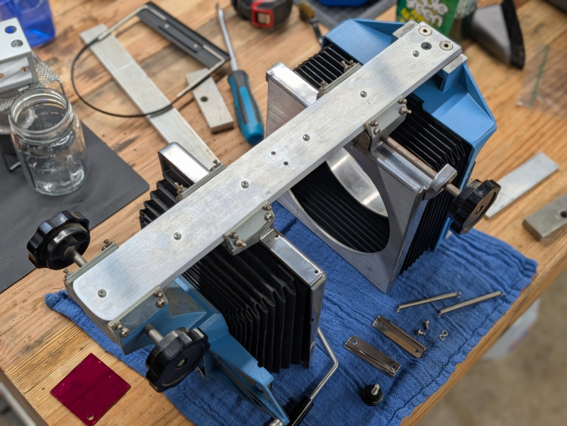

  • The condenser head is in good shape; both lenses are intact, the heat-absorbing glass is intact, and I'm reasonably sure it's seen little use. There's some paint scarring on the exterior, but that's the worst of it.
  • The Aristo head that came with the enlarger is in decent shape. It has an older W-series bulb in it, and it doesn't have the Zone VI photodiode mod, but I can remedy those issues.

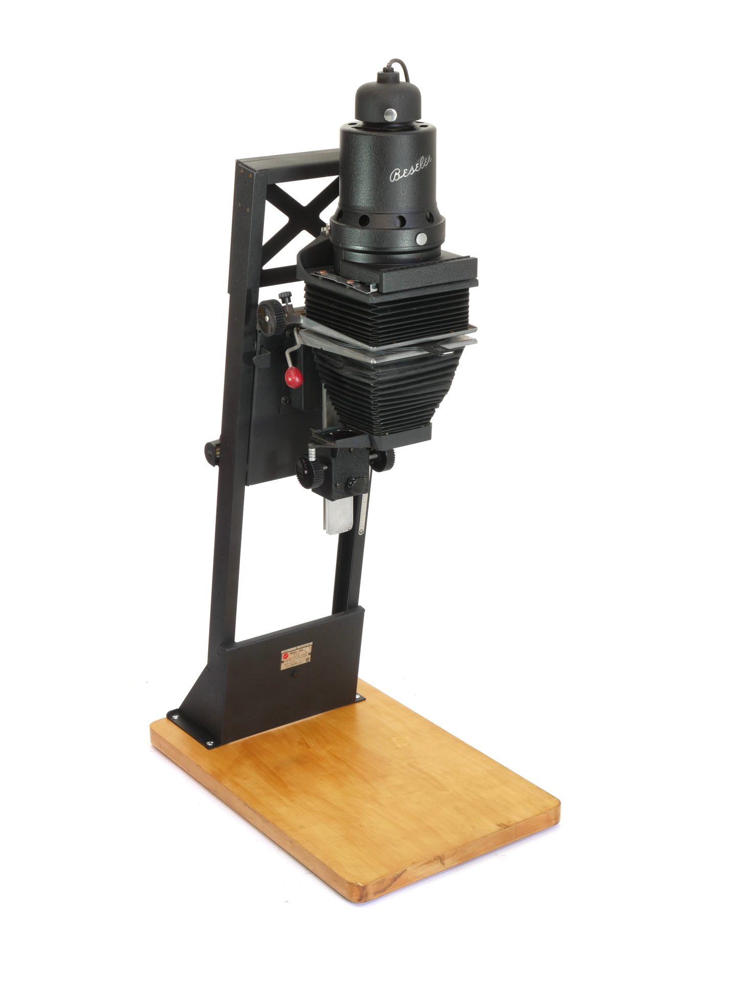

That's a very bad image, but it's one of the only ones out there...and if it wasn't for the telltale 45 features - solid/geared lens stage, overall size of the head, etc. - it would easily pass for a 23C of some provenance or other. But, it proves one thing: an extra-big-ass 45 head can, in fact, fit on a smaller inclined-rail chassis...and the 23C-series fits that description.
Key takeaways from the above image, which I need to consider:
  • A rear elevation mechanism is present, which implies that the same kind of mechanism on the 23C-series is a workable option. Counterbalance springs may or may not be different.
  • The baseboard support is substantially larger than those found on the 23C frames; this may need to be addressed, depending on how much the assembled 45 head actually weighs when it's all said and done.
  • The baseboard itself is similar to the stock 23 baseboard in both length and width, which makes sense: the 45H was supposed to be a compact unit, overall.
  • There's a very substantial upper brace/reinforcement on the back of the chassis rails, which is entirely absent on any of the 23C-series frames that I've seen in the past. From this side of the screen, it looks even stronger and more effective than the method used on the CB7, which has a substantial chassis of its own.
  • The height of the rails/chassis looks to be in the neighborhood of 36". I arrived at that number by comparing the measured height of a fully-assembled 45 condenser head/negative/lens stage (~29") with the scale of those parts as shown in the above image, and then referenced them to the rails: answer, 36"-ish, checked about three different ways.
  • Because of how the bracing and elevation mechanisms are depicted, we can infer that the head assembly on the 45H doesn't go very far up the column; the upper 25% is off limits...as is the lower 25%. All told, there's probably about 20" to 21" of head travel, which would be similar to the 22.5" available on the 45MCRX that's now lying in pieces in my garage.

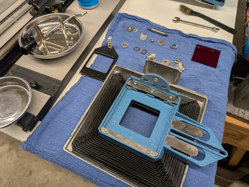

Meanwhile...

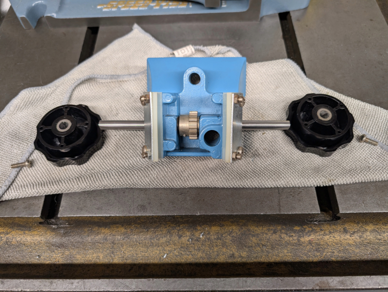

Pictured: "He's dead, Jim."

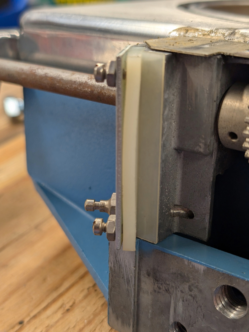

Head is off, springs and negative stage lever-dingus are removed, etc. It's actually in very good shape, as I suspected. The shaft for the upper negative stage adjustment gear looks a bit shabby...
Pictured: Could be worse.

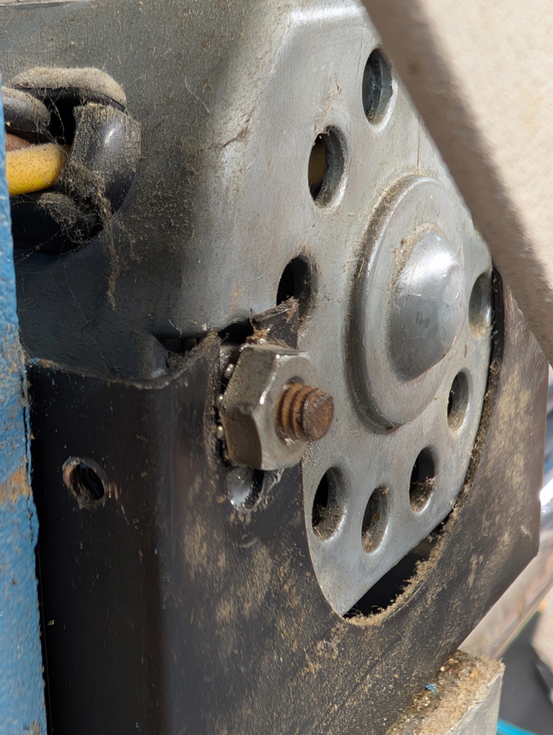

...but aside from that, it's not bad. There's a ton of some kind of dried oil on things, so I'll be at it with degreaser and a brass brush for a bit, but I think there's minimal work to do, here.

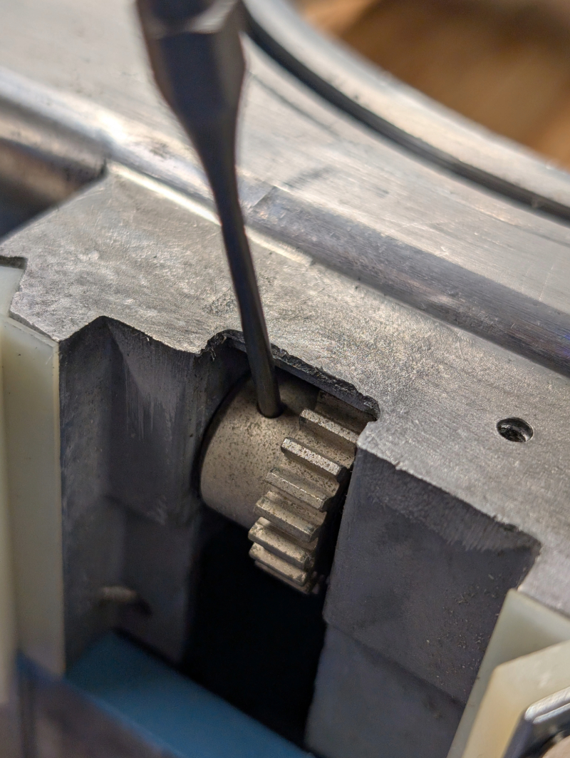

Pictured: Tonight's Fun.

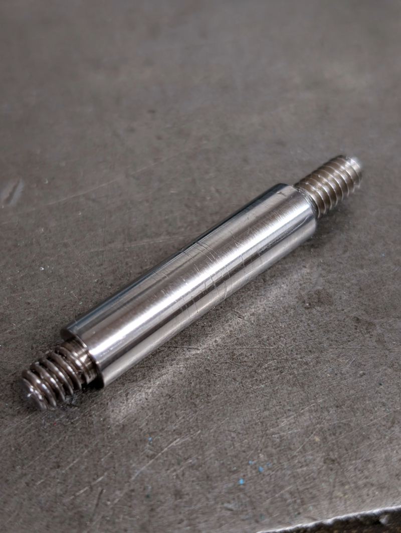

That's the shouldered pivot stud for the lens stage, and that nut did not want to come off; a drop of oil, a torch and an impact wrench finally got it loose. More coverage tomorrow. 👍

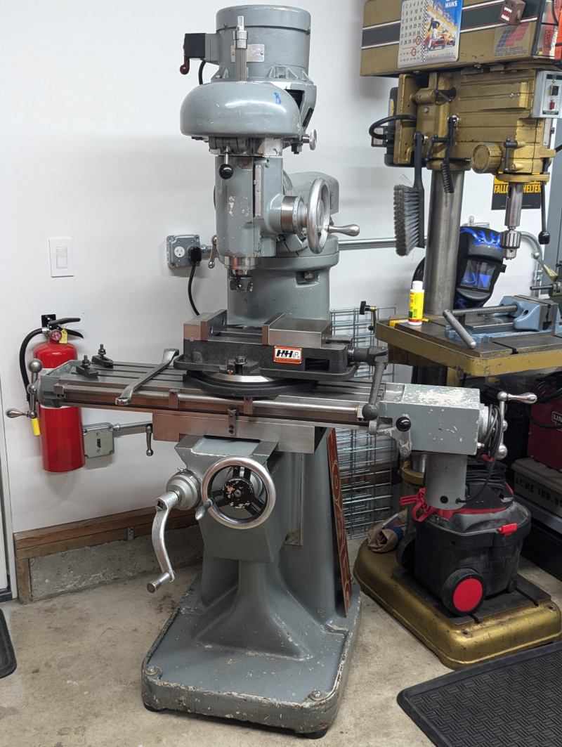

OT but nice to see a Burke Millrite in a well-lit shop.
I would say you have the makings of a nice enlarger, nothing to daunting and so far all looks addressable.

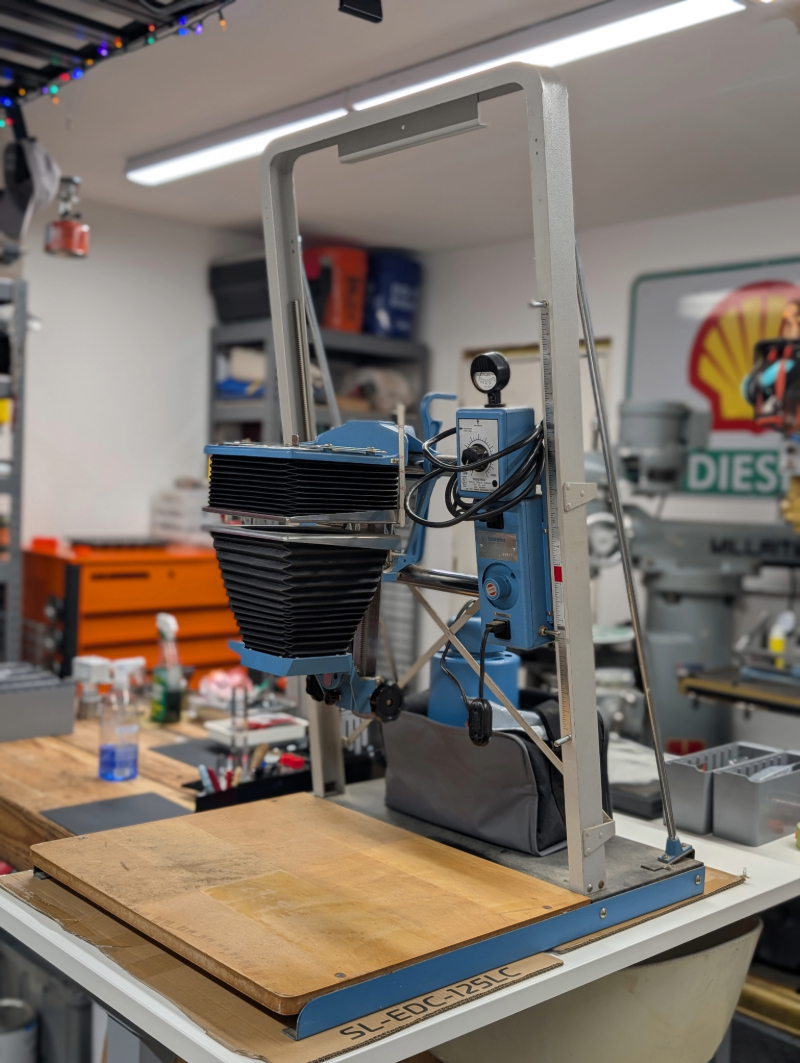

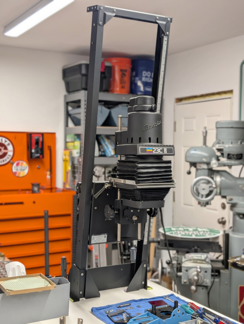

When I was looking for a 4x5 enlarger, the 45MXT was on my short list. In the end I ended up with a D5 and a D5500. I had to do a lot of repair on the D5500, but I find that kind of stuff fun.
I enjoy it as well, and I also enjoy solving problems; mostly, I solve the ones that I blithely create for myself when I hop down mental rabbit trails like the one detailed above. In this case, I realized that I definitely need the ability to enlarge 4x5, but I don't exactly want the physical size of the typical Beseler 4x5 enlarger; it may not seem so, but those are two very different parts of the equation.
That was a total rebuild as well. It came out of a workshop about five hours away, and even though it needed some work, the important parts were still in really good shape. I thought about doing a complete resto on it, but 1) I'm lazy, and B) I rather enjoyed the cosmetic scars on the finish: they tell a story, and I didn't want to take that away.
Pictured: Battered, but happy.

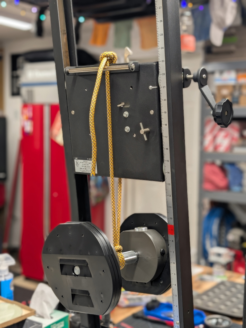

The mechanical scars were a different story: those, I fixed. This machine was evidently once owned by the same chimp that owned the 45 I'm dissecting, which - and this is another parallel - was not the person from which I purchased the machine. I'm at least the third owner of each machine, and each was in a rather abashed state by the time it came into the possession of the person from whom I bought it. Compared to the condition of the Burke, however, the Beseler looked new; that mill was in bad shape.

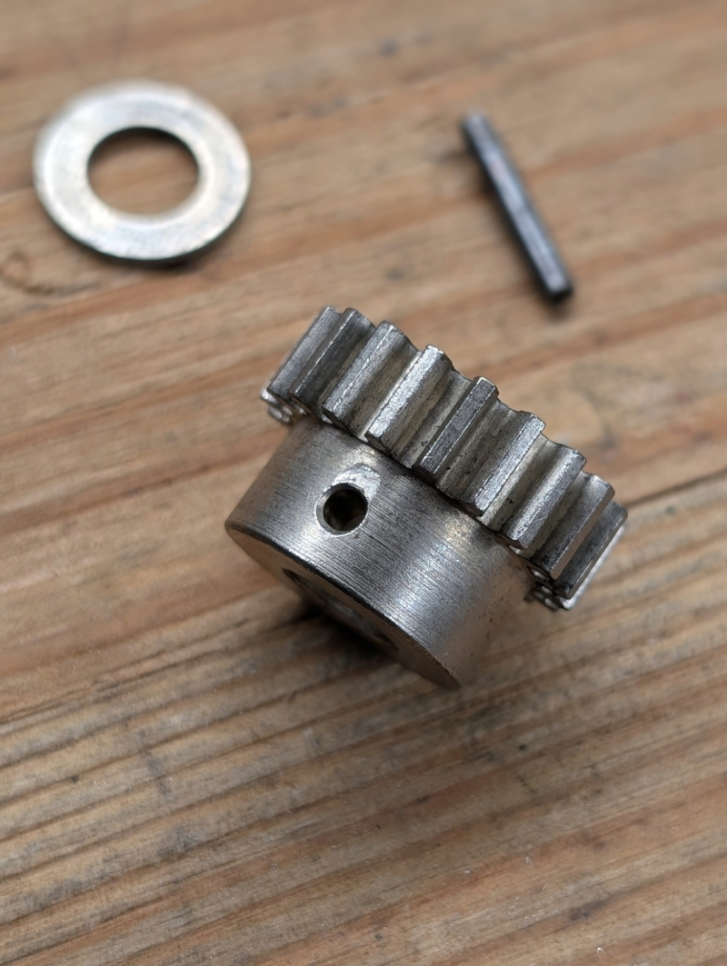

Moving back to the 45 for a minute: something that wasn't in bad shape were the factory nylon bushings on the negative and lens stages; this makes me happy because now I don't have to make new ones.
Pictured: Yay, laziness!
Granted, I've considered making new ones anyway because I've never generated/printed a shape like that - or worked with nylon in my printer, come to think of it 🤔 - but that's extra work, and extra work is the type of work to which I'm the most allergic.

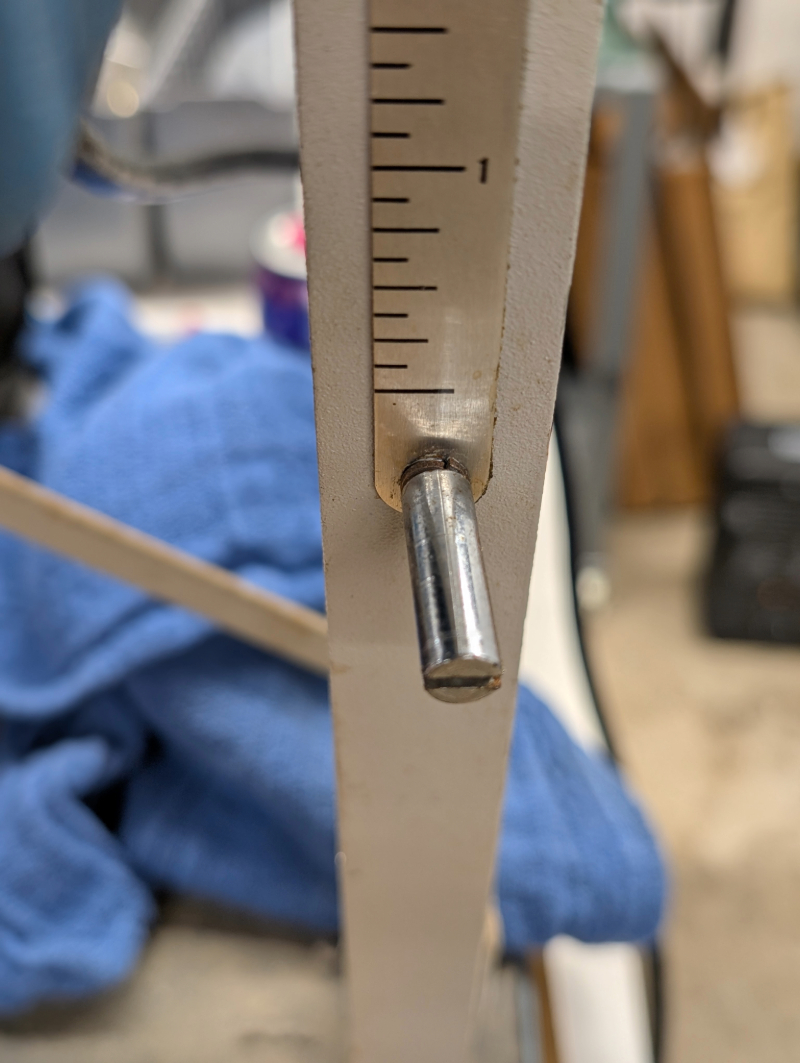

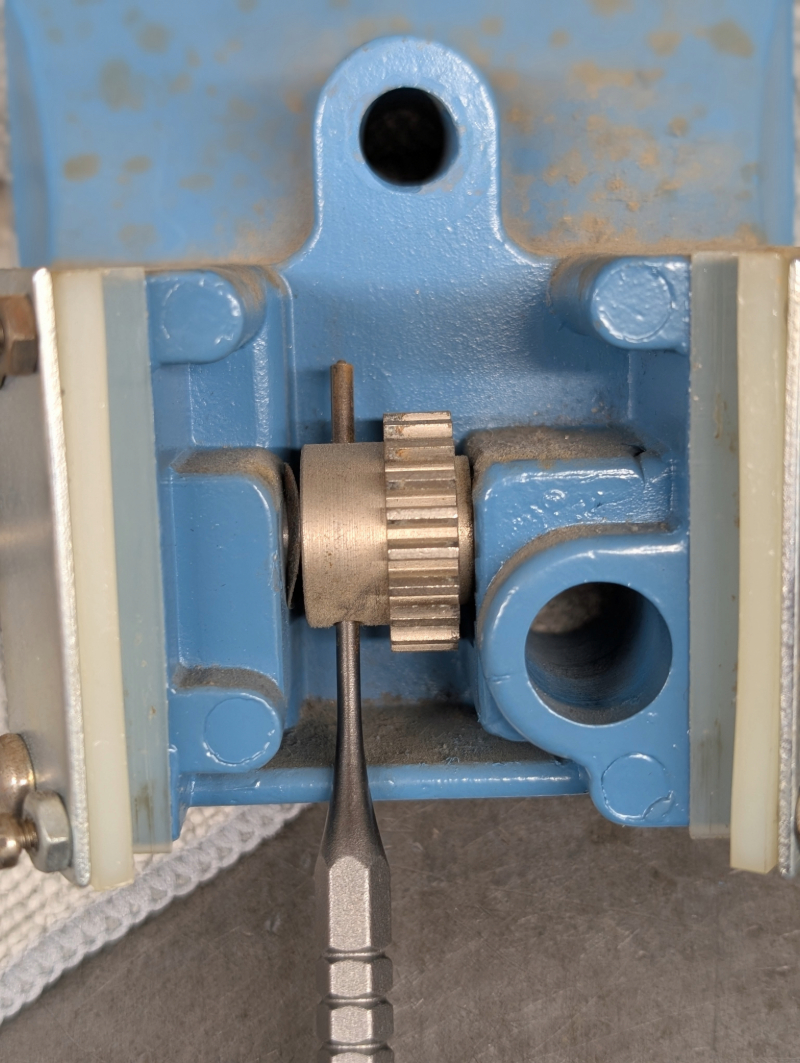

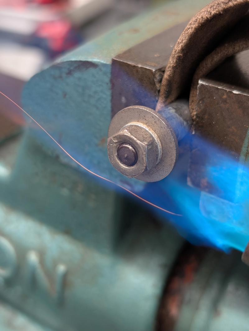

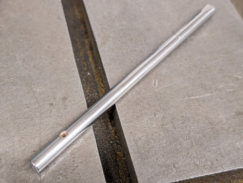

Fun Fact: I'm also allergic to roll pins, and when I say that, I actually mean "I just really, really, REALLY hate those stupid things." They seem to always pein over at one end or the other, even if you use a proper roll pin punch...
Pictured: Seen here.
...and even if you take the time to flatten and lightly taper the ends so that they don't pein/distort/bend/bind/whatever. I seriously thought about taking a small taper pin reamer to this gear and shaft, just to avoid dealing with the roll pin when I have to take this thing apart again...and taking it all apart again is likely to happen, because of one critically-important reason:

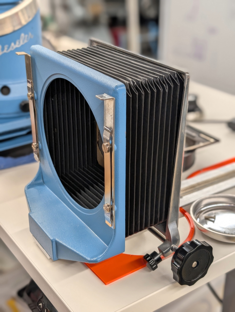

I don't really like this blue color.
Okay, before anyone starts: I know that the Beseler blue color is classic and fun, but I really just don't like it as a primary color. As an accent, yes: it's fine...but not as the main color. It's just too much...so if I can get this entire thing working - and that's an "if" of approximately the same size as the defense budget of Moldova - I'm going to pull all of the blue parts back out and repaint them in black to match the 23 chassis.

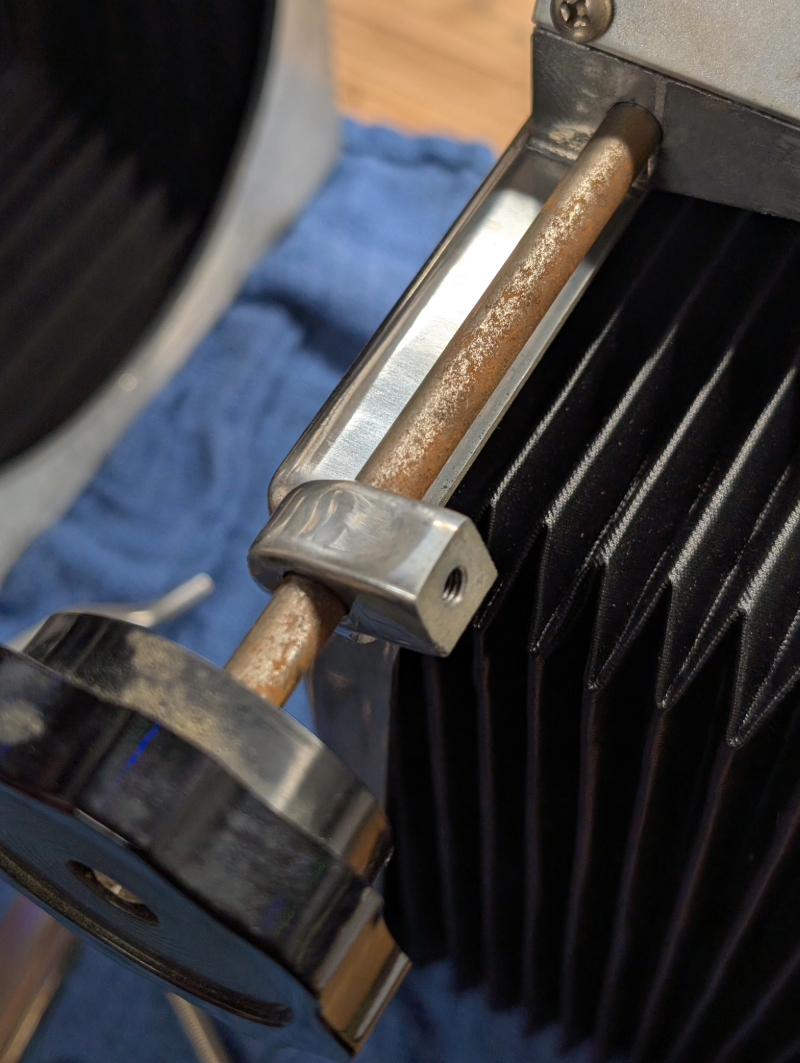

Thus, the question of the taper pin reamer arose... but since I don't have a reamer of that size, it doesn't matter. I can always modify it later, if need be.
Pictured: Need.
Well, there's the reason the roll pin wss difficult to remove from one direction and impossible from the other: a tiny little deformation on the gear surface. Looks like a bad punch strike, to me; it's not much, but it's more than enough...so, it looks like I'll be going over to Tacoma Screw tomorrow to pick up a reamer. While I'm there, I'll grab some additional 800-grit sandpaper, because I used the last of it to help polish out this shaft.
Pictured: Shiny.
That's looking a lot better than it did when it came out, but it's still bare steel; I'll have to come up with a solution for that. Both this and the other adjustment shaft are some of the few parts that didn't get Beseler's industrial chrome or nickel finishes over the bare metal. I guess I could nickel-plate them; I've been wanting to try that out...but I may do some cold-blueing and just call it good.

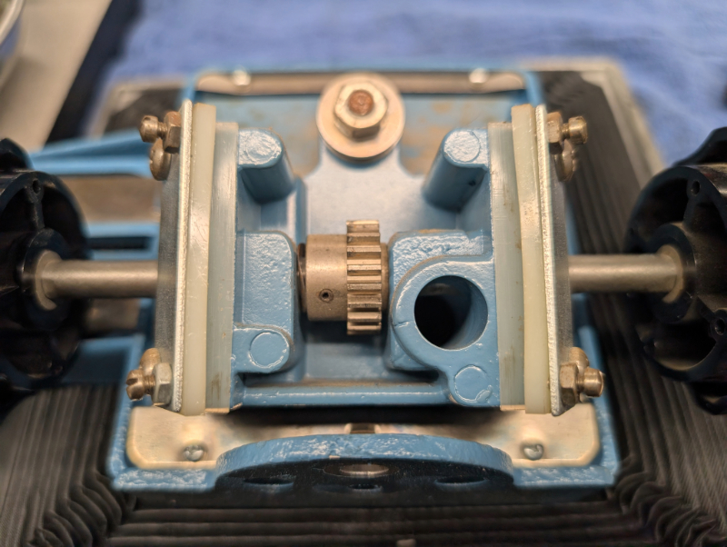

Well, I did make a bit more progress, but while investigating the 45's condenser head I suddenly found myself sidetracked by the idea of making a few dedicated filter holders for it. A few minutes later I realized that six hours had passed...so I didn't get much done on any other part of the project. But I did manage a working prototype of the holder, so that was good.
Tomorrow, I shall do better! And I say that in full intent of actually doing so, and with knowledge that I likely will get just as sidetracked as today...but at least I'll be making progress on something.

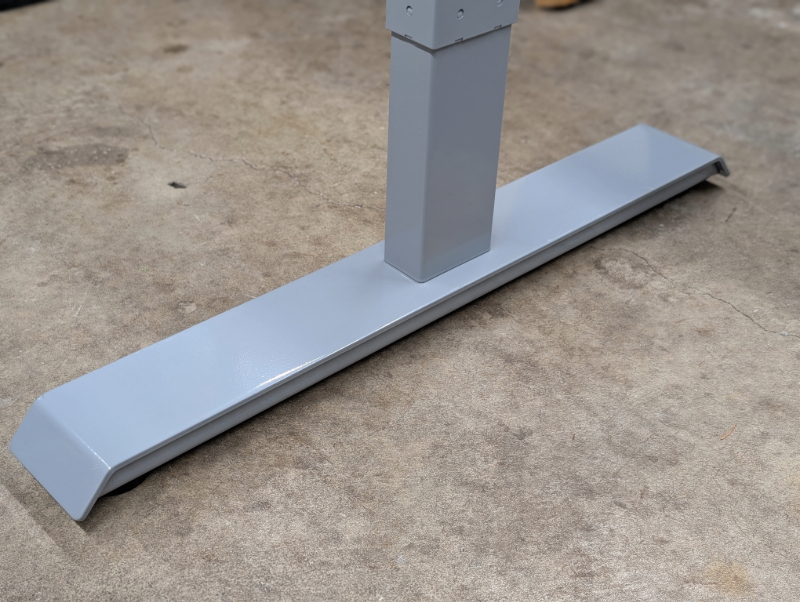

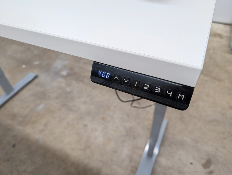

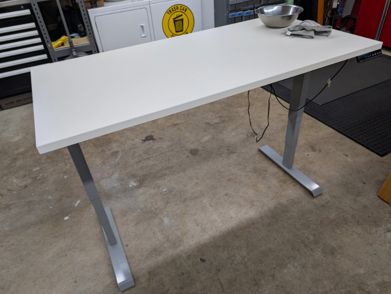

At that point I started planning a movable stand that would be height-adjustable for different users...and let me tell you: in the last couple of years I've had a LOT of ideas about exactly what that concept entails. Adjustable-top workbenches, wall-mounted constructions made from 8020 extrusions, a tabletop platform held steady by a quartet of enthralled gnomes: basically, all the common solutions. Eventually, I hit upon a possible solution: an adjustable-height standing desk.
Now, before anyone objects: I know there are problems with this solution. Specifically: most standing desks are of lighter construction, not deep enough to handle sizable easels, and usually somewhat unfriendly to a darkroom in terms of materials and design...and all of that makes perfect sense because most standing desks are intended to be trendy and useful in a home office. Finding one of the correct size, shape, construction and capacity is extremely difficult.
Pictured: Except that it isn't.

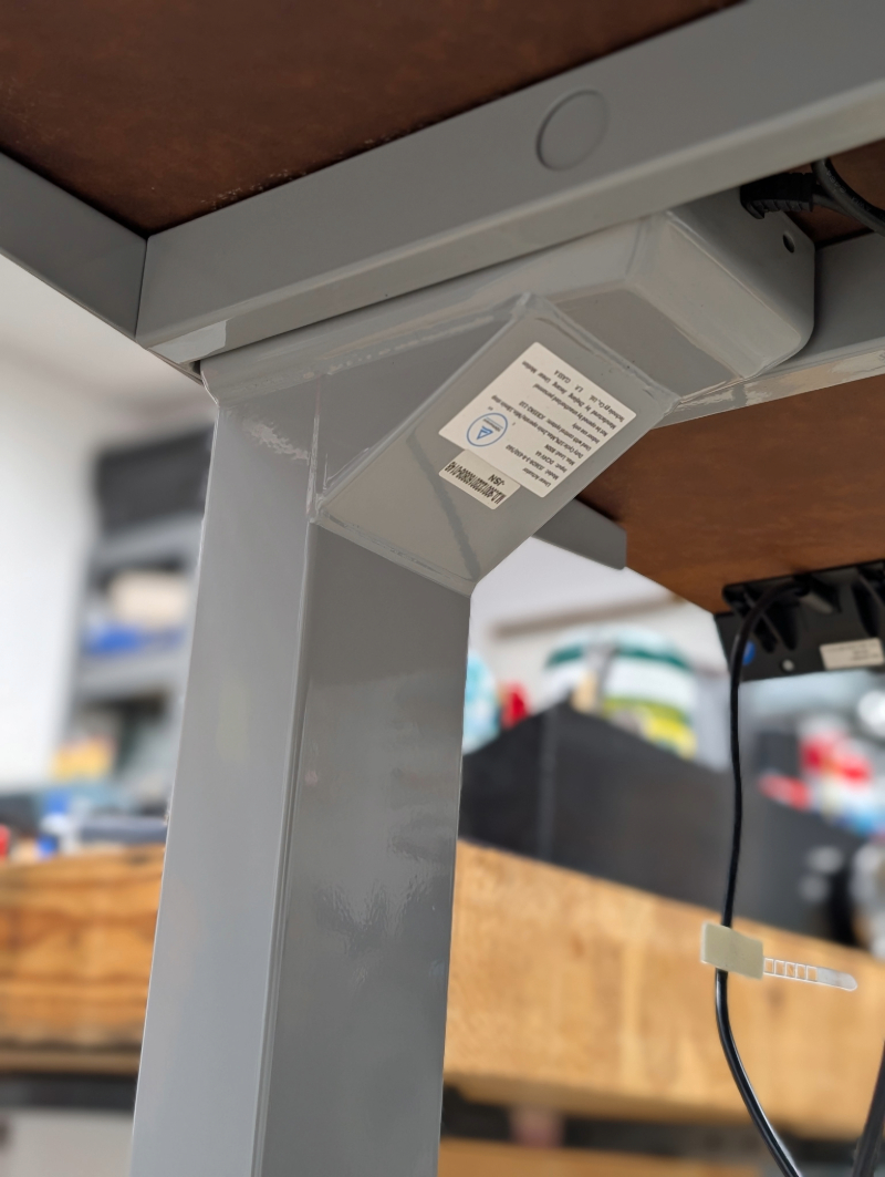

That, amazingly enough, is exactly what I was looking for...and it wasn't even hard to find once I knew what I needed: it's a commercial desk. I found it at a secondhand furniture store that had an office-equipment section. It's 58" by 29", with a 30mm-thick melamine/MDO top and 1mm poly edgebanding, and it has one of the heaviest leg sets I've ever seen in a desk.
Pictured: I have axles with less gusseting than this.
The legs and frame are all 12-gauge powdercoated steel, and the foot sections and other braces are just ridiculous: they're 5-gauge, formed on a press brake.
Pictured: Beef.
Controls are pretty simple: a single power unit supplies a motor and actuator in each leg, synchronized to both sides and controlled through a basic touch pad. Up, down, four memory pre-sets, and infinite adjustment through the height range; it'll drop to 24.5" at the lowest, and it will raise to 50".
Pictured: Wasn't that height the problem that started all of this nonsense?
That, Dear Reader, is a better solution to a movable-height enlarging stand than I could ever hope to design and build in a home shop; it was also significantly cheaper. My plan is to wall-mount the two enlargers - along with the majority of their power sources - and only use the desk/table as a base for the easels, timer and tools. The wall-mount will definitely limit the upward travel of the work surface, so I'll mount the enlargers at the absolute maximum working height - probably around 41" off the floor - and let that be the upper limit. The lower limit will be set by whatever storage solution we place beneath it; probably a file cabinet that holds working prints, or a small-sized dorm fridge that functions as a paper safe, or a combination of both. Vertical rigidity is pretty good on this desk, so I don't have to worry about that, and I'm working on a simple solution for locking it to the wall at any given height; once that's sorted out, there's not much to build.
So, yeah, I guess that it's actually a modular drop-table setup, in the end. Hopefully it'll work well.

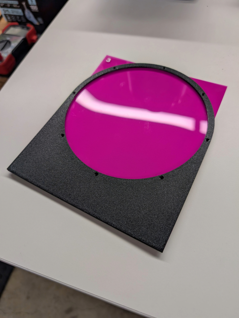

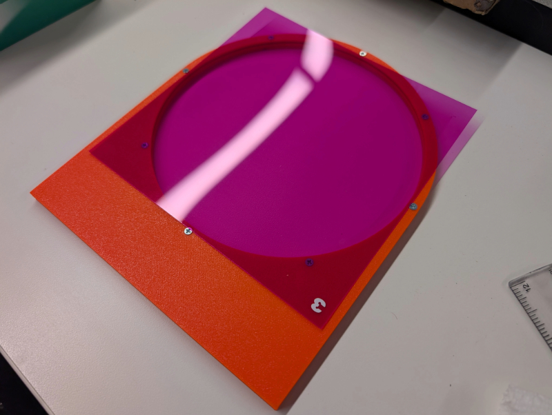

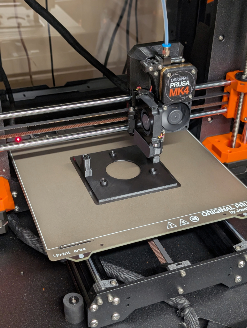

Second Example: I'm working on 3D-printing some small parts - a set of filter holders, some adjustable lens boards, etc. - and I'm using those as a material test for larger things, such as the pieces that will mount the 45 head to the 23 column. The designs are evolving nicely, but I'm not sure what the final material and process will be.

Also, I meant to do a bit of catch-up posting on the cleanup of the 45 head, but things have been insane at the house in the last few days: my partner went to work on Friday morning and learned - along with 800 other people - that her company had sold her entire division to a competitor. So, that was a bit of a massive shakeup...but regardless: things have been happening with Frankenlarger. I pulled the lens stage apart and was happy to find that it was in good shape as well.
Pictured: It's not so terrible.
Next, I got to deal with yet another roll pin...and seriously, I hate these things. That being said, this roll pin is at least of a standard size: 3/32", to be exact...which is only standard for the US and Liberia, I think.
Pictured: And for whatever Burma is, now.
The careful observer will note that the weird double-shouldered-pivot-stud-dingus is removed in that previous picture...and that's because it was clamped in a vise and cooling down when I took this picture. I threw in a shot of a torch flame on a nut a few posts back, and as I said then: that nut did NOT want to come off...and even though I used a leather strap as a protective surface between the stud and the vise jaws, there were still a few small scratches and mars left on it when I was done removing the nut.
Pictured: So I went ahead and fixed those.
Beseler machined these things pretty well, but they didn't do a lot of work on the surface finish: I think they got it good enough for their hard-chroming or nickeling processes, and stopped there...so there's no point in getting it to being flawless. Clean and shiny, sure; a mirror polish is another thing entirely, though...and a totally-pointless thing on a part that basically won't be seen. So yeah: this is good enough.
I didn't find anything wrong with the rest of this part of the negative stage, so I basically just cleaned the surface of the adjustment shaft, got all the grime off of the paint, and then cleaned up the all of the little fasteners and specialty bolts and screws. I'd love to have a small tumbler for that kind of thing - and an ultrasonic for dirt removal, too - but I think I did well enough, regardless.
Pictured: I just really hate that color, though...
Also, those adjustment knobs look almost brand-new...but anyways: after all that was done I got all my parts organized and started to look over the lower bellows and the bits attached thereto.
Pictured: More work.
I don't really need or want that filter drawer, but I guess it'll be more work to remove it than to just let it hang out and be in the way. The holder is in okay shape, but it either needs a coat of matte black or a good sanding and then a coat of matte black...and that reminds me: when I pull all of this apart for painting in The Future Time, I should see if I can get a small container of Black 4.0 for the interior of the head. I like painting light chambers a matte white, but I have very strong convictions and prejudices about everything below the negative being as light-drinkingly dark as is possible. So, I'll need to address that, and also consider if I actually do want that filter drawer for anything; it's not that it isn't useful, it's just that with an above-the-negative filter drawer, it becomes redundant.

That would be a prototype for an above-the-negative filter that actually fits the filter drawer of a Beseler 45 condenser head from the Disco Era. It's orange because I'm told that all prototypes are orange; the final version will look a lot more like this.
Pictured: Albeit trimmed to fit correctly.
I literally never use the #3 filter, so I figured it would be a good one to cut apart as a tester for this tombstone-shaped dingus. Surprisingly, I got the overall profile correct on my first try: it fits the upper filter drawer rather perfectly, so now it's just down to refining the details of construction and assembly and finding an affordable source for 6" round acrylic disks that are only .060" thick. That's not as easy as one might think, surprisingly.
Also, I just realized that it would be really cool to somehow salvage the printed number on the filter, but since I'm obviously making a square peg fit a round hole, I might need to get creative: there might need to be a second round hole.
Lastly, there's the other side-project I mentioned: the adjustable lens board.
Pictured: It's like a replicator, but real.
Again, this is just a prototype...and I don't really think I'll be able to print these; the PETG is just too flexible, and I think that might be the case for other filaments as well. I might be able to get creative with the design and introduce some ribbing into the mix in order to stiffen it up, but I honestly think that just using aluminum for the planar surfaces makes more sense: by the time I'm done reinforcing the printed version my material and labor costs will have exceeded the cost of a laser-cut pair of aluminum panels. It's a Soviet-era solution, but it works; that's probably why the original Beseler adjustable boards were all aluminum as well. So that might be the next step in this effort.
Now, the light-trap for that adjustable board: that's a different story. That could absolutely be printed. 🤔

Example: I'm still working on the solution for locking the desk to the wall at any given height within the desired range of travel. I've been through several ideas and haven't fully settled on the final one, yet.
Vertical rods, going from bottom to ceiling on every corner of the table, lugs with screws at every corner of the table?
Printed lens boards probably would be problematic regarding precision and, depending on the light source of the head, regarding heat.
Well, that would take care of the vertical aspect of things...but the desk itself takes care of that. I can actually jump up and down on the top of one without it moving; don't ask how I know that.
What I really need is lateral stability...so I have to lock the table to the wall, which is what stabilized my previous cabinet so well. And that's actually easy to do: I could just screw the top of the desk to the wall...but then it wouldn't be adjustable. So, I thought long and hard and came up with a bunch of workable solutions, but none of them really fit 1) the form factor that I was looking for, spatially, or B) my inherent desire to be as lazy as possible. Like, I don't want to do actual work to secure and unsecure my table every time we change users. Can't I just, like, push a button or something and have the desk automagically lock itself to the wall?
As it turns out that the answer is ye: I can do exactly that. All it takes is a 1200-pound electromagnet that's rated for constant duty...and that's an object that is surprisingly easy to find. You just have to know what to look for.
For those that didn't follow the link: the answer is an electromagnetic door lock. My current plan is to install a simple steel plate on the wall, and install a generic door locking kit onto the underside of the desktop; I can use a very thin sheet of adhesive-backed UHMWPE as a slip surface between the magnet and the plate, and run power to the magnet from the power distribution strip/block that will likely be installed in the same general vicinity. From there, it's just a matter of either running a wire or using the remote controls that come with most of those kits; when I power up the enlarger area, the magnet will come online and secure the table to the wall, and if I want to move the table I can just temporarily unlock it - just like you'd do with a security door - and then move the table before relocking it. It's simple and workable, and although I may have to futz with it a bit I should be able to use that kind of kit mostly-as-is...and that's the kind of lazy solution that I like.
Depends on the material. PETG is too flexy in just a flat sheet, but carbon-reinforced materials with high heat resistance shouldn't exhibit nearly as much movement, no matter the heat setting. I've also used standard ABS for some under-hood parts, and they're perfectly stable right next to a very warm diesel engine.
This being said: I think a simple piece of aluminum solves most of my lens board woes. Mostly, I want that for rigidity and the ability to thread it; if I can get both of those in a common material, I'll be happy. Also, even if I get them roughly laser-cut and then do the final machining and threading here, it likely comes out much cheaper than the material and time investment it'll take for me to print the panels and then install threaded fasteners into them; that became apparent after I sat down and did the math.
The rods also would create vertical stability, but i see you already have a solution ( 🤦‍♂️ ).
Yeah, the desk is solid. I still haven't found a weight rating, but it's likely between 300-400 pounds, based on the metal thicknesses and the ease which which it raises and lowers when loaded. I think a three-pound easel and a two-pound timer won't ask much of it.

Did You know? If a 23C-series works out for long enough, it will be strong enough to carry the weight of a 45 head.
Pictured: Control the eccentric! Control!!
Also, here's a free PSA, kids: don't do drugs hang dumbbells from your enlarger chassis in order to find out what happens when its carriage return springs get overloaded.
Lastly, here's a very short list of weights and measures, for those of you that are like me and do not have a social life that can be detected with any form of scientific instrumentation:
  • A complete Beseler 45 upper and lower negative stage weighs about 9.5 pounds.
  • A complete Beseler 45 condenser head weighs just under 10.5 pounds.
  • The condenser housing portion of the 45 head weighs 7.5 pounds by itself, with both lenses and all of the trimmings included.
  • The bare condenser housing of a 45 only weighs about a pound or so.
  • A complete 23C-II head weighs just over 13.5 pounds.
  • The 23C return springs will hold a 20-pound dumbbell stationary, although only just.
I'll just stop there, because I don't think anyone really wants to do the math right now...but I will say this: I find that particular set of numbers to be very interesting.
I posted this in another thread, earlier, but it seems to have a bearing here as well:
Pictured: Relevancy is relative.
It occurs to me that with a very small amount of work, Configurations 2 through 3 - and all variants in between - are imminently possible with the 45 head. Configuration 4 would require a bit of work, but it could also be done.

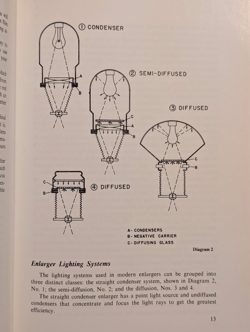

Here's the next portion of things from that article.
The condenser enlarger represents the opposite extreme. Where there is little silver in the negative, as in the shadow areas, light rays from the condensers travel in a straight line directly to the enlarger lens. In the middle tones, only those rays which pass directly between grains can travel to the lens undeflected; any light scattered by the image never reaches the lens. In the highlights, there is more silver, more scattering, and an even larger proportion of light fails to reach the lens.
Summing up, light from the shadows reaches the light in toto; some of the light from the middle tones is lost by scattering; and still more light is scattered and lost from the highlights. Thus, the projected image definitely has a higher contrast than the negative itself.
In a diffusion enlarger, the scattering still takes place in the negative, but there is also some random scattering in the diffuser. This does not change the situation in the middle tones and highlights, where scattering still takes place as before; it does, however, result in some loss of light due to scattering in the shadows, where little silver image is present. There is still more loss in the highlights and the middle tones than in the shadows, so the projected image will have some increase in contrast, but the increase will not be as great as with the condenser enlarger.
So it's basically a zone of confusion around the each grain, and the more collimated the light is, the more contrasty the print seems to be...but one could also say that the more distance there is between the lens and the print, the larger that confusion zone becomes. This is why that certain look I mentioned earlier is important, and why it happens in small enlargements: they don't have the insane level of detail and tonal separation that you find in a contact print, but they also exactly look like typical enlargements. They are deep, dense, and - when shot on a diffusion enlarger - ethereal.

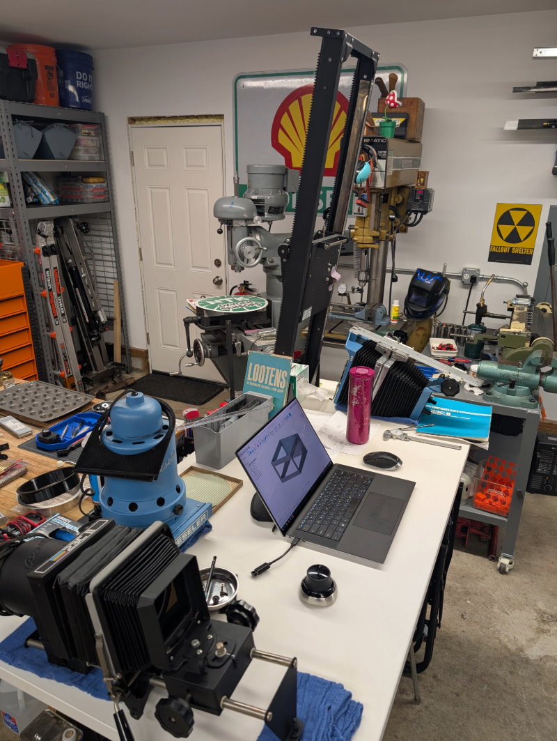

Pictured: Saturday in the operating theatre.
It all seems so simple, from a distance: you just take the chassis from Enlarger A and graft the head from Enlarger B onto it, using thermoplastic and large amounts of caffeine. What could possibly go wrong?
