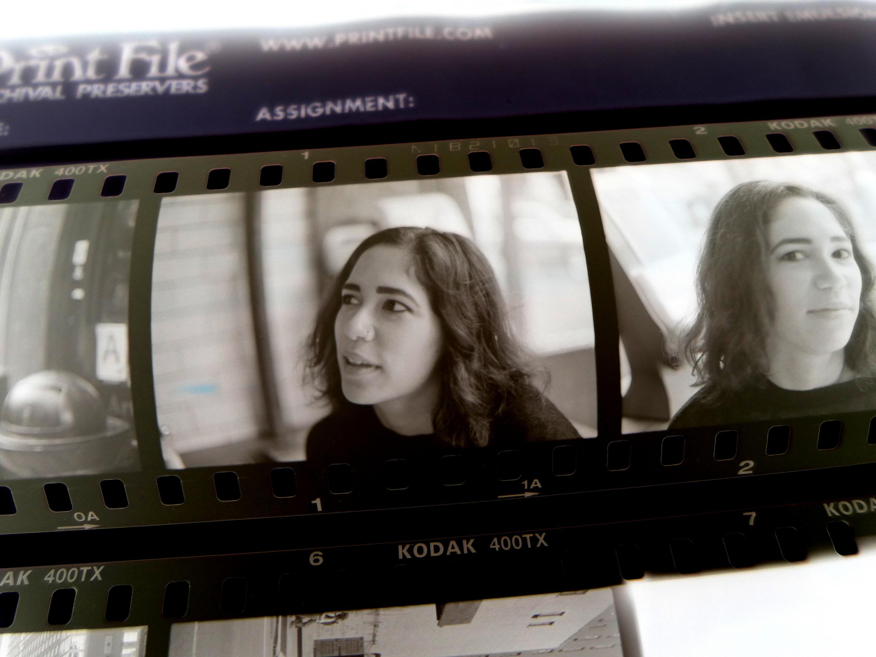

I've noticed that my Minolta XD11 and my Yashica FX-D runs the film through the gate in a way that when you cut the negatives, it frame is between sprocket holes...
This makes sleeving such a pain and looks sloppy...
Really not a big deal, but frustrating at 5AM when you're cutting negs to put into sleeves

Example- you see how the left edge barely lines up with the sprocket hole?

Use nail clippers to round the corners at the end of each strip - wherever they may end up.
EDIT: best to do this on a towel or sheet of paper, unless you want little bits of film everywhere.

Leicas normally have the space between sprockets between the frames, but the person who reassembled my Leicaflex SL put something back wrong and now it doesn't, so I end up slicing the sprocket hole.
no biggie, camera works fine otherwise. Either way, it is vastly easier to sleeve negs if you snip the point off the corner -- even a teeeeny tiny bit just to take the very tip point off, is enough.

Thanks- now it's just getting over the fact that the edges look ragged...
I mauled my neg sleeves this morning (curl and sharp corners was not a fun combo)

I always thought that the frames lining up to allow a solid piece of film (instead of a hole) between each one was part of the 135 camera specification? It must depend on the angular relationship between the shaft with the sprocket teeth and the edge of the frame mask I suppose.

You check the distance between the drive sprocket and the film gate

I agree that it never occurred to me that the frames and sprocket holes should line up. Then I picked up an EOS 3 with automatic film advance and every frame was perfectly aligned.
It is a nice feature and almost makes up for the fact that you will never get more than exactly 36 exposures out of a roll as it automatically rewinds the second you take your 36th shot. The cheapskate in me always wants to squeeze another couple of frames out of a roll.

Where the spacing lines end up is a matter of how you load the camera, nothing odd about it, the camera isn't doing anything to mess with you.
I cut the corners off at 45 degrees with the scissor. This sounds better.

Yes, when you have 10 rolls to put in the sleeve/pages these little things act like prongs and grab the edges of the page. A real pain compared to a clean cut film edge which slides in nicely.

Such malalignment between frame and perforation is a major problem with certain slide mounts.

I've found that it takes just the tiniest bit nipped off the corner to make them slide in easily.
Exactly, which is why the nail clippers are good. I think that pbromaghin's post indicates he likes the idea of using clippers instead.
Not to mention that it is just about impossible to accidentally cut a big chunk out of a negative with nail clippers.:whistling:

You are correct about my poorly phrased thoughts, sir. The slight curve of a clipper should be much better than a simple angled cut.
