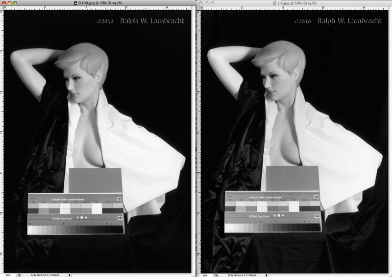

Try it by all means. Actually, I remember Kodak showing a sequence of up to 12 stops without any quality loss. I tried to behave myself with saying 8 stops. I don't have an 8-stop example around at the moment, but I attached a 6-stop example. If you look close, you'll see that the ASA 400 film (left) exposed at EI 6 (right) gives more shadow detail and shows no degradation in the highlights. Overexposure is no problem, but you may notice a slight increase in grain with 35mm film.

...I attached a 6-stop example. If you look close, you'll see that the ASA 400 film (left) exposed at EI 6 (right) gives more shadow detail and shows no degradation in the highlights. Overexposure is no problem, but you may notice a slight increase in grain with 35mm film.
Ralph, No offense but I disagree there is "no" degradation of the highlights. Even on this monitor I can see some highlight compression. Not bad but I wouldn't make a habit of overexposing.
Trust me, there is no highlight compression in the actual prints. Anyway, the improvement in the shadows is significant. Even in these scans, the degration of the highlights is minor. The point was not to make a habit of it, the point was the latitude towards overexposure.

We are talking about exposure latitude towards overexposure. The example I posted was overexposed by 6 stops, true overexposure. The example I saw at Kodak was overexposed by 12 stops, true overexposure. Eventually the highlights will roll off and ruin highlight separation, which happens sooner with some films than others, but 6-12 stops true overexposure latitude is normal.
It's been a quarter century since I've shot and processed B&W for the shear joy of making fine prints. Overexposure and underdevelopment were part of my process along with selenium toning the film to extend highlight details more linearly than with development alone. Shadow details were excellent and highlights were open and very textured. I also selenium toned the prints which had a similar effect... darkening shadows without blocking them. I'm not against overexposure... just the sacrifice of highlight detail... unless those aren't present to begin with. :smile:
Film was Agfapan 25 and 100 processed in Rodinal 1:50 (usually). Paper was Ilford Gallery DW fiber (grade 2 or 3 with the latter prefered) developed on Phenidol?... whatever Ilford's phenidone-base developer was called... and selenium toned for density and color.
And I still say I can see a little highlight compression in those examples. :D
