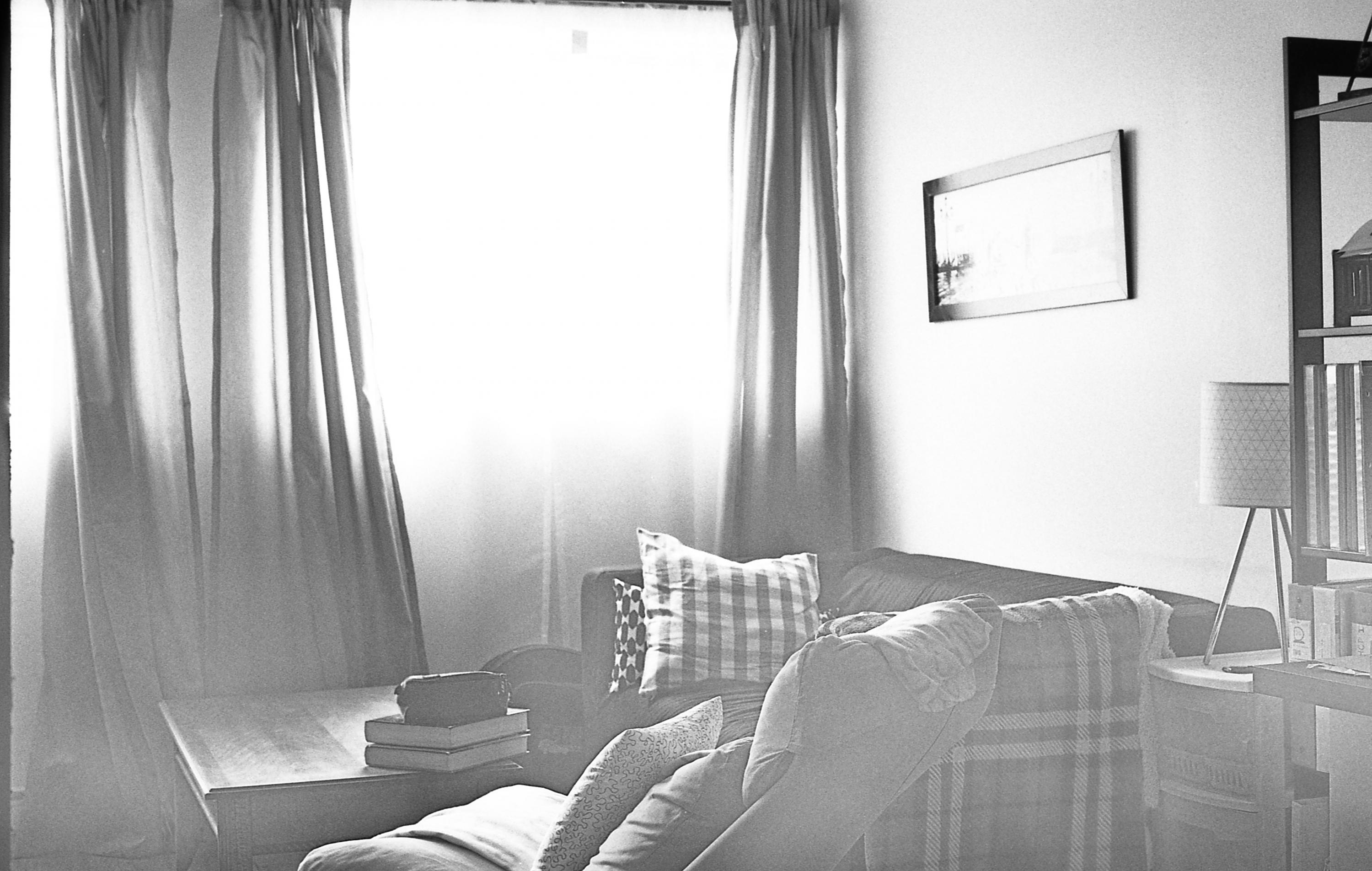

Hey guys,
I've been reading on this forum for more than a year, but this is my first post. I hope my question is not stupid.
I recently bought 100ft of FP4+ to load my own, to save a bit of cash, and I'm developing it with Rodinal, using Fomacitro stop bath and Fotospeed FX20 fixer.
Today I tought I'd do a test. I shot the same shot 12 times at different exposure time, using a tripod and cable release, at ISO 133, closest to 125 on my Pentax K1000 with the SMC-M 50mm F2.0 at f/8.
The longest exposure was 16 seconds, it should be +7 stops since my "correct" exposure was about 1/8. The shortest exposure was 1/125.
It showed me the effect of over and underexposure.
But I also had a problem somewhere in the developing sequence. It happened before. Some of the negatives are kind of foggy, not clear.
The roll was developed 6m30s in rodinal 1+25 at 22°C, which equals to 8min in 1+25 at 20°C. I followed Ilford agitation sequence, 10s every minute.
30s stop bath, continuous agitation.
4min fixing, slow continuous agitation
Ilford rinse sequence, fill, 10 inversion, fill 20 inversion, fill, 40 inversion.
Rinse with 2 drops wetting agent.

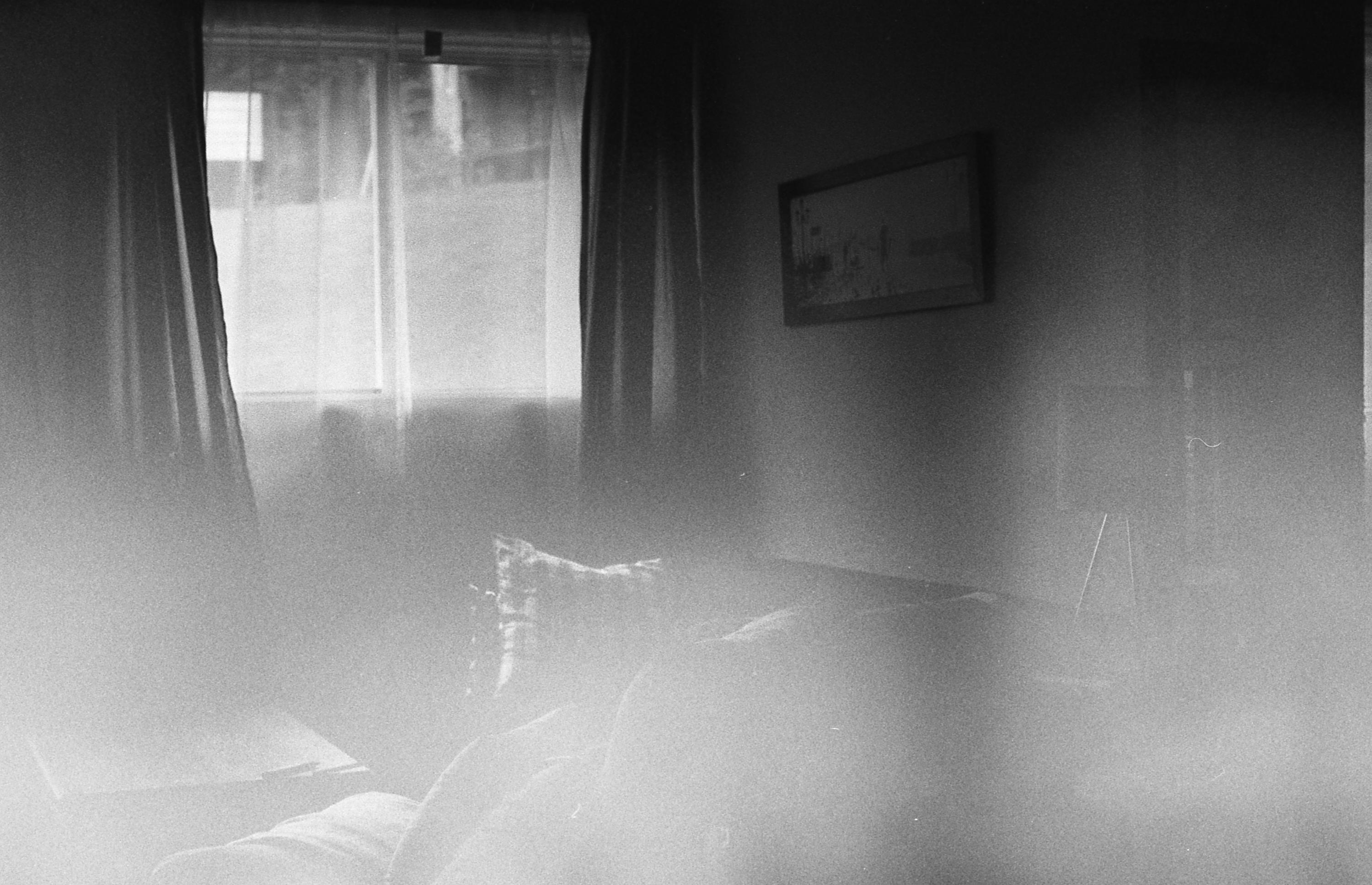

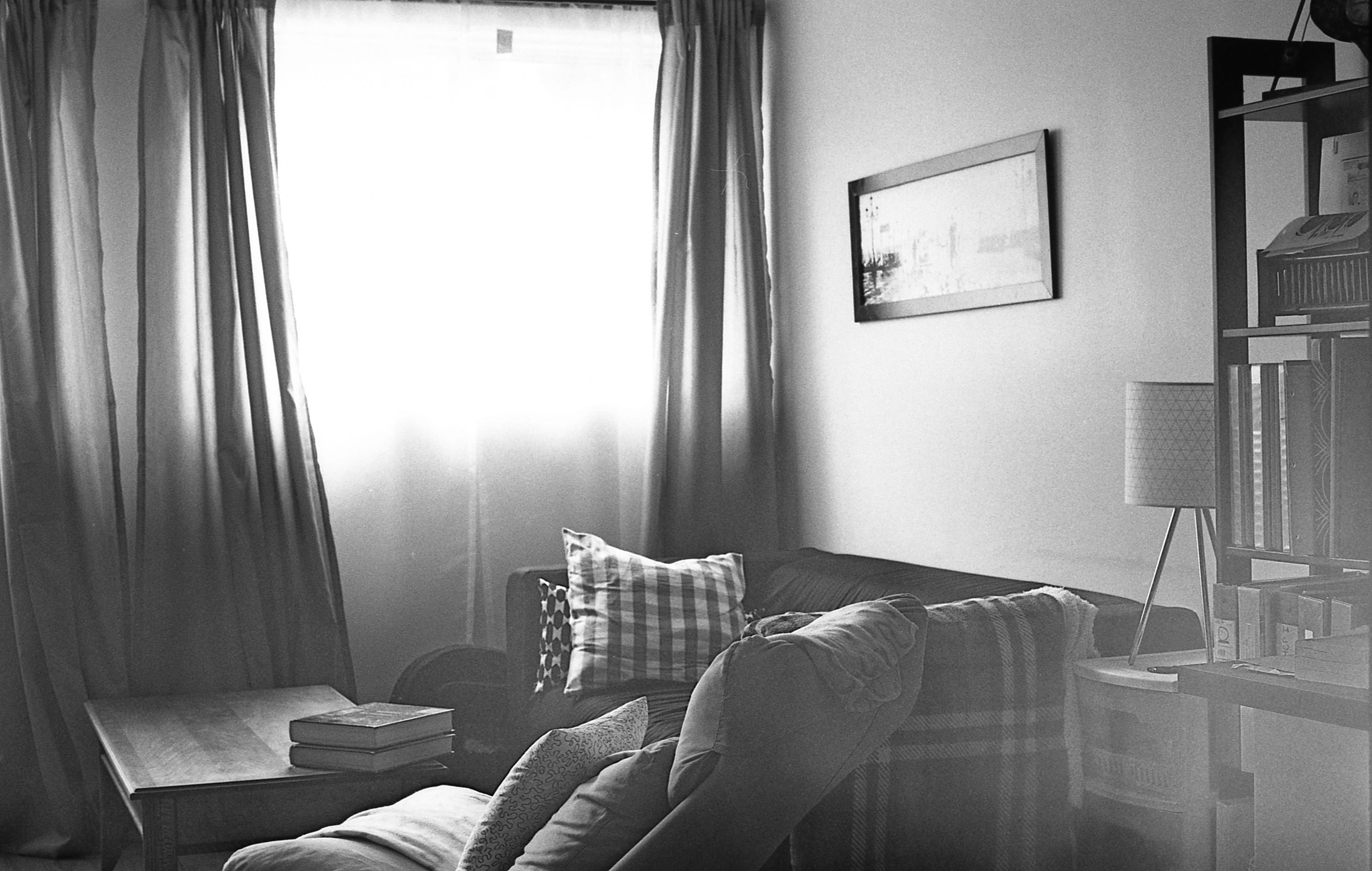

I understand the underexposed shots are white and foggy from the lack of exposure.
But what happened to the 2s, 1s and 1/2s. DO any of you have a clue why some portions are opaque?
It is my most common problem.
Any help is appreciated. I hope someone else can also learn something from this small experiment.

Welcome to APUG.
White and milky negatives = unfixed or incompletely fixed negatives.
What fixer are you using, at what dilution, and how much use have you made of it?

+1 incomplete fixing.
Your test is not lost. Just re-fix, with agitation, for twice the original time. And re-wash. You will notice that FP4 (as any negative film) tolerates a lot more over-exposure than under-exposure. Keep an eye for tonality and separation in shadows and highlights.
Congrats for doing your own testing; you will learn a lot more than reading second- or third-hand information on forums.

Underfixing redo
fixing may be done on time but fixing time is dependent on temperature just like development and exhaustion. You need to overfix.
If you use an acid stop or acid fix after a few minutes in fix you can open the tank in daylight time how long it takes from the film being milky to clear and fix for the same amount of time again.

I have the impression that nowadays 99% of the "What is wrong with my developer?" and "What is wrong with my film?" threads turn out to be "How did I mess up the fixing stage?" threads and this was also very likely the problem here.
So, I agree the crucial questions are: What dilution was your fixer, how old and how cold? (Agitation was sufficient according to your description)
Good practice for film fixing:
Measure the time it takes the fixer to clear the film leader, double that time. This is your fixing time. Normally fresh rapid fixer in 1+4 dilution will take ~ 2-3 minutes to fix traditional b&w film, 4-5 minutes for Tmax type films.
It has been discussed before that the times given on the FX20 package ("2 min. in 1+9 dilution") are over optimistic:

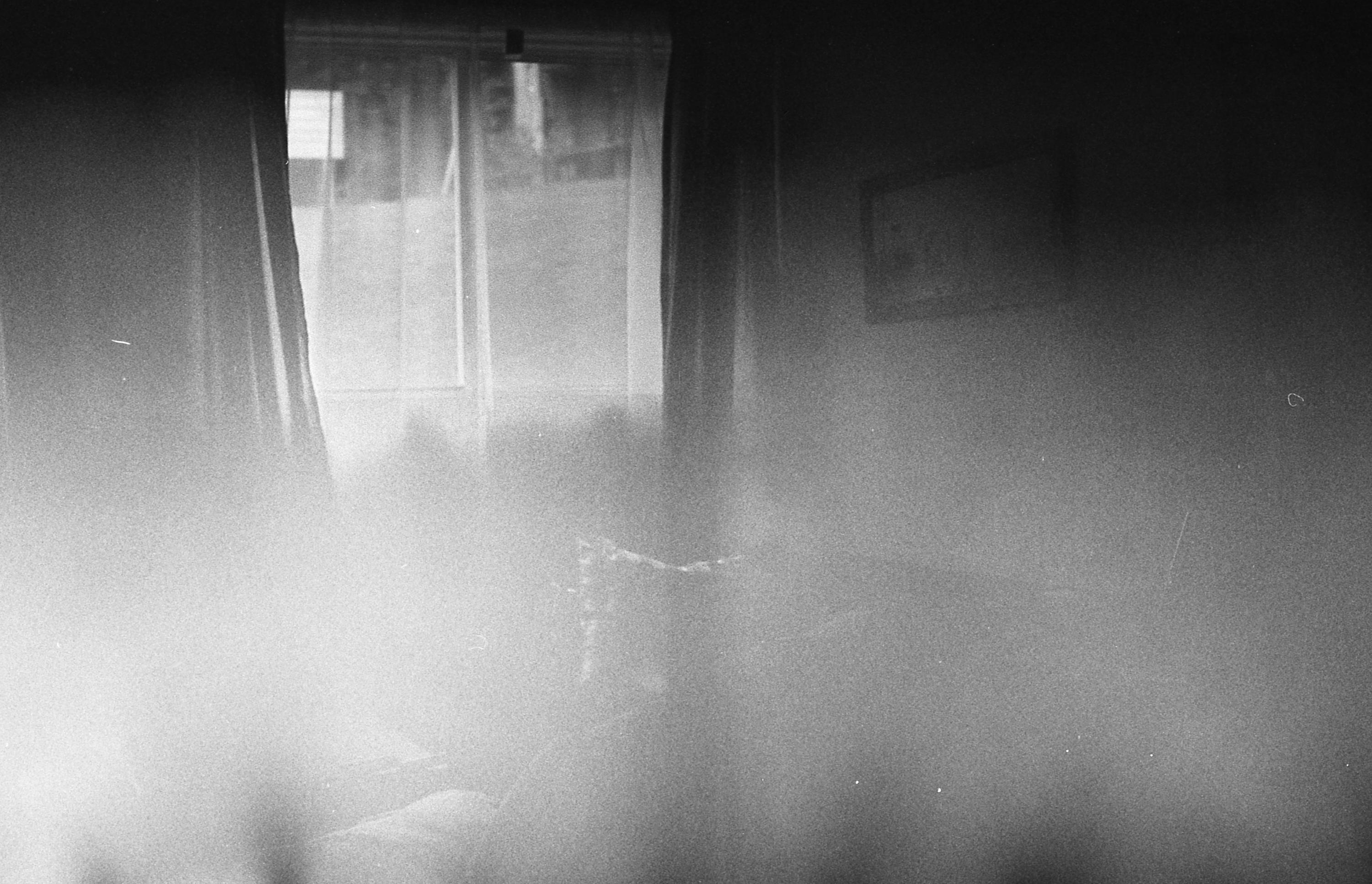

My fixer is some Fotospeed FX mixed 1+9. The total volume is 350ml. It was at room temperature, 23°C. It was used to fix 2 36 frames rolls previously. I fixed for 4 minutes.
I just did a clearing test. I dropped the leader from the same roll in the same fixer, it took 5 minutes without agitation.
It seems that the fixing time specified from Fotospeed is a bit optimistic for the 1+9 dilution. I think I will use the 1+4 dilution, do the clearing test and then double that.
Does over fixing can harm the negative, will 10 minutes do any damage?

You don't specify if you use FX-20 or FX-30, so I'll assume it's FX-20. manufacturer specs 2 minutes fix time at 1:9 dilution, and 1 minute at 1:4. Did you only mix 350ml, not an entire liter of fixer? If so, that would explain why it is already spent after two 36 exposure rolls. Mix a fresh one liter batch, then refix.

You need to fix twice the clear time at least.
Fixing x4 time the clear time won't cause any detectable difference.
x3 is recommended for the tabular grain films -like deltas by some.

I'll try that. I guess in the future I'll take the habit to clear the leader to know the time needed to clear. If I mix a 1 liter batch at 1+9, what is the shelf life of this solution?

If you do clip tests, when the clear time becomes twice the original time (when it was first mixed), replace it. Keep it is a full tightly capped bottle between uses.

Most fixers have a decent shelf life when mixed to working strength.
And all fixers require agitation.
You can perform the clip test while you are fixing the film. When the clip has cleared, you just multiply the time by 2 or 3 to get your full time.

I see the fog referred to. Some frames seem to look OK to me and others have this foggy look. Given that all frames were on the same film and that same film was fixed in the same fixer I wonder why only some frames exhibit the foggy look?
Fixer may be the problem and all the advice given is good in terms of fixing and fixer but why are only some frames foggy?

It's typical for underfixing that some areas are more affected than others.

Which areas and why? The fixer washes over the whole film and cannot, can it , distinguish between different areas?
The area showing the fog in some frames does not show it on the same area in other frames so is the fogginess there but simply disguised in some frames and if it is "masked/ disguised" then what is causing that?

Areas of the film that have low amounts of exposed and developed silver halides require more fixing activity and tend to exhaust the fixer more.
And inadequate agitation...
