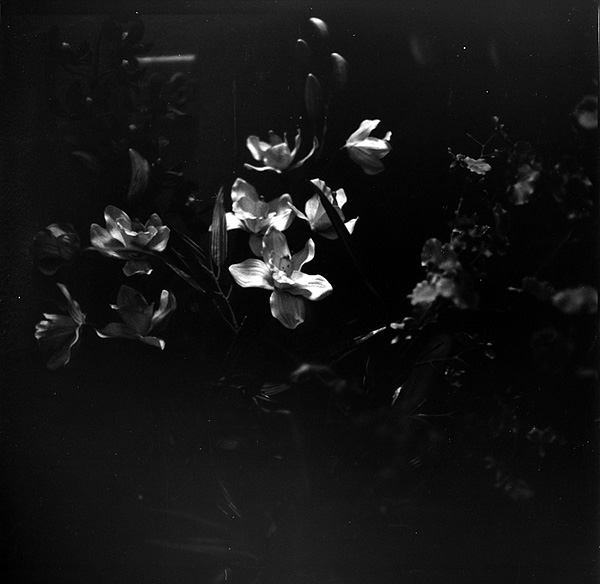

Domin's right on the money. Here's another center-weighted shot of some flower-thingies lit by an incandescent bulb above. Again, FP4 Plus at 800. Problems. Some kind of haze at the bottom of the neg too.

I don't know what those numbers mean as far as density. Assuming this is measuring a non-inverted neg, they must be digital (0-255) values as opposed to negative densities.
If this is the case, flip those values: 235 in the highlights and 76 in the lowlights. That sounds like a "normal" flat neg that has been automatically lightened by the scanner to me.
For instance, in a digital file, the blackest shadows should be in the 0-30 range or thereabout. Pull everything down 50 levels to make this the case, and you get 26 in the shadows and 185 in the highlights. That sounds more like what you would get with the way you exposed and developed.
In short, I don't think the scanner is measuring through the actual neg, but, rather is telling you where it will place the shadow and highlight densities upon digitization.
If you can mess with it to get numbers that are 0-point-something to 2-point-something, those will be actual negative densities for sure. I have used Silverfast to get neg. densities before, so it is there, or maybe just a different version of the software.

I'm just trying to determine actual negative exposure, since a digital picture on the Internet tells us little about that aspect of the neg.

I can't get the densitometer to give anything but a 0 to 255 scale. Humph. As far as I know the scanner/software shouldn't be lightening anything as I have autoexposure switched off. The tonal values are plumb in the center of the histogram, though.
Looks like under incandescent lighting that an extra stop of exposure or so may be needed over a straight meter reading. :smile:
Thanks everybody for helping me get a handle on this.
