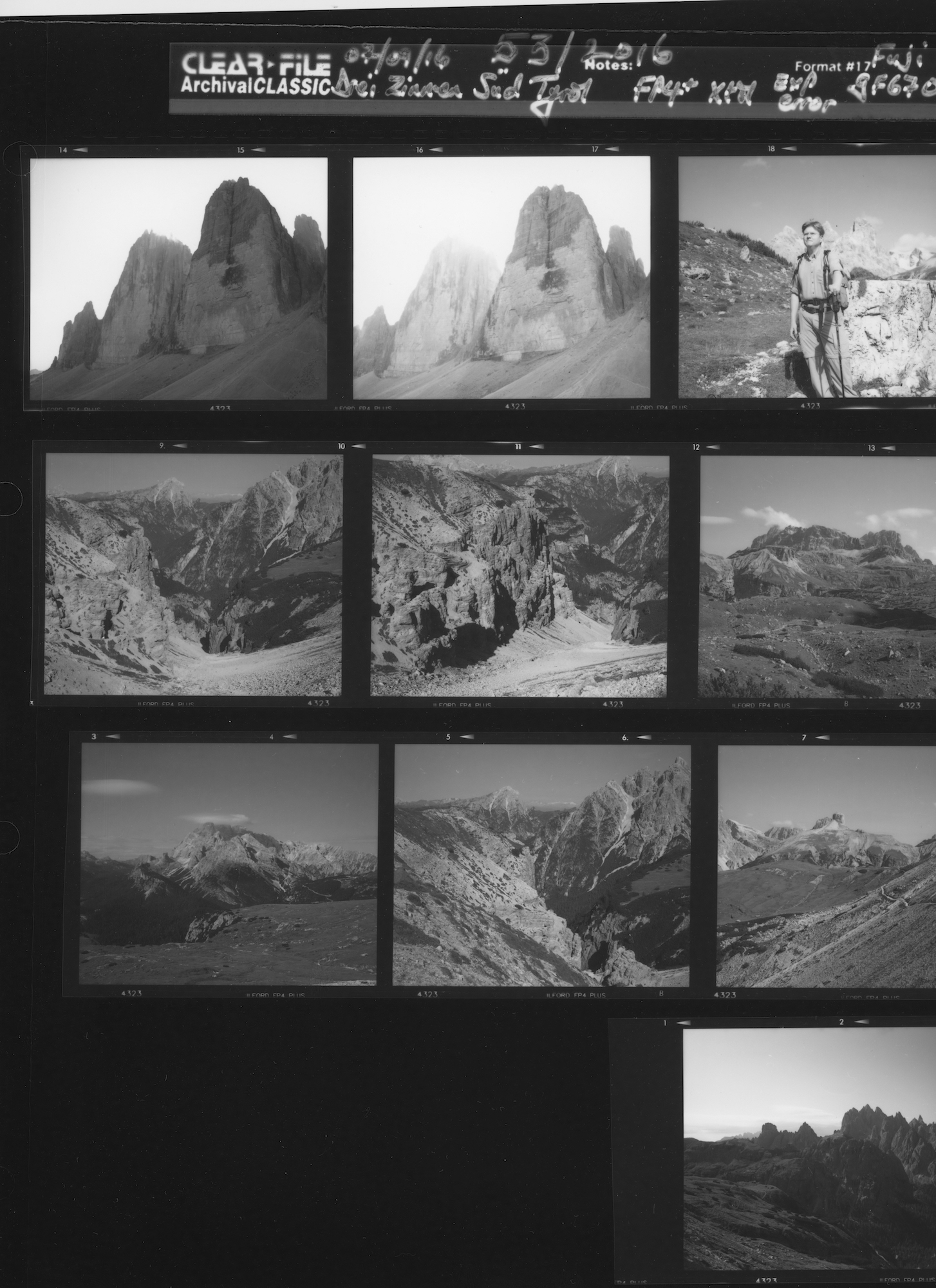

Thank for your help with this. I attach the contact sheet (sheet too big for scanner so chopped off). I developed the whole roll as EI 200 and, although I haven't printed any yet, it seems like I got away with it.
Frames 1-7 inclusive were accidentally exposed at EI 400 (by forgetting to change the dial on the camera). Frames 8-10 were exposed at EI 125. It was not the 50:50 division I thought it was. The extra density of frames 8, 9 and 10 can be seen as they printed "light" on the contact sheet as compared to the others.
In truth they are not really a very exciting bunch of shots!

Looks like a successful end to the story to me!
It looks like you got away with it but don't do it again or we will have to report you!
Some of those frames look quite good, I think. Don't be so hard on yourself. Also, let's see some prints!

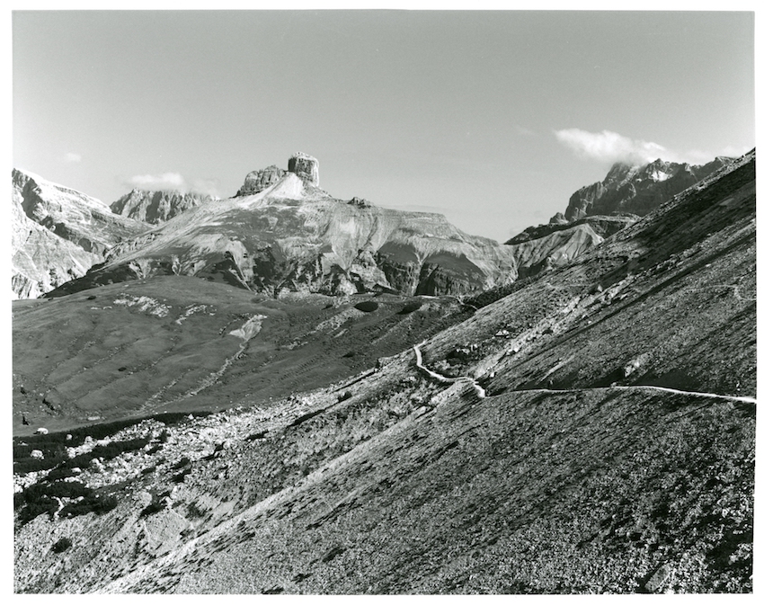

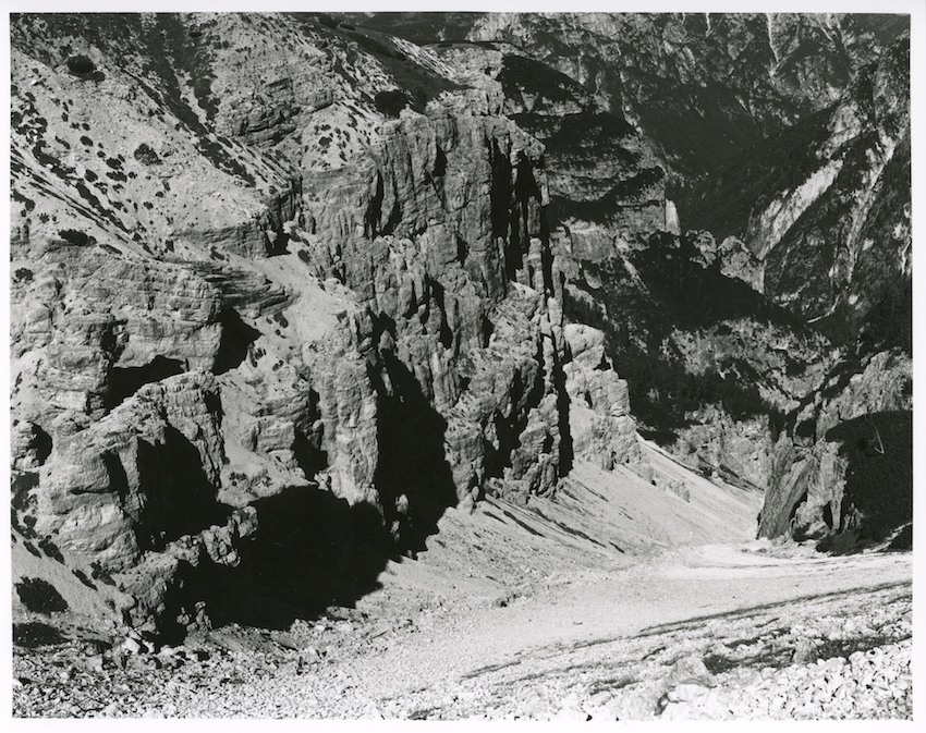

A couple of photos from this roll as requested. Both of these accidentally exposed at EI 400. There is actually detail in the shadows but this has been lost in order to print the highlights which are white limestone and very bright. These negatives were noticeably thin and needed the lens stopped down in order to print at a reasonable time (they printed too fast). The tonal range seemed a bit bunched up needing 0.5 increase in grade from my usual. These were printed at grade 2.5. In the gorge photo, on the right, the thing that looks like a "J" shaped fault is actually a tree growing at a crazy angle. I have so far printed 3 photos but the third print was unacceptably spotty from dust (on my scanner I think, I can't see it on the print).
Somehow I am underwhelmed but it is always difficult to be objective when I know I made a mistake. Low quality Jpegs.
