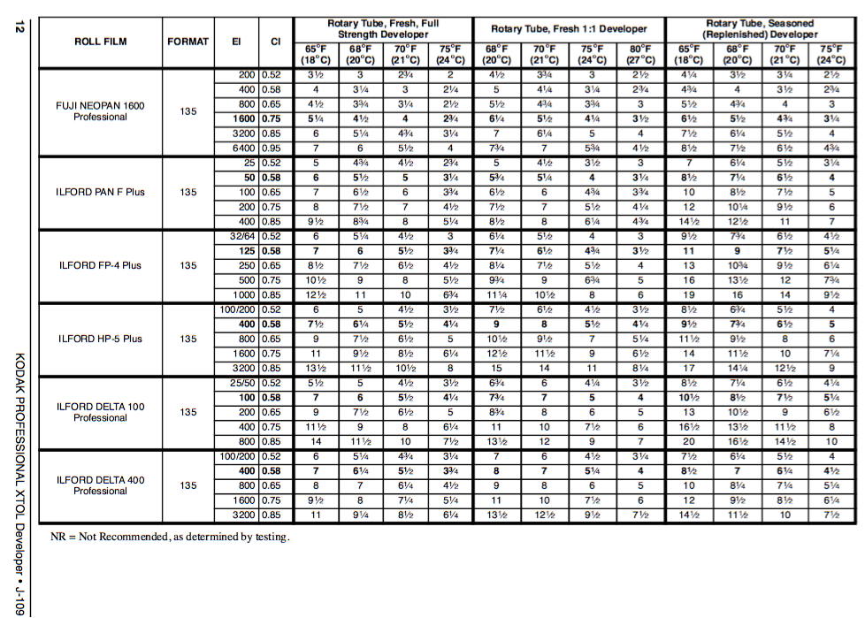

Using XTOL and replenished XTOL the times are listed below. DO NOT PREWASH FILM WHEN USING XTOL PER KODAK & JOBO
attachment.php
