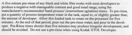

... I presoaked, used xtol, normal stop bath, and normal fixer ...
Read the last line. From page 49 of the Jobo manual:
Case closed.

Thanks Sirius, but if one uses a "pre"-rinse, does that mean one still uses a rinse? J/K...:wink:

Case re-opened
Read the last line. From page 49 of the Jobo manual:...Case closed.
Jobo saw no value in repeating Kodak's extensive Xtol testing with a presoak. Jobo published the following; scroll almost to its bottom:
http://www.jobo.com/jobo_service_analog/jq/jq9802.htm
Note that, in the final paragraph, Jobo indicated neither presoaking nor not presoaking is right or wrong with any black and white film. Both methods work well.
