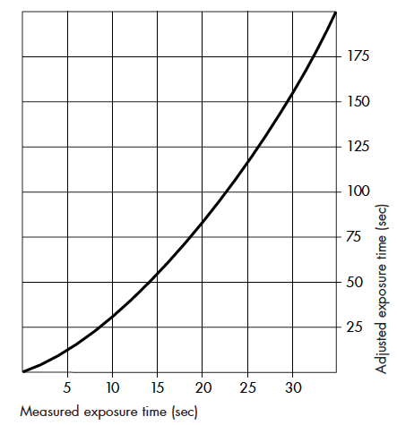

Here's a formula derived from the chart on the Ilford Data Sheet for Ortho Plus. Please note that Ilford's reciprocity data from other products has been proven to be very much out of date.
adjusted exposure time = 1.306 * metered exposure time^1.228 + metered exposure time
Here's the data sheet: http://www.ilfordphoto.com/Webfiles/2011427119221450.pdf
In the formula supplied * is multiply and ^ is raised to a power

I have been told by a reliable source from Ilford that to get the correct exposure on FP4 when under reciprocity failure conditions that you multiply the selected exposure time (in seconds) to the power of 1.49.
That contradicts the reciprocity correction curve published in the Ilford datsasheet by quite a bit.
Rel exposures for metered from 1 sec to 35 sec vary from 1 sec to 175 seconds, and it's not a straight line.
The datasheet can be downloaded from Ilford's website.

Check some of the older reciprocity threads here. Ilford's reciprocity data has long been out of sync with user experience. The charts in their literature are very much generic, as is the raising to the power of 1.49, which has been the same since the late 60's. The films have since changed. The last careful testing I've seen done (with methodology explained) was Robert Reeves in the late 90's in his book on Astrophotography.
Based on his info the following formula should be used:
adjusted exposure time = 0.5557 * metered exposure time^1.326 + metered exposure time
Ralph Lambrecht's conventional film formula suggested for FP4 yields:
adjusted exposure time = 0.3178 * metered exposure time^1.5215 + metered exposure time
Plot those out and you'll find they don't diverge significantly until after 240 seconds of metered exposure time.
If you check the older reciprocity threads, you may recognize that I'm using a modification of Pat Gainer's equation for reciprocity based on Howard Bond's very careful work with multiple films published in the 90's in PhotoTechniques. Two of my friends here on APUG requested FP4+ reciprocity info from me in the past, and the first formula I give above worked extremely well for them.
If you check Ilford's newly published (Aug. '17) reciprocity data, explained in this thread: https://www.photrio.com/forum/index.php?threads/ilford-film-reciprocity.153342/ , you'll find that the older Ilford charts were not very accurate. The newly published Ilford factor for FP4+ based on testing current emulsions matches the first formula in my post preceding this one well within 1/5 stop after metered exposure times of 8 seconds. The difference in exposure between Ilford's old and new factors is significant. Thanks to Ilford for doing the work and publishing up to date info.
