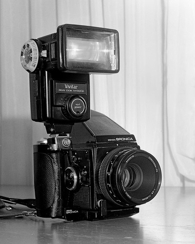

That’s great. When you wrote that your winder from the SQ didn’t fit, I assumed you meant the speed winder S accessory, the thing with a grip, thumb winder, and flash shoe, pictured below. Did you mean that, or did you mean the crank handle that attaches with a pin? If you did not mean the speed winder S, then that might be a viable option for you. It adds very little weight and makes holding the camera like a 35mm SLR. They go for about $40.
Bronica SQ-A by Howard Sandler, on Flickr
Yeah the one I had on my SQ was the crank (with pin) but the one that came with my SQ-Ai was the motorized winder. I really dig the shoe (means I can put my flash transmitter on it so I don't need a cable) but dang is it heavy! I thought I was buying one with a manual grip (is that what the above is?). Do you know how much a manual is versus the auto in terms of weight? SQ by itself is heavy but dang was it heavy with the motorized one!

I dont have a sensitive scale, but the manual speed winder feels like about 350g. The manual one s what you see in the photo. No batteries; you wind with two strokes of your thumb.
