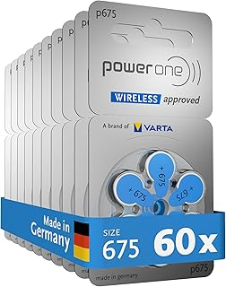

I have both, the T3 has a few additional features, as the first generation AR mount body T is a bit more basic. The T3, many came with a split image screen and mirror lock up. Both flash sync at 1/125th. I recall if there were any differences in the built in meter. My T3 has a built in hot shoe while the Ts I have a add on shoe, not a hot shoe. Other than using hearing aid batteries you might find a repair tech who can adjust the meter for a modern battery. I just use hearing aid batteries, they 625 fit without an adaptor. The Konica branded lens are some of best glass I have ever used.

Did you mean hearing aid 675 batteries? And with those batteries the meter would work (eg not break)?
Yep hearing aid batteries, that all I use in my Konicas. I have an adaptor for my Minolta 101 and 202, but the 625 hearing aid battery fits the Konica just fine. My Konica meters match my Gossan SCB meter within a 1/2 stop.
@Paul Howell - those are the smaller 675 batteries.
They work with either:
a) an o-ring or something else that keeps them centred in the larger 625 battery compartment, or
b) one of those purpose made adapters that does the same thing.
The adapters - or some very carefully cut and positioned aluminum foil - ensure that you can use the small number of cameras that rely on making electrical contact with the edges of the battery - most only require that the two faces of the battery are contacted.
If you haven't done anything to make sure the 675 battery stays where it should be in the middle of the battery compartment, it may be that you have not had problems with your Konica cameras because the "spring" tension on the connectors is strong enough to hold the battery stationery. That isn't the case with every camera.

In my early post I stated 625, the correct battery is 675, my mistake. The Konica T cameras used 675 no adaptor ring is needed. I do use an adaptor when I use 675 batteries in my Minolta 101 and 102, Petri. Topcon Uni 100 also takes 675.

I'm surprised at this Paul.
My recollection is fuzzy about when the cameras were current, but I think I remember that the Autoreflex line took the then most common larger PX-13/625 batteries and the information I can find now says the same.
Is their any chance that your cameras have been modified?
I've recently acquired a near-mint Konica Autoreflex T2 and have spent the last week burrowed deep in Konica rabbitholes learning the system and sorting out some maintenance/CLA for my new-to-me camera. But I have learned enough to help clarify this: the Autoreflex T, T2, T3, T3N take the PX675. The Auto-Reflex, Autoreflex TC, and Autoreflex T4 use the PX625 type. So you're both correct!
