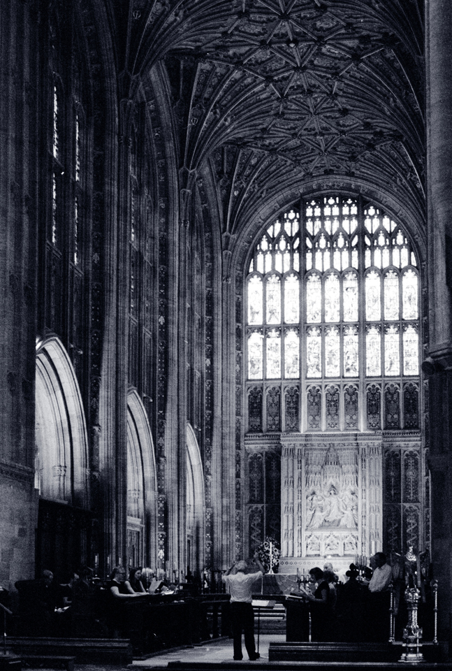

For reference, this is the image and the look I want to achieve. Please note this was scanned directly from the B&W negative and digitally given the cool blue tint. I want to replicate this look in the darkroom.

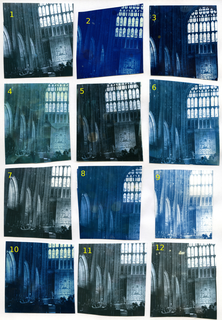

More as a point of interest, here are some of the small test prints I made while experimenting with the toner (I cut up a few sheets of 10x8" paper into small squares). After I made the tests prints, these were left lying around in the darkroom for a couple of days and some got splashed with various stuff, hence the stains.
  • I really wanted just a cool tone that barely looked blue - number 12 seems closest to this but even then that has a patch in the middle that is not properly toned, and the shadows are not strong enough.
  • Number 5 has nice shadows but is too blue.
  • Number 3 is an interesting effect and one I might use again.
  • Number 9 is also an interesting effect, which definitely gives the impression of light
We all see things differently but no. 7 seems quite close to what you had posted originally and at least with 7 the toning is even.

True, on the scans number 7 does seem quite close. In reality, it isn't the look I wanted. I guess that's the peril of scanning and digital reproduction.
