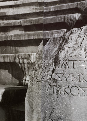

I did a crude test last night with some Ilford Warmtone FB and the difference in colour was quite distinct.
The left side was developed in the PQ version of ID-20 (Forte FD-203 which is ID-62 with no benzotriazole), the right with the same developer with Additive-X.
However Additive-X which is Thiourea (Thiocarbamide) is problematic, the idea is attributed to S.H. Wratten (1910). The Thiourea causes fogging so the developer needs to be well restrained.
So 10ml of 1% Thiourea in 400ml working solution of developer resulted in almost instant fogging. Cutting the amount of Thiourea drastically adding 10ml of a 0.005% solution and 100ml of 1% Benzotriazole as the anti-foggant gave the results above. The colour shift was caused by the Thiourea, I tried first with no Bezotriazole) which I added to cut the slight base fog.
This initial crude test shows there's definitely some potential in adding Thiourea, but more work needs to be done.
