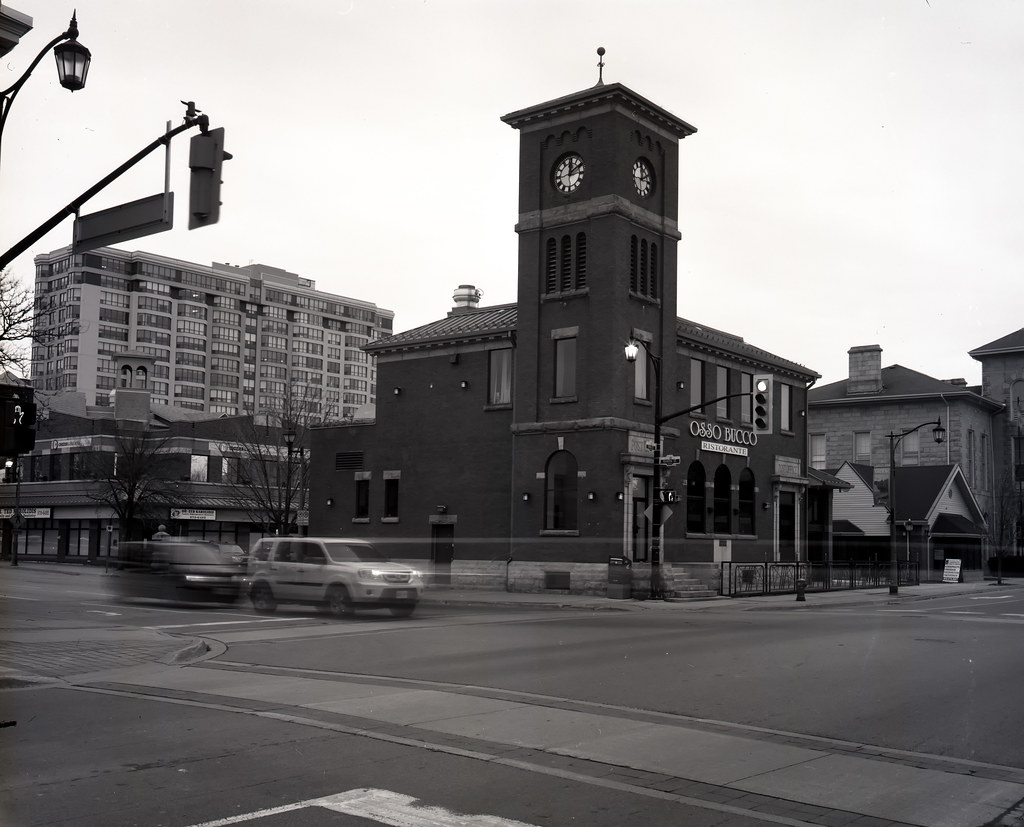

I've been using the Formulary's PMK Pyro formula for a couple years now with great results! And have used it on numerous films, 35mm, Medium and Large Formats.

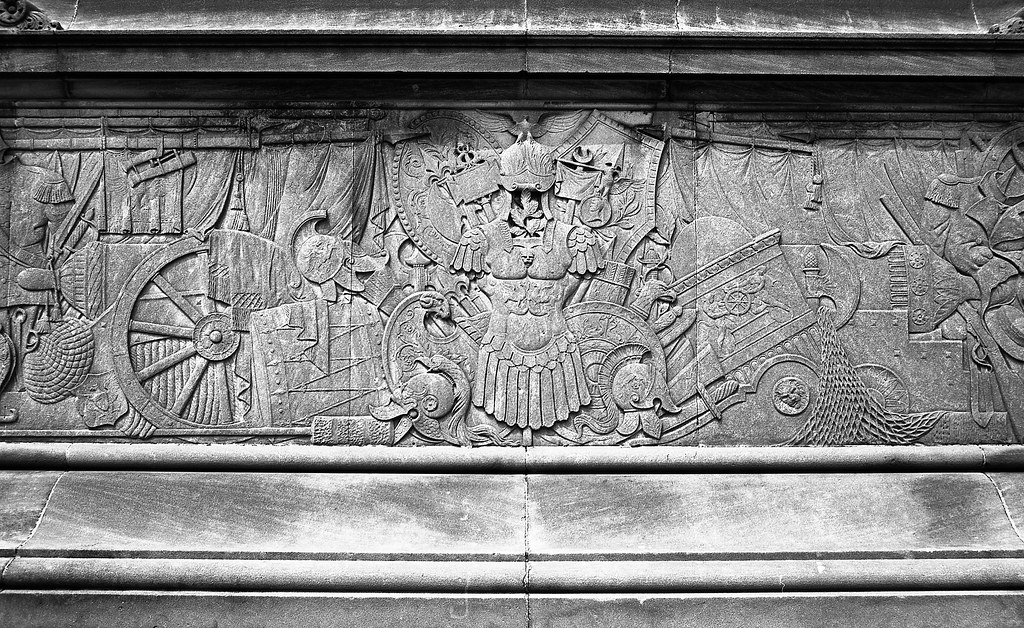

I started out using Pyrocat HD, loved it. I switched to PMK Pyro after reading that it favors atmospheric conditions (fog) better than other pyro developers. I believe it.
Arista EDU Ultra 100 in PMK Pyro

This is a great shot -- viewed large, you feel you can walk into it. Large format?
