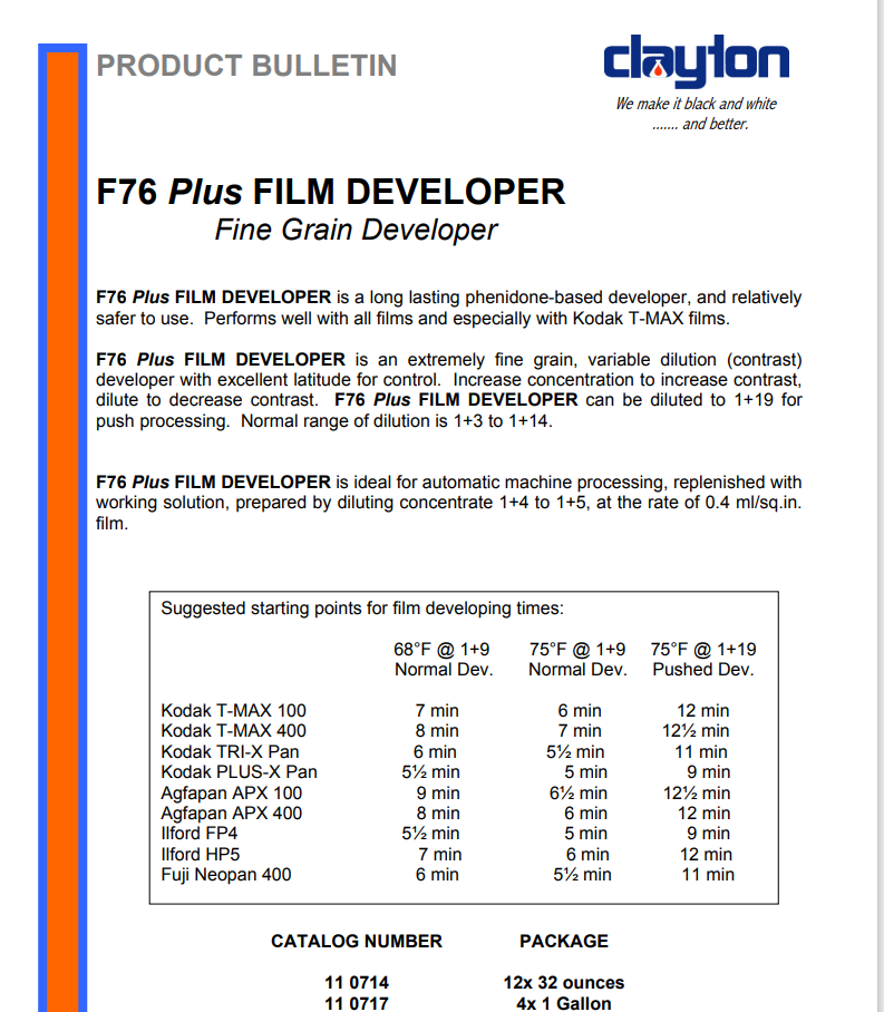

Here is the msds of F76+:

Well Clayton sells it as a phenidone based developer:
My guess is that since Phenidone is not that toxic, it is not included on MSDS?

If you read further into the SDS Phenidone is listed (along with other ingredients such as solvents, restrainers, chelating agents.
It is a PQ liquid concentrate with a relatively high pH, superficially appearing to have more in common with an HC-110 type.
Of course a list of ingredients and chemical properties does not necessarily mean it doesn’t ultimately produce similar results to D-76 - there are many ways to very similar endpoints - but strictly from a formulation perspective it’s strange to put “76” in the name.
You’re not going to be able to accurately reverse-engineer it from the SDS even if you acquire all the ingredients.
