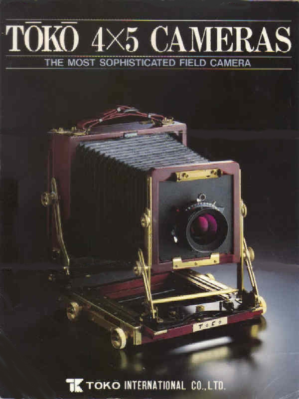

I've owned a Toko field camera similar to the one in Post #26. Pretty nice camera with triple-extension bellows. Used it with a 210/370 mm convertible Linhof Symar, but it didn't have enough bellows draw for the latter focal length. I think 300 mm would have worked, but close focus would be limited by bellows draw. I don't recall if it was Graflock compatible. In some ways I might have preferred a camera with fewer movements, because the only one I used frequently was front rise, and occasionally, front/rear tilt (which can be combined to get even more rise). I never once used the f/r swings, yet every time I set the camera up I had to deal with them, so that feature just meant more hassle for me.

I don't know which Toko model you had, but both of mine have 360mm of extension, and I use my Fujinon C 300mm f8.5 without any problem -- and I do a lot of close-ups often with plenty of front camera movements. I also use a Fujinon T 400mm and T 600mm on them.

I've heard from lots of people over the years who are still looking for "THEIR" perfect large format camera. Maybe because I did my research first, I bought a rosewood Toko Nikki-II. It has been perfect for me -- lightweight, very flexible (front AND rear), 360mm of bellows, and inexpensive. I liked is so much, I bought another a few years later -- in cherrywood, so I can tell them apart.

I like what I've seen of Toko cameras, but they aren't as common as to be able to find one when I'm ready to buy...
