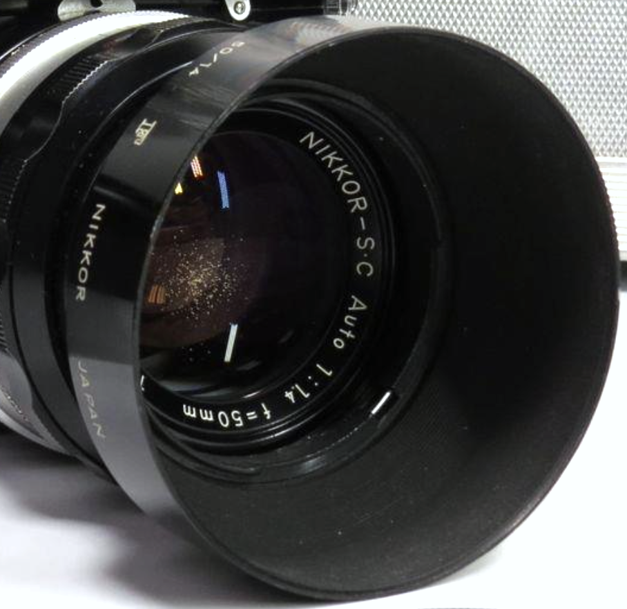

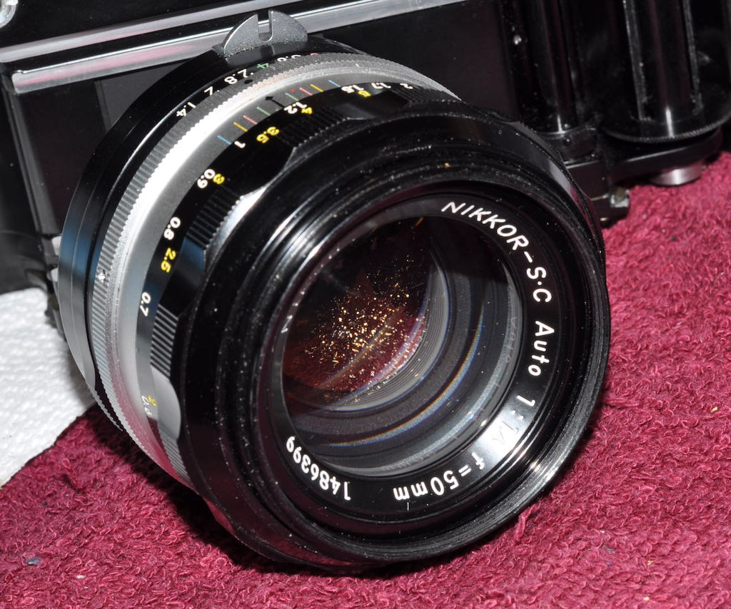

Top is the picture from the For Sale ad and bottom is my picture before the repair.

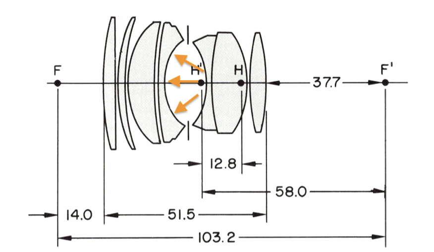

Extra points to guess at the location of the problem:

Someone sneezed a mouthful of cheeto dust on the very front element, and a rocket blower took care of business in 10 seconds flat :D
Warm, but not on the front element.
I'd say it`s between the third and forth element - counting from the front element.
Cement degradation between 5th and 6th?

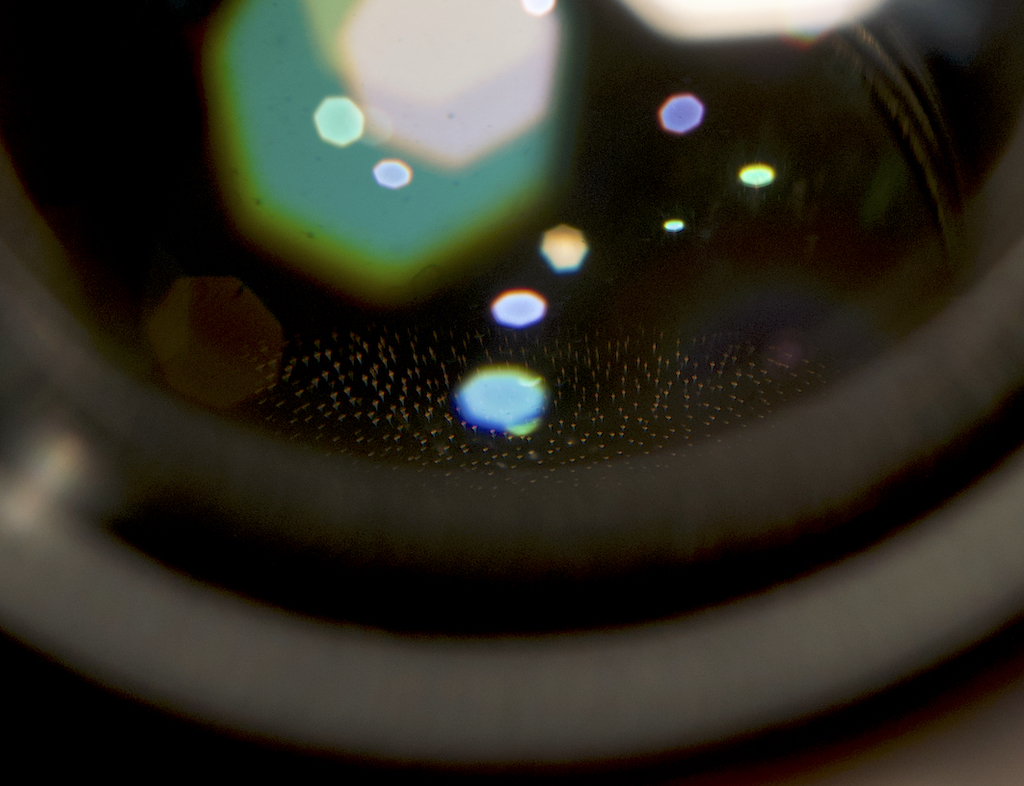

It rather looks like dust - it could be metal dust, it looks like brass...
I thought about that too. Someone drill into it?

As my bet is between the third and fourth element it cannot be from the aperture blades - therefore i bet on the thread of the focusing ring.
So far:
It is yellow dust, but not from Cheetos.
It did blow off with a puff of air.
Not glass or metal chips.

Some sort of pollen?
Anthrenus?
Answer: Desiccated eggs and decaying exoskeletons of Anthrenus verbasci larvae -- woolly bears; carpet beetles
