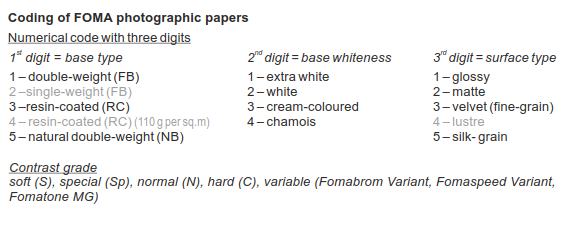

According to my Foma paper sample book first digit
1 Dbl. Wt Baryta Coated
2 Sgl. Wt. Baryta Coated
3 RC
4 RC 110 g/ sq.m
5 Natural
The data sheet refers to it as natural carton stock. Would this indicate no baryta coating???
Second digit of 3 indicates cream colored stock.
The last digit of 6 doesn't show up on my chart??
1 glossy, 2 matt, 3 velvet, 4 lustre, 5 pyramid grain. 6???
I've got so much paper, I think I will pass on this. I want to try their Fomatone Classic 132.

Foma Paper codes from their current catalogue:
as the list goes, 3rd digit "6" may suggest "sisal-grain":whistling:
