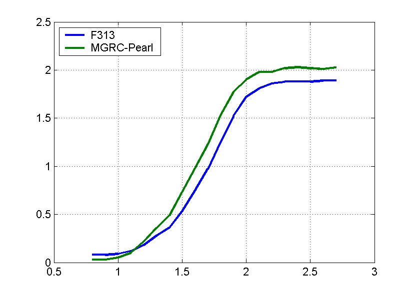

I've been testing some Fomaspeed 313 ("velvet", similar to Ilfospeed 44 "pearl"). Exposing Stouffer wedges. Testing in parallel with Ilfospeed MGRC 44 Deluxe and Fomabrom Variant 111. Ilford grade filter 2.5. Developed in fresh D-72 1+2 2mins @ 22°C. Safelight has passed the Kodak test with Fomabrom Variant up to 7min exposure.
Visually, Fomaspeed 313 does not equal Ilfospeed in three respects:
  • lower dmax (confirmed by densitometer)
  • white not quite clean (slight fog)
  • black is not neutral, warmer
My question
Did anyone perform similar A/B testing of Fomaspeed? Is Fomaspeed inherently flawed? or did I happen to be provided with outdated paper?
I'm a bit surprised, since (like several other Photrio members) I find Fomabrom Varian 111 quite good.

Thank you for your input. I went back to earlier measurements from last year and dug out H/D curves of Fomaspeed versus Ilfosped "deluxe". They are consistent with the visual impression. The Dmin for Fomaspeed 313, left of the toe, fluctuates 0.08-0.09. Consistent with your 0.085, given the age of my densitometer... MGRC-Pearl I measured at 0.03. Dmax for Fomaspeed I measure at 1.89; Foma datasheet says 2.1 hmmm.

I'm surprised at the lowish dmax; I would have expected higher from this paper given my own measurements. However, the reflectance of the surface and play a role. I do my measurements with an i1Pro 2, which I think does a fairly good job controlling for surface qualities of the material. It's easy to see how a meter might be thrown off especially when measuring semi-glossy and glossy surfaces (like all RC papers). Still, there's no arguing about the visual difference between one paper and another, regardless of what a meter says.
Keep in mind that developer/development may play a role particularly in dmax, although I trust you're fully aware of this. In my test I used well-aged and replenished ID62 and obtained 2.00-2.05logD on the Fomaspeed paper; I suspect I might be able to eek out a tiny bit more by optimizing development, which should bring me even closer to the specified 2.1logD.
The MGRC Pearl has the same handicap, yet measures 0.1 higher. In fact, MGRC44 is almost as good-looking as MG glossy air dried.
I won't dispute that your densitometer is more accurate than mine.
I'm not really convinced, after receiving and following advice on this forum to use Dokumol to increase contrast: improvement measurably absent. Ditto Moersch 4812: ordered, paid, tested; same H&D as D-72. Maybe glycin (so expensive) or the original Eukobrom (unobtainium) are (was) really superior.
My recent experiments, that prompted me to start this thread (no densitometer measurements yet), were made with D-72 and ID-62, and variants in which KBr is fully replaced by "equivalent" BTA. The induction time was in the range 10-15s, and the paper developed for 2min; so I believe it received full development. Any combination involving Fomaspeed 313 has a brownish tone compared with any combination involving MGRC, irrespective of more or less benzotriazole in the developer. Agrees with your observation of a "purple/magenta" tone. This alone eliminates Fomaspeed 313: I want a neutral black.
So... Maybe I was sold outdated Fomaspeed 313. Maybe that paper has slightly inferior specs right out of the factory. I'll leave it at that and play safe, staying with Fomabrom Variant for baryta and Ilford MGRC for RC.
